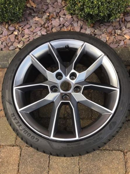

I am thinking dark interior rims and a light anthracite finish...
Or just factory standard..

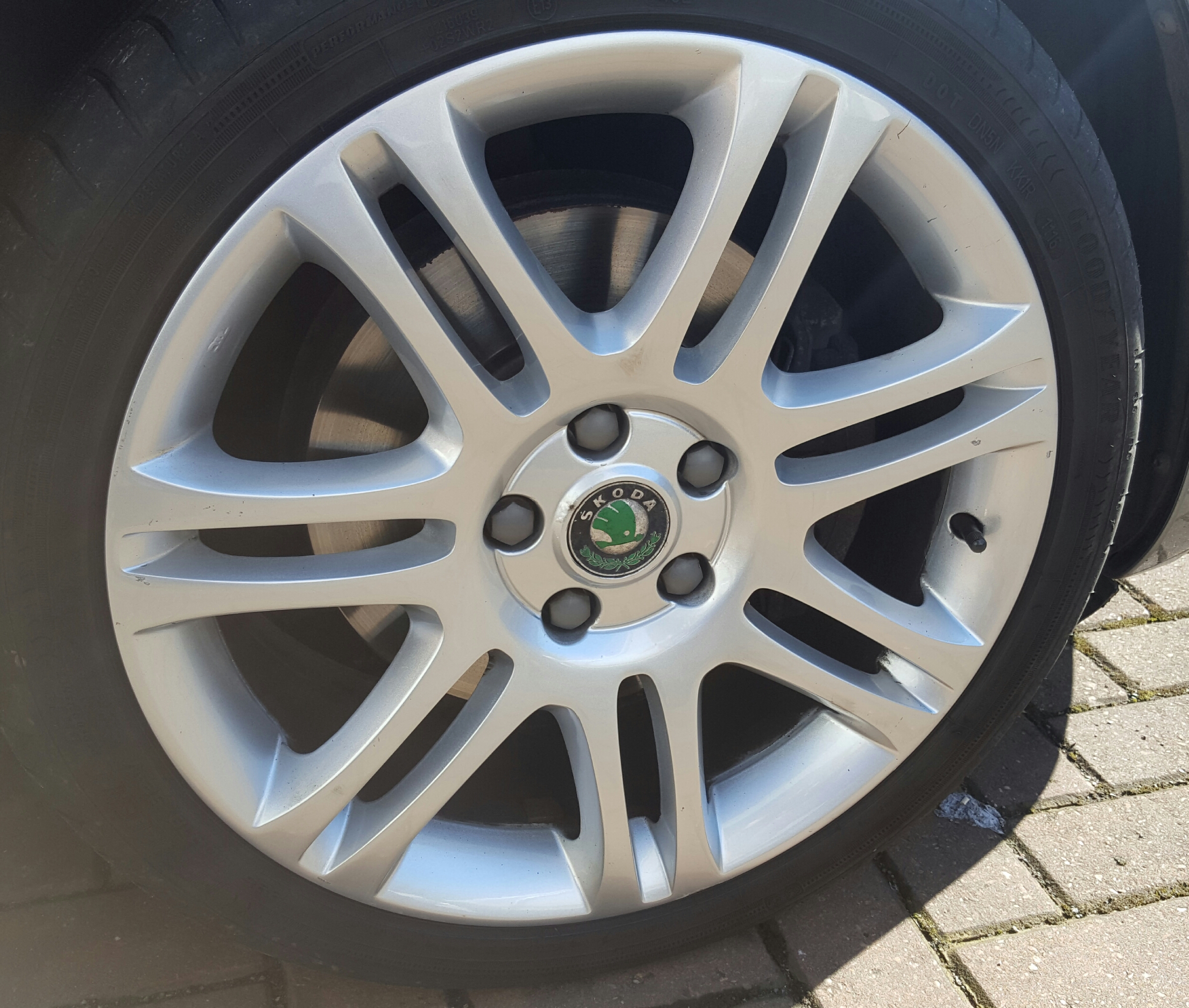

Thermisto's are indeed diamond cut, to have them diamond cut refurbished means having them machined where a small skim is taken of the face of the alloy then lacquered, it the lacquering where the problems arise as moisture gets behind the lacquer causes them to oxidise and a white powdery reaction, All the people I know that have cars with diamond cut alloys have had exactly the same problem. Added to that it's about double the price per wheel. With all this in mind I had mine painted, yes I am a bit of a cheap skate but at £60 a corner I couldn't see the logic of getting a finish that cost twice as much and would almost definitely look crap in a couple of years.
Had mine done 3 years ago and this is a picture I took this morning.
Looks great. The added bonus is when your wife kerbs your painted alloys you can sand/fill/paint over the damage. I need to bit the bullet and get mine painted.
Also had mine painted silver in a deal with the dealer before I bought the car. Also cost £60 a corner (but had the bonus that I'd not actually taken ownership of the car so any screwups were the dealer's problem to sort!) and I'm pretty happy with the result. To be brutally honest, I just didn't like the design enough to spend more on a refurb.
I'd just go the painted route, especially if you're going to leave them on all winter.

Power coating doesn't sound like the best way forward tbh and I want a to have a hard wearing surface that is also attractive in its shine so painting/spraying sounds good.
Especially since I am wanting to darken the inside rim and add an a subtle anthracite colour to the front font face similar to VRS colour show in the attached photos.
