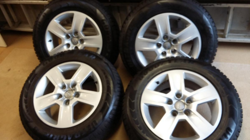

I'll have a nice set of alloys with Goodyear Ultragrips for sale soon if you fancy a third set ;)
