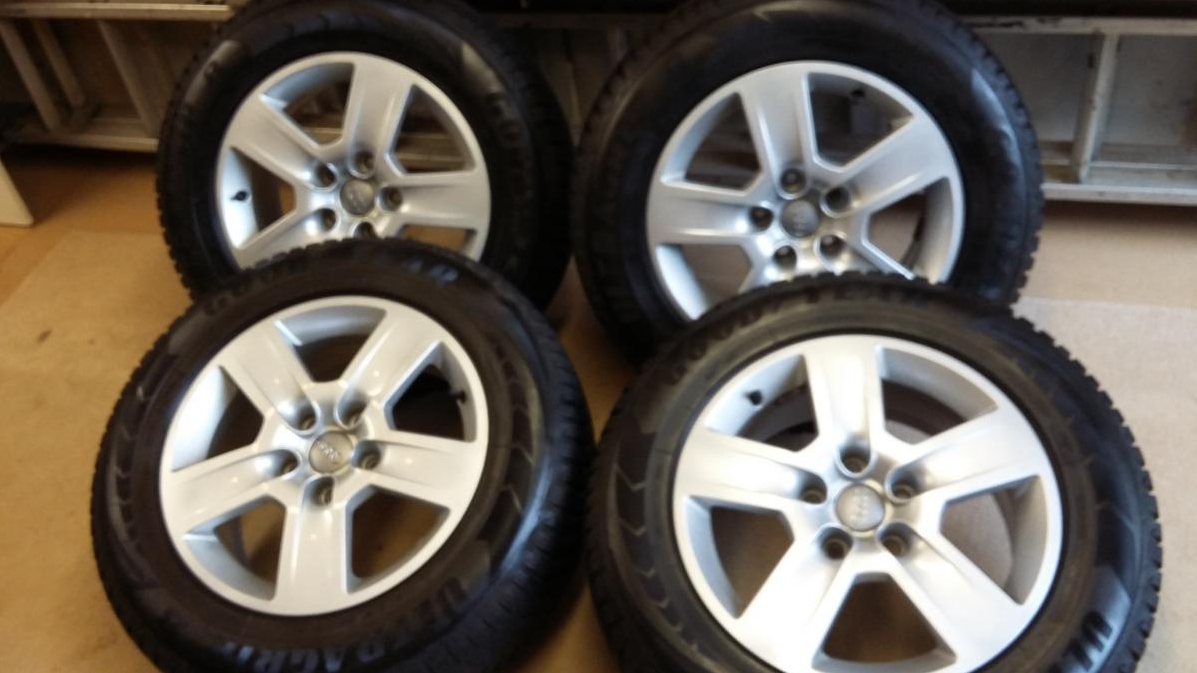

I've just bought a set of winter wheels and tyres for the Yeti from john999boy , and being new to the winter tyre malarky I'm not sure what pressures to use . They're 215/65/16 Goodyear Ultragrip 8 tyres , any recommendations would be appreciated.
Oh and thanks very much for delivering them to me today John , top bloke  :thumbup:

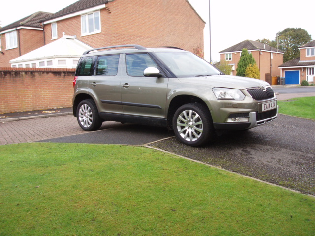

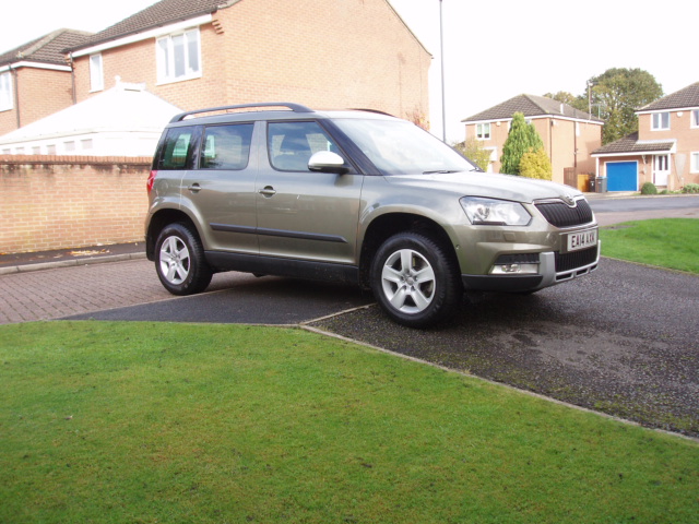

Winter wheels on , gosh my camera is rubbish  :D
post-146200-0-74634200-1478612853_thumb.jpg post-146200-0-71662700-1478612860_thumb.jpg
