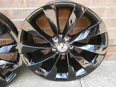

Thats good to know, I'm looking at some gloss black 18 8j Scirocco Turbine Interlagos for mine.
Wondering if 245s will fit nicely
Edited by themanwithnoaim
Nice alloys. Which ET?
I've asked the seller, let you know as soon as I do
I should have pointed out that the 19" wheels are also very difficult to have repaired, so unless you can find some tyres with decent rim protection or some decent quality rim protectors (I don't know of any), then stick with the bog standard 18" wheels and save yourself some cash, as you'll save on getting new wheels and when it comes to trade in time you won't get anything extra for having the 19"ers anyway.
If they are genuine ones the ET should be 41
Seller is saying et45
Genuine interlagos (part number 3C8601025D) are definitely ET41 (I have them on something of mine) either they are replicas or he is mis-reading it.
Not a great issue unless you really want factory VW wheels and ET45 may be a better fit for the front. 8" at ET41 is fairly close
