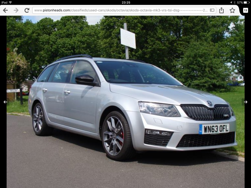

2 hours ago, pist0nbr0ke said:
Nuff said.
Has your vRS been lowered? It looks great!
Looking at mine today I really think it would look better dropped slightly - 20mm would probably do it.

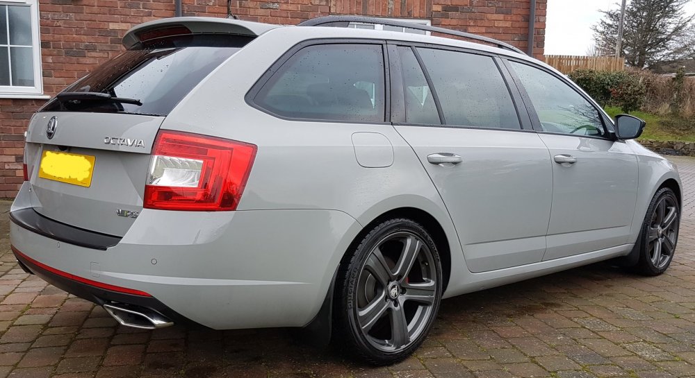

No, not lowered. I think it's a combination of photo angle and the wheels, they are  a lower offset so sit closer to the outside of the arches.

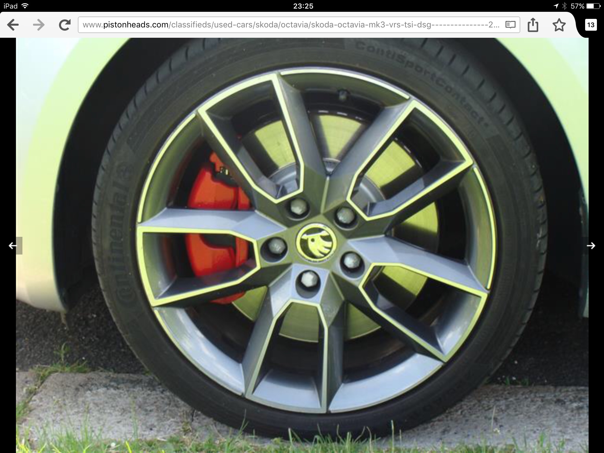

12 hours ago, pist0nbr0ke said:
Nuff said.
I do like those wheels, what are they?
