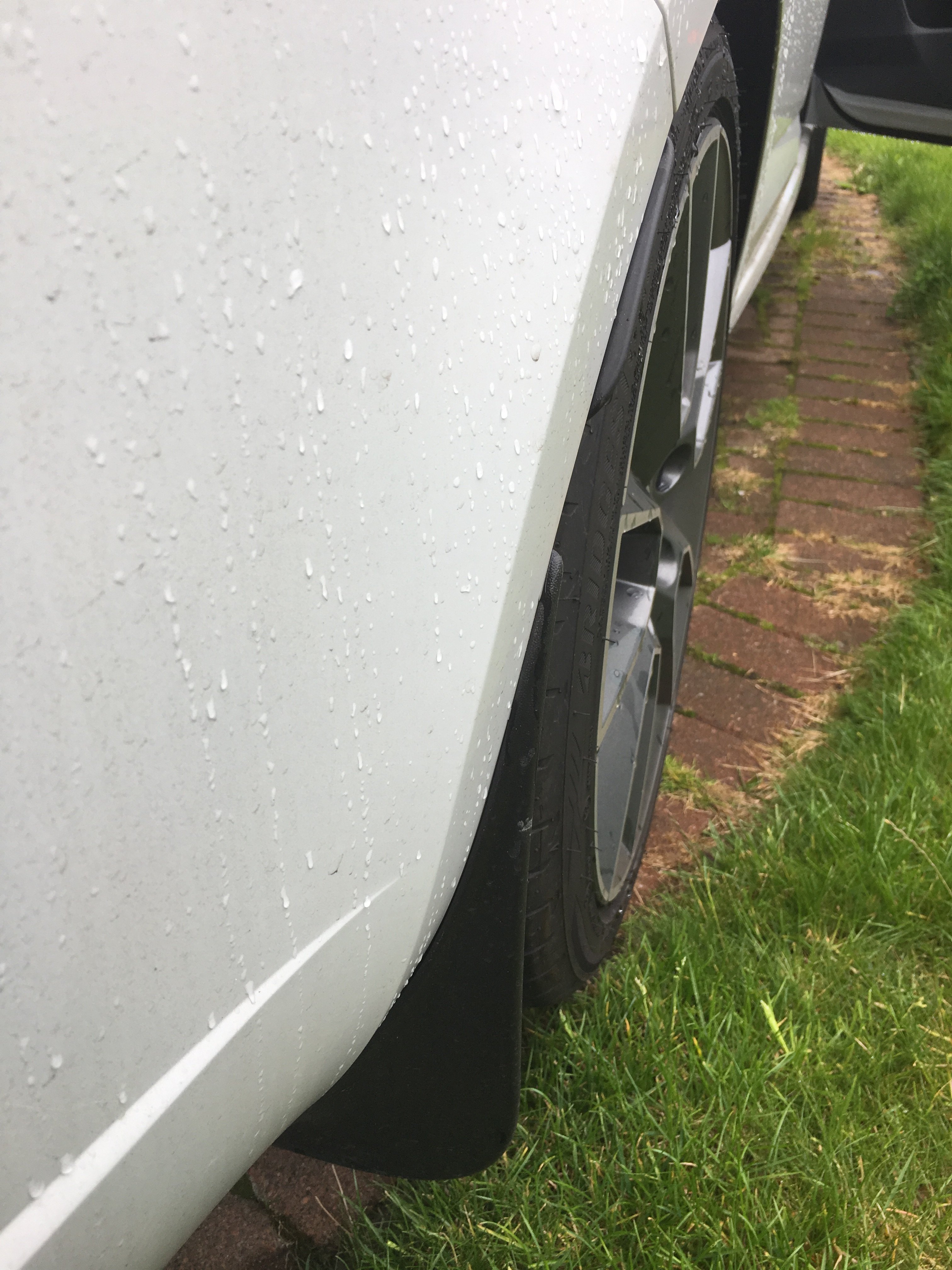

They fit. Here are mine. FL vRS.
Thanks for posting this. Is there any chance of them touching the ground then?
I’ve caught them once on a kerb. Other than that, all good.
They are fantastic at preventing dirt getting on the rear bumper. My last vRS was a total pain to clean. These make it a breeze.
