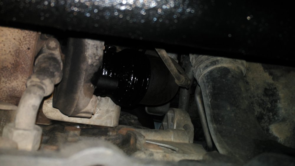

Recently i have taken my car (Octavia ii 1.9 PD MT Diesel) to service for regular service (116000 KM ODO) and found that there is a leak under the engine bay at Turbo..
I'm not facing any issue in pickup and power .. but I'm worried because technician told replace it as it may cause issue suddenly.
Actual Turbo cost is very expensive in india.. more over i'm not sure the leak is outside because of any pipe damage or its internal,, one turbo specialist to le me to replace  Turbo Banjo washer  and check as the leak is outside only (He has not inspected the car in person)
Please help what should i do now ? i'm attaching the picture for reference .
Thanks
Baskaran
why dont u pull out the turbo clean it ,clean all actuators and see if it repeats .
looks like a blown gaskets in turbo !
btw where in india are u in?

Thanks TTJD.. I must try it as since last two days i'm getting "glow plug" orange light indication and the power is getting reduced during that time, it repeats even after restarting the engine !!
Fingers crossed nothing should be major...
