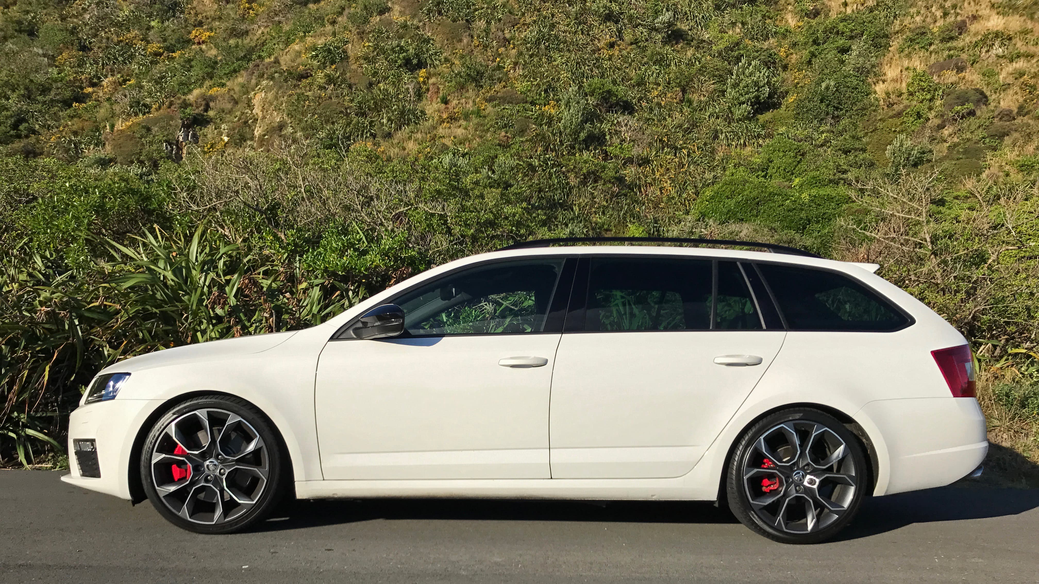

Update - suspension has been in two weeks and really pleased. One slight issue in that I don't want it very low and in doing so, critical measurements KW specify aren't being met and the spring coils are touching when I go over a dip in the road. KW have recommended alternative springs so I'm waiting for these to arrive now.

Jury is still out on the height. It looks awesome but I'm finding I need to be super careful with kerbs and parks now, which is getting on my nerves. Guess I can't have the best of both worlds.

So the KW's have plastic sleeves, and no I mean the coils actually touch each other. There isn't much distance between them so I guess the rapid impact of the dip makes them touch. I'll post an update once the alternative springs arrive.
