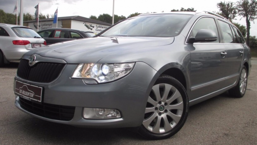

I have tried researching the interweb for help w new bulbs for the 12' Superb I just bought. It's got the Xenon headlights which I'm thrilled about. But the lower bumper fog lights and DRLs need help.
I would like some LED replacements for the DRLs like I had on my Nissan w 360* lights etc. The color temp is also very close to the xenons.
But what about bout the fog lights? Are they H7 or H4 or ?

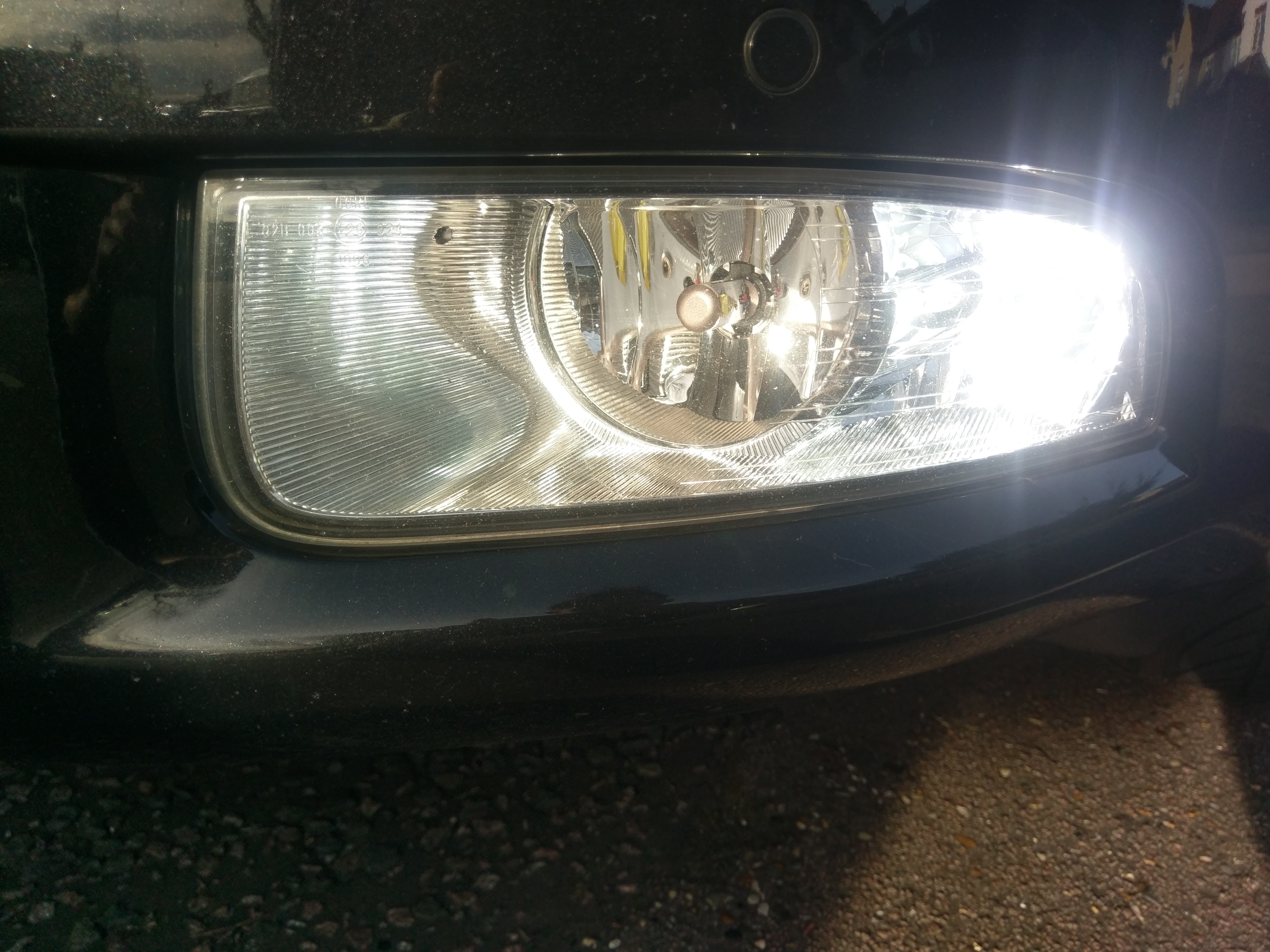

Hey mate, lovely purchase, so the fogs are H8 and drls are P21W as far as I remember. I went with Cree led as they are the brightest

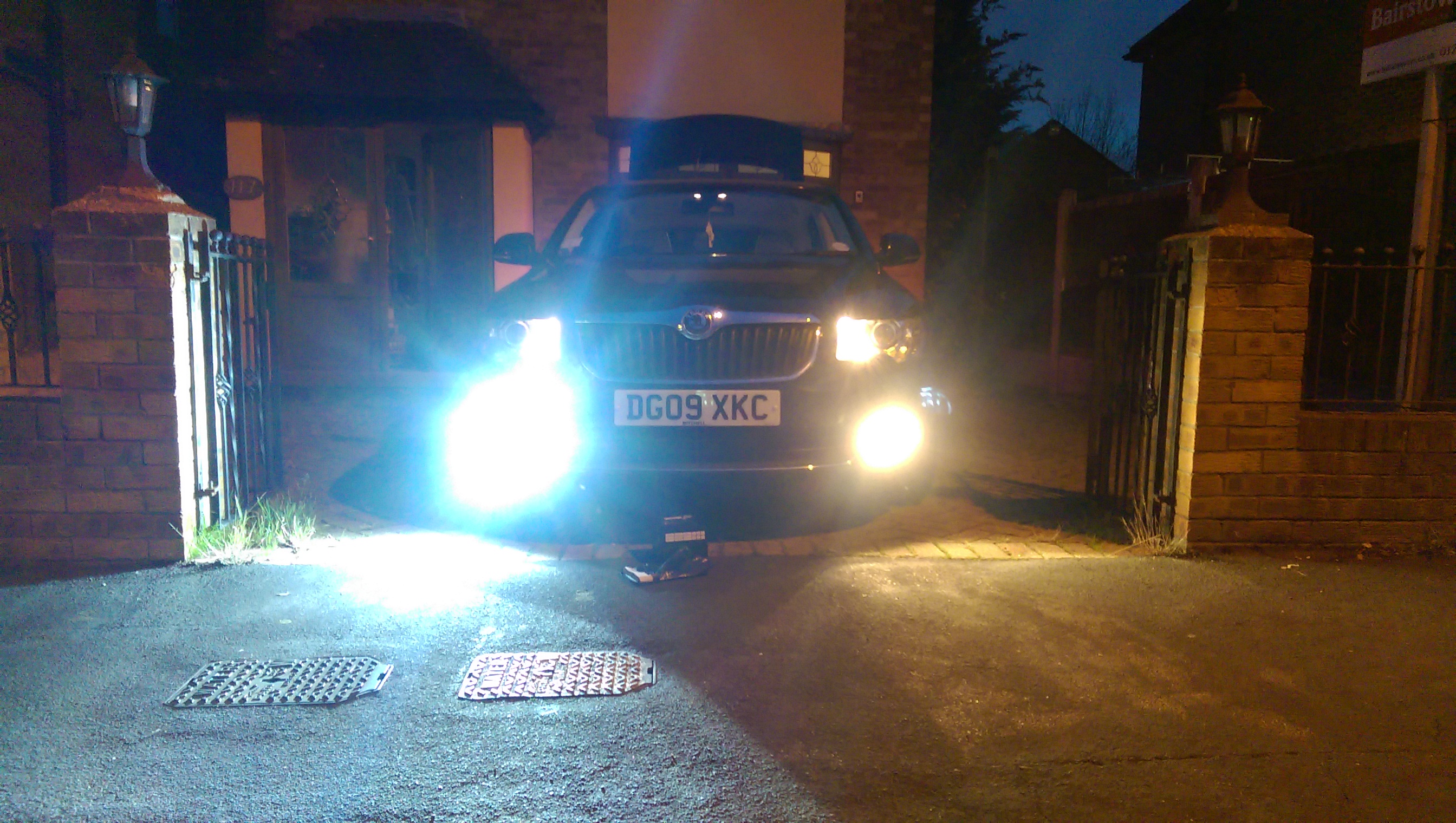

And in comparison fogs on my old superb

In that last night pict, the extremely bright light on the bottom left..... is that the fogs?
if they are the DRLs, I'm pretty sure the Politi will be all over me. Lol
Those are pretty bright!. Of course, if there was any fog, you would be totally blinded ;)
They are fogs, and they are not as bright as it looks like in the photo, but of course much brighter than halogen ;)

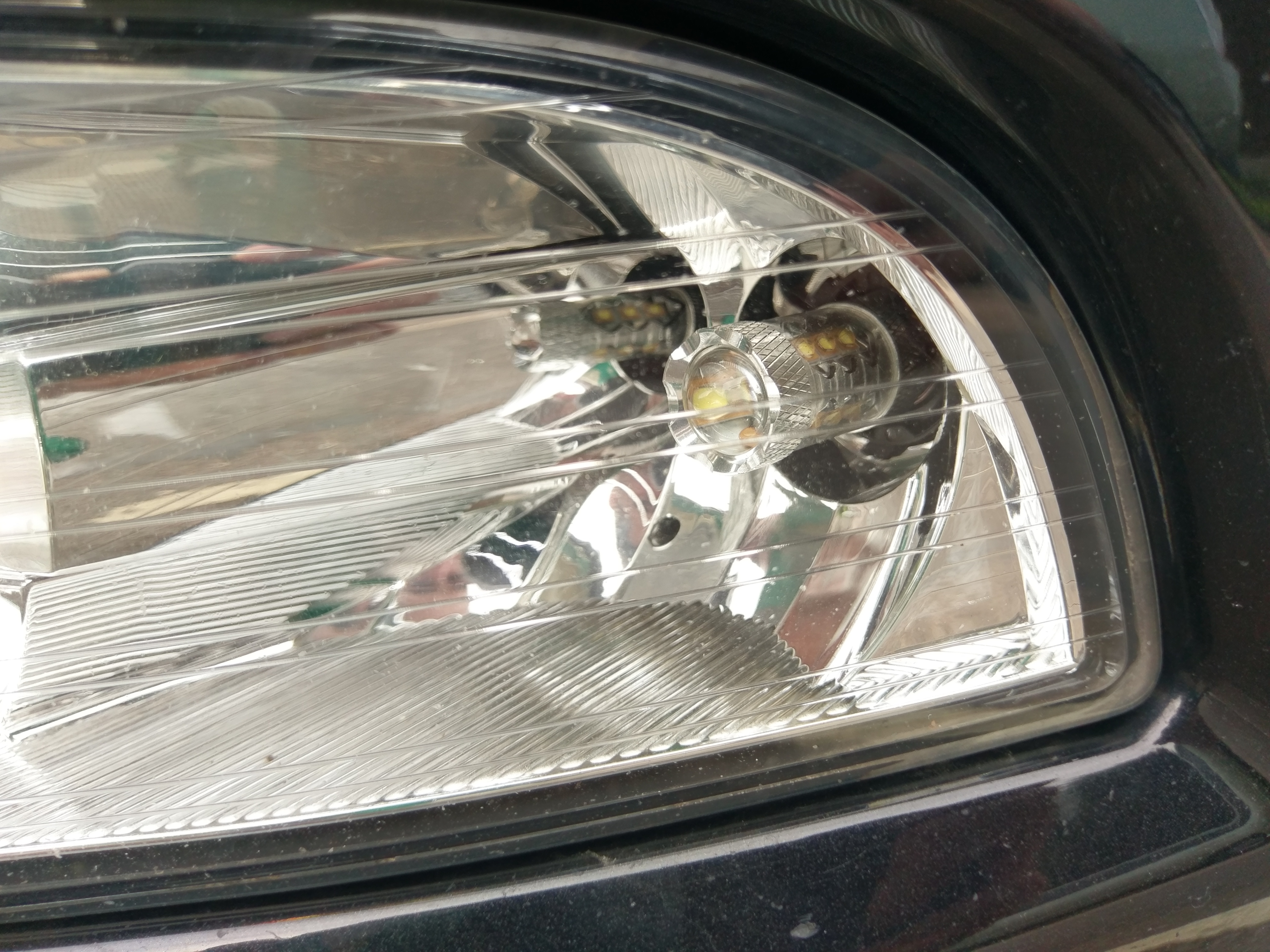

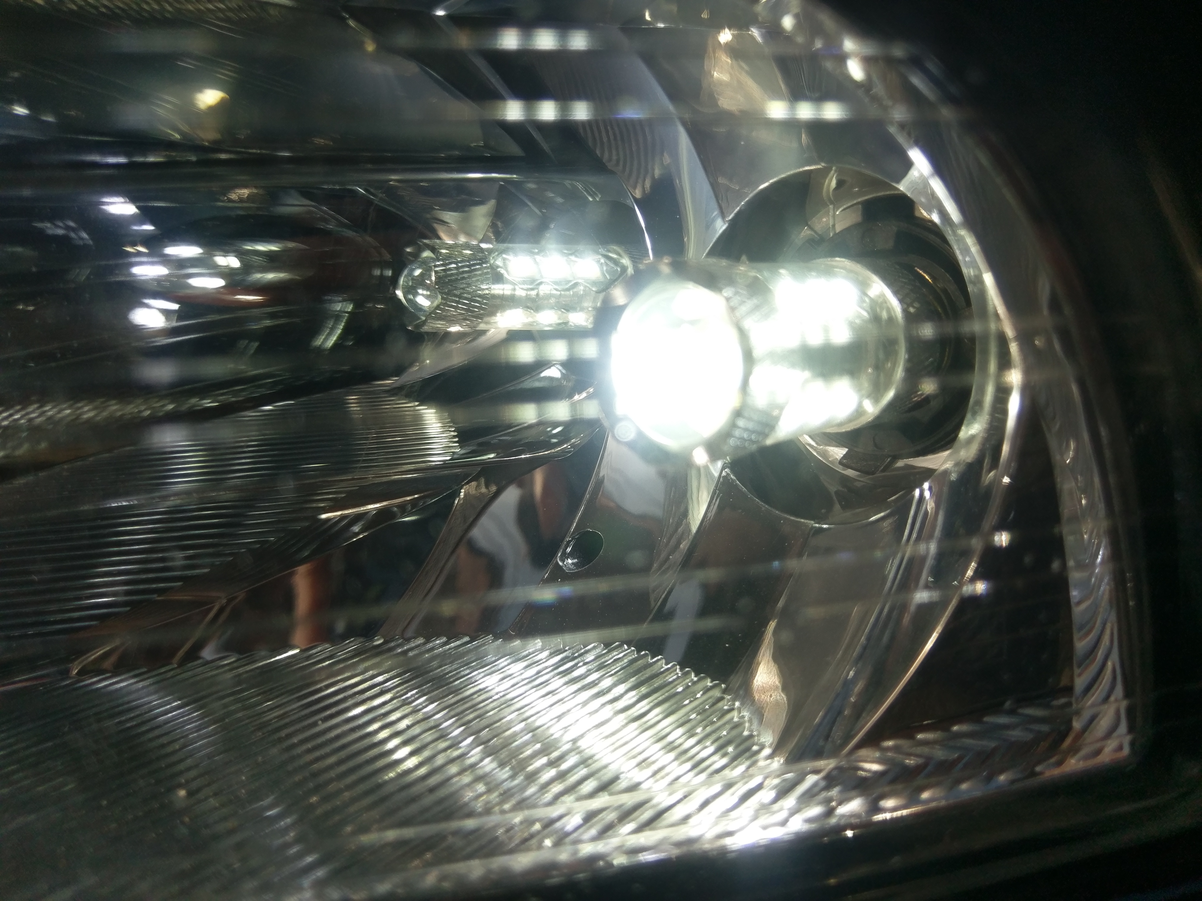

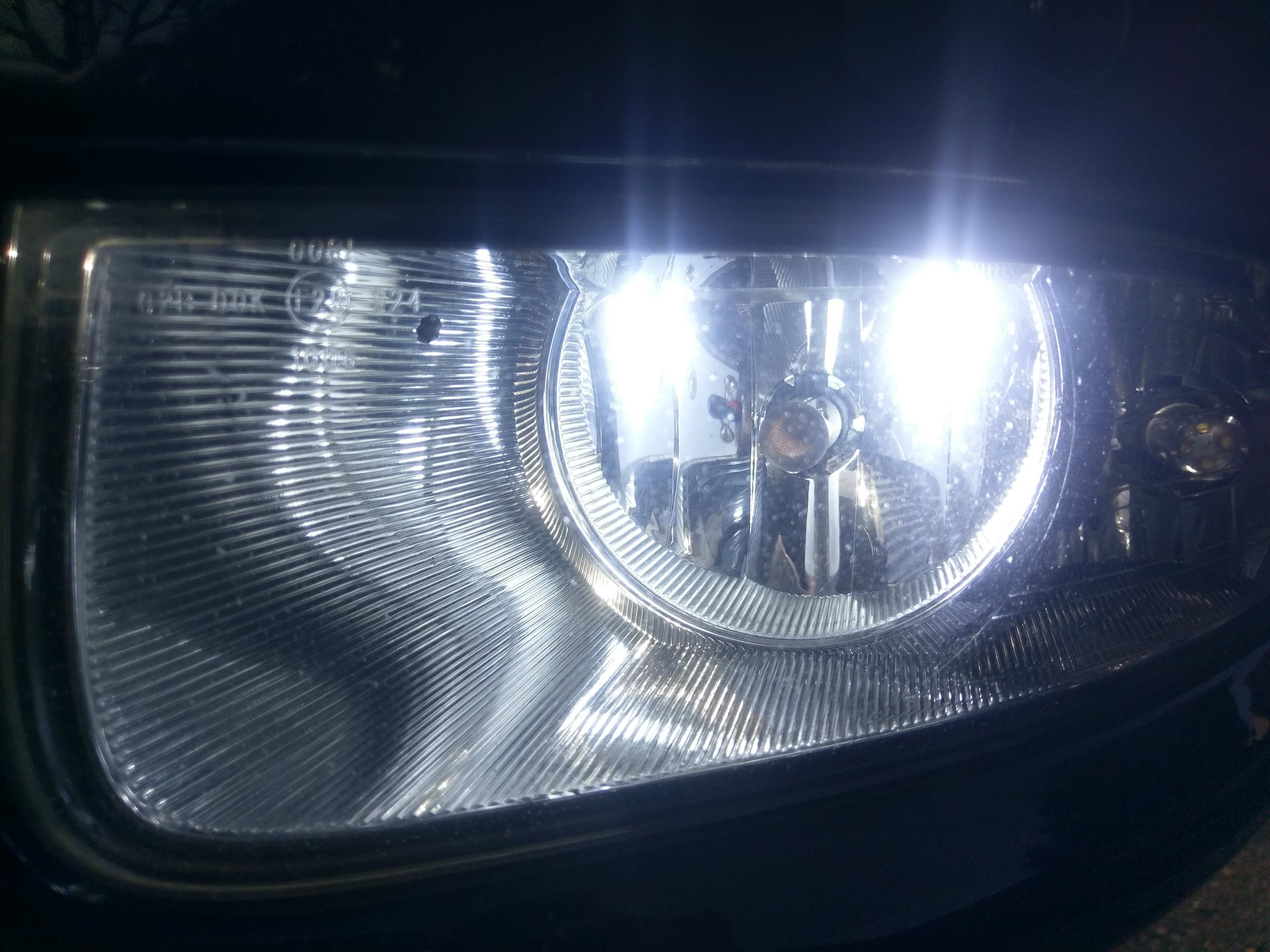

So there are my drl

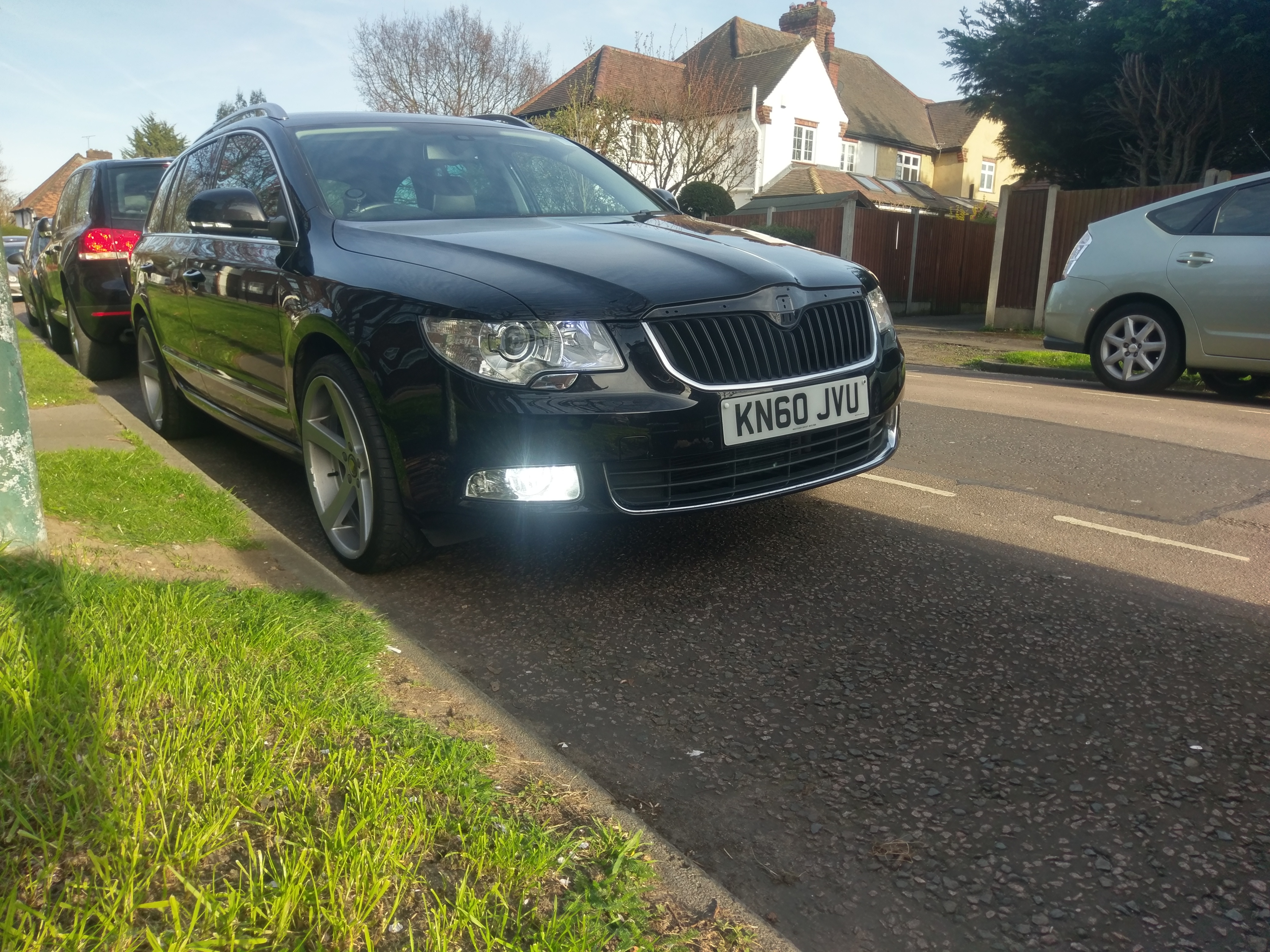

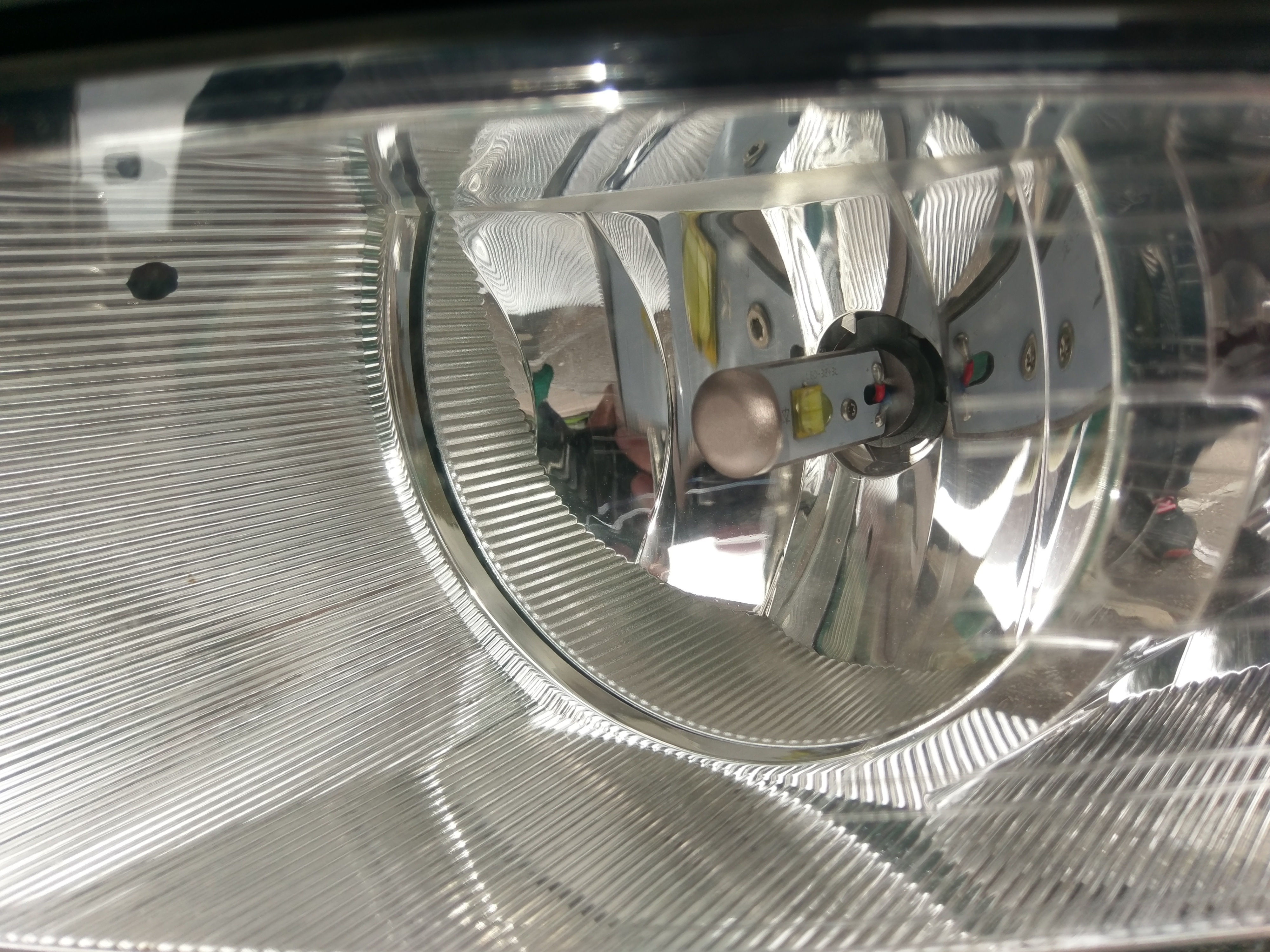

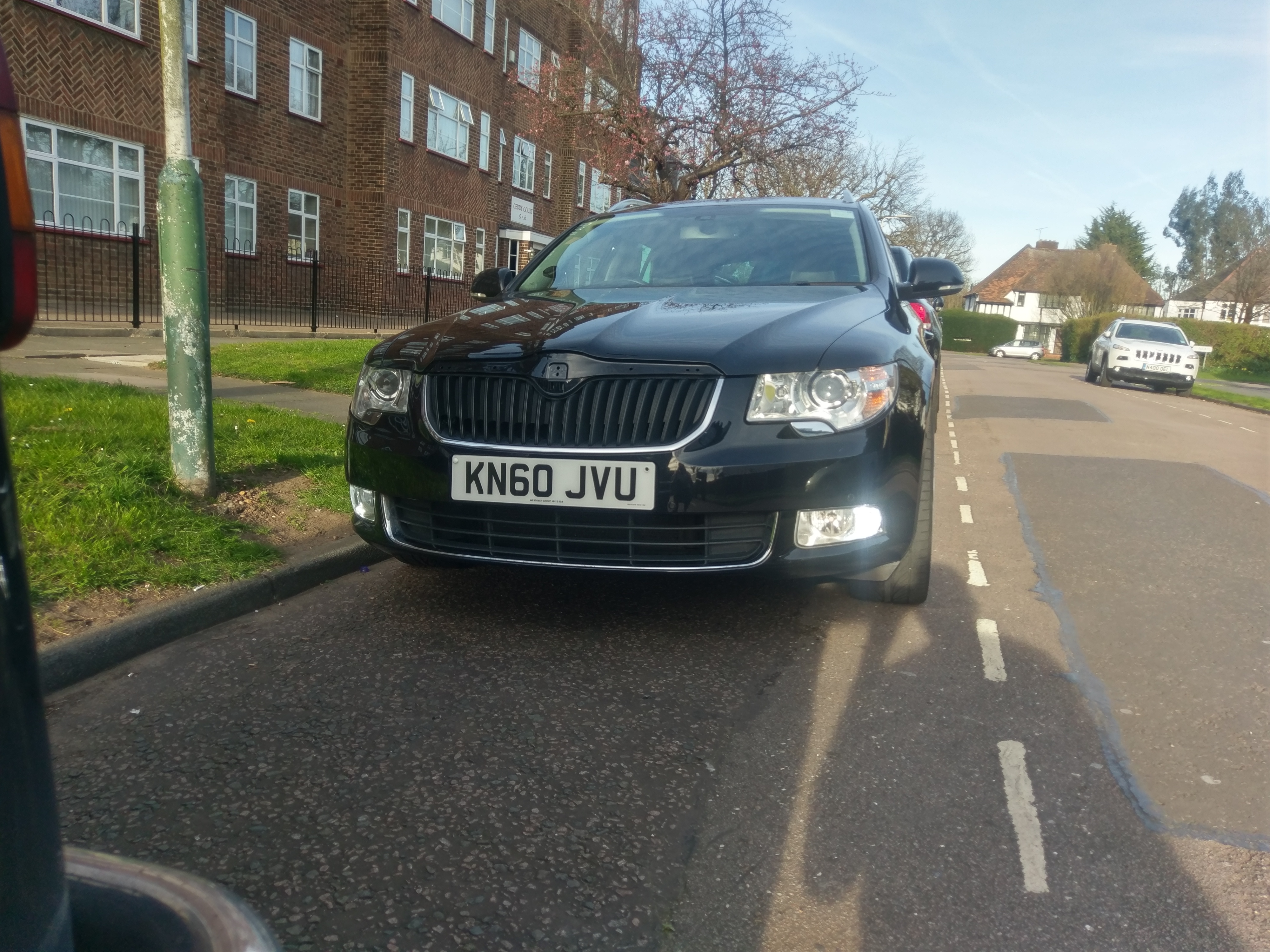

And there are my fogs in daylight

Had these bulbs for last 3 years, and been in fog and trust me I'm far from being blinded, they are really good in fog ;)
They are exactly like I'd like mine. Thanks for posting up Picts.

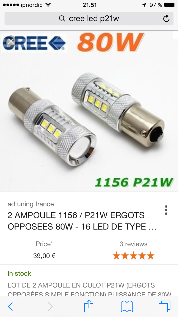

do these look right?
Yes pretty much the same, just try to look if you can find with canbus ;)
Those are listed as Canbus. It's just out of the screen shot I took. I'll order them tomorrow.  Thanks for the help.

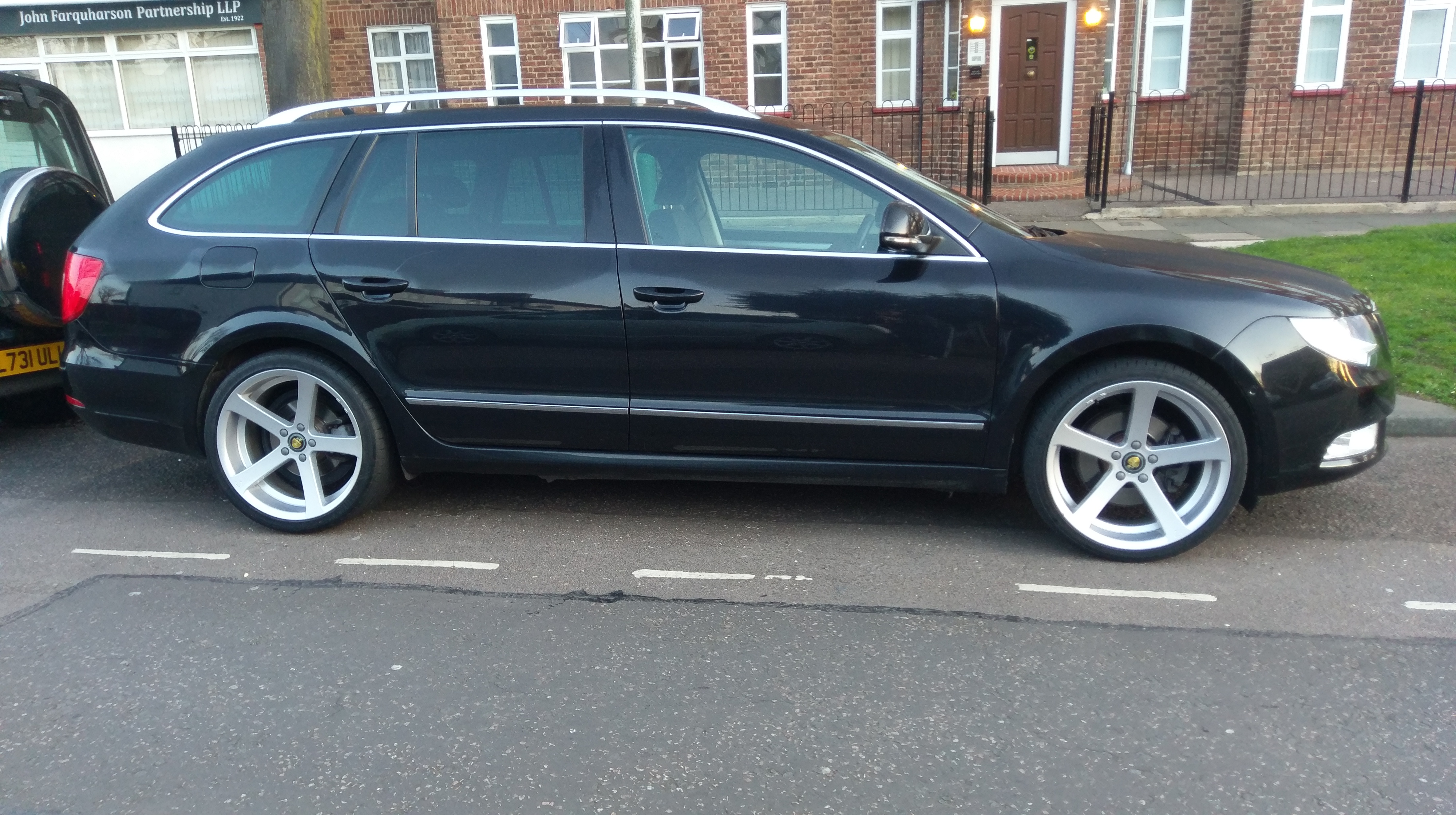

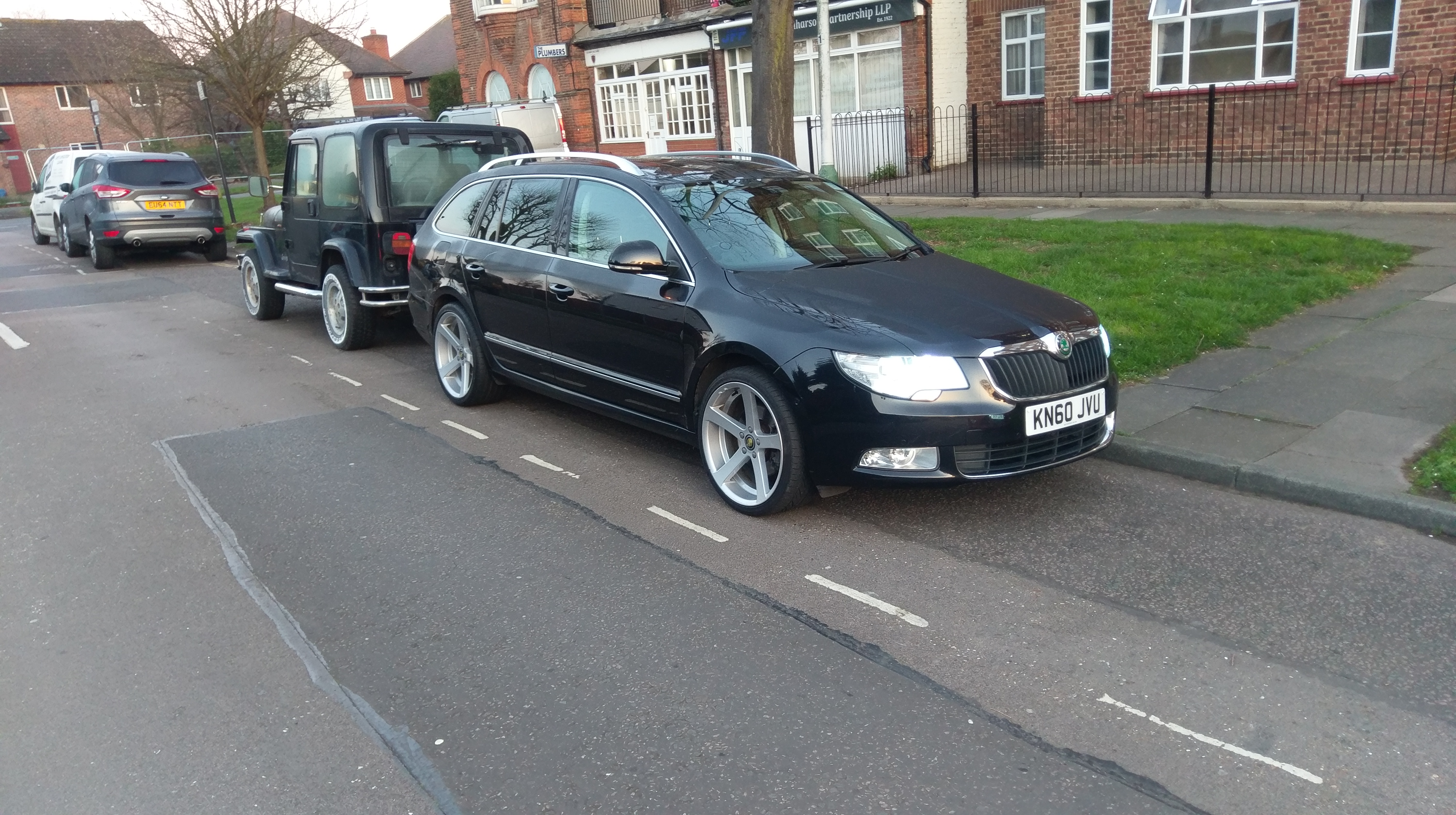

By the way, what's the specs on your wheels and tires? They sit well on you B.
Thanks. They are Apollo cades 19" with front 235x35x19 and rear ones are 245x35x19 ;)
I just need to lower a little, cause it does look a little like 4x4 :D
4 minutes ago, metlovas said:
I just need to lower a lot, cause it does look a little like 4x4 :D
Fixed that for you :giggle:
