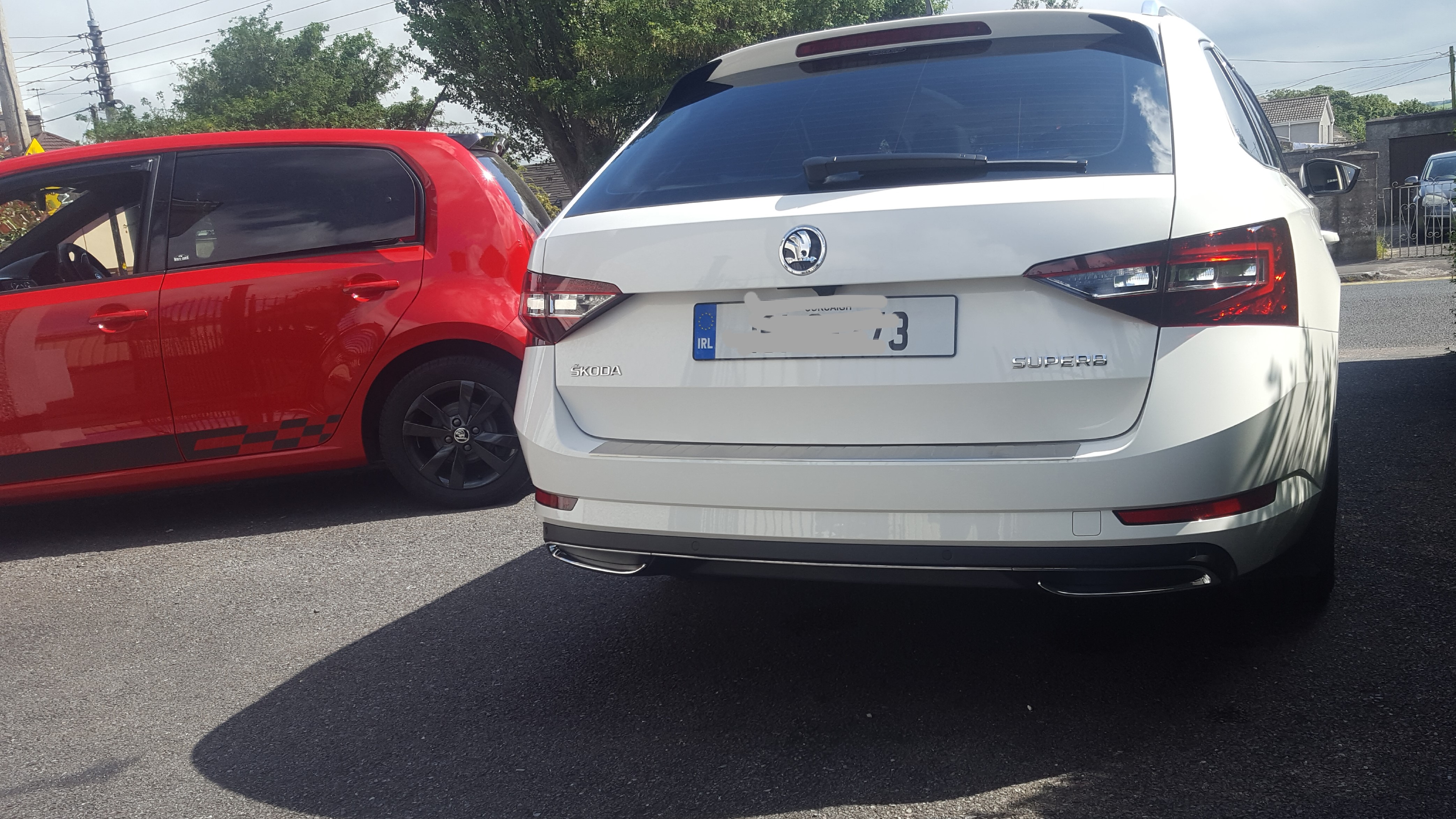

For those interested in seeing it fitted:

There are half a dozen torx screws on the bottom edge that need to be removed then you can gently push the clips to release the old diffuser, the sensor holders and virtual pedal plugs all need to be disconnected before you can remove it from the car.
The sensor holders (and virtual pedal sensor strip) are taped onto the diffuser with 3M double sided foam tape, this tape is a PITA to remove from the sensor holders BUT they really need to be spotless if you want to stand any chance of them staying stuck onto the new diffuser (I also wiped the diffuser and holders with IPA... Alcohol before sticking them on).
I put the sensors into the respective holders (all the holders are marked so you shouldn’t mix them up) before sticking them onto the diffuser as they are a very snug fit.
Time to remove and refit the new one about 30 mins or so taking my time, time to remove the foam tape off the sensor holders... ‘kin ages :sadsmile:

Looks really good :) nice job. So no need for hot glue then? What did you use to stick the holders back on? I'm getting mine in a couple of days, can't wait!
