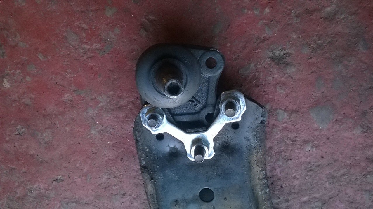

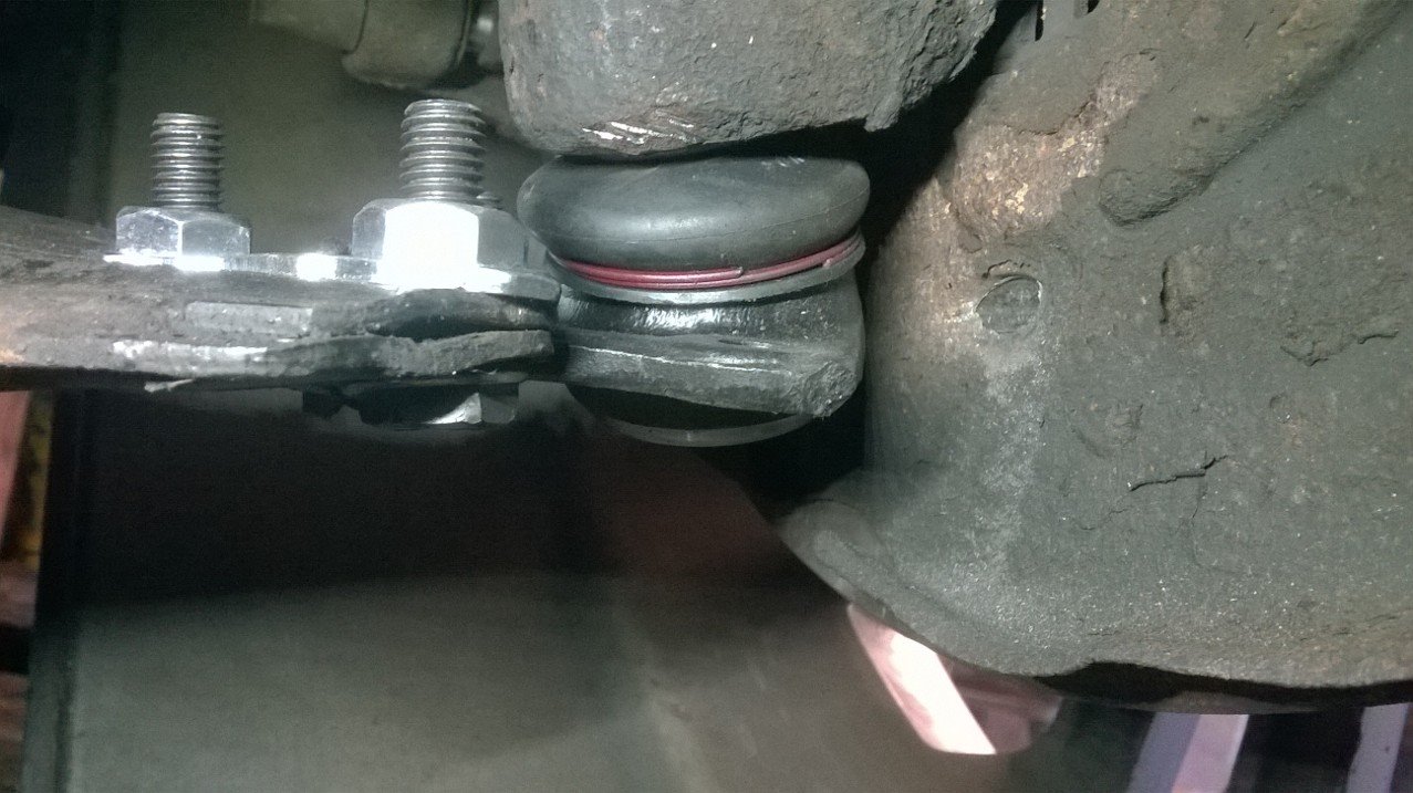

hi i have just changed the ball joint on my 2003 1.4 octavia and the three bolts that hold it onto the wish bone seem to be very close and touching on full lock to the hub???
i pretty sure i have the correct part fitted, was wondering wether i have bent the wish bone a bit, did do a bit of levering to get the balljoint taper out, but nothing to mega ( i thought).
any ideas of things to check?
thanks carl

Double check with the other side of the car. Take some pictures as it's easier to make a judgement with pictures.

i have the heads at the bottom thread end at the top, thats how the old ones where anyway.
did the other side and it was the same and i didnt put any pressure on the wishbone at all.
ive spent a while cross referenceing the part numbers and it appears they are they right bit although some of the photos seem to include split washers which would make the bolt a wee bit shorter, my kit didnt have any tho.
not sure if now that it is on the ground with the wheels on maybe the angles are slightly different.
i will probably just take it to a garage and see what they recon , id imagine they will suggest just cutting the excess bolt off.

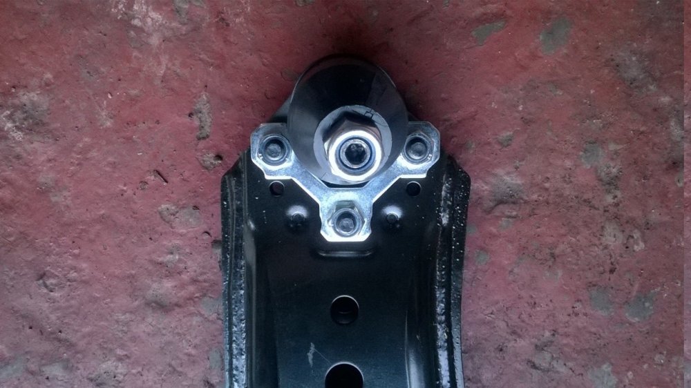

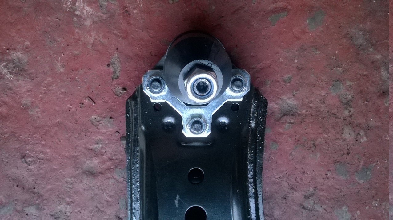

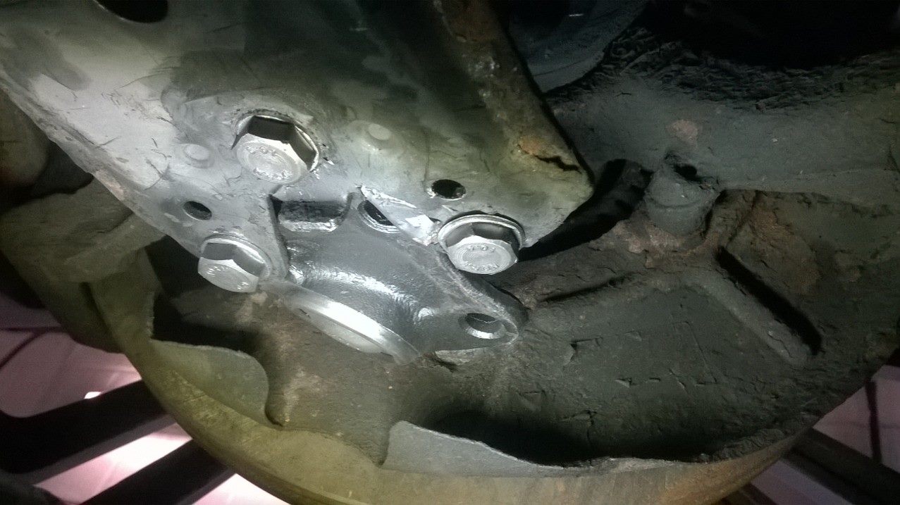

I had one come on that their 'mechanic mate' had put together but was a bit wandery now.. We put a new arm and balljoint on it in the end but it gives a nice photo of how it should look. I also include photos of the way it came in, and suggested that person never works on his car again.
i might not be great at stuff but not that bad, christ!!!!
One of the worst I have seen
