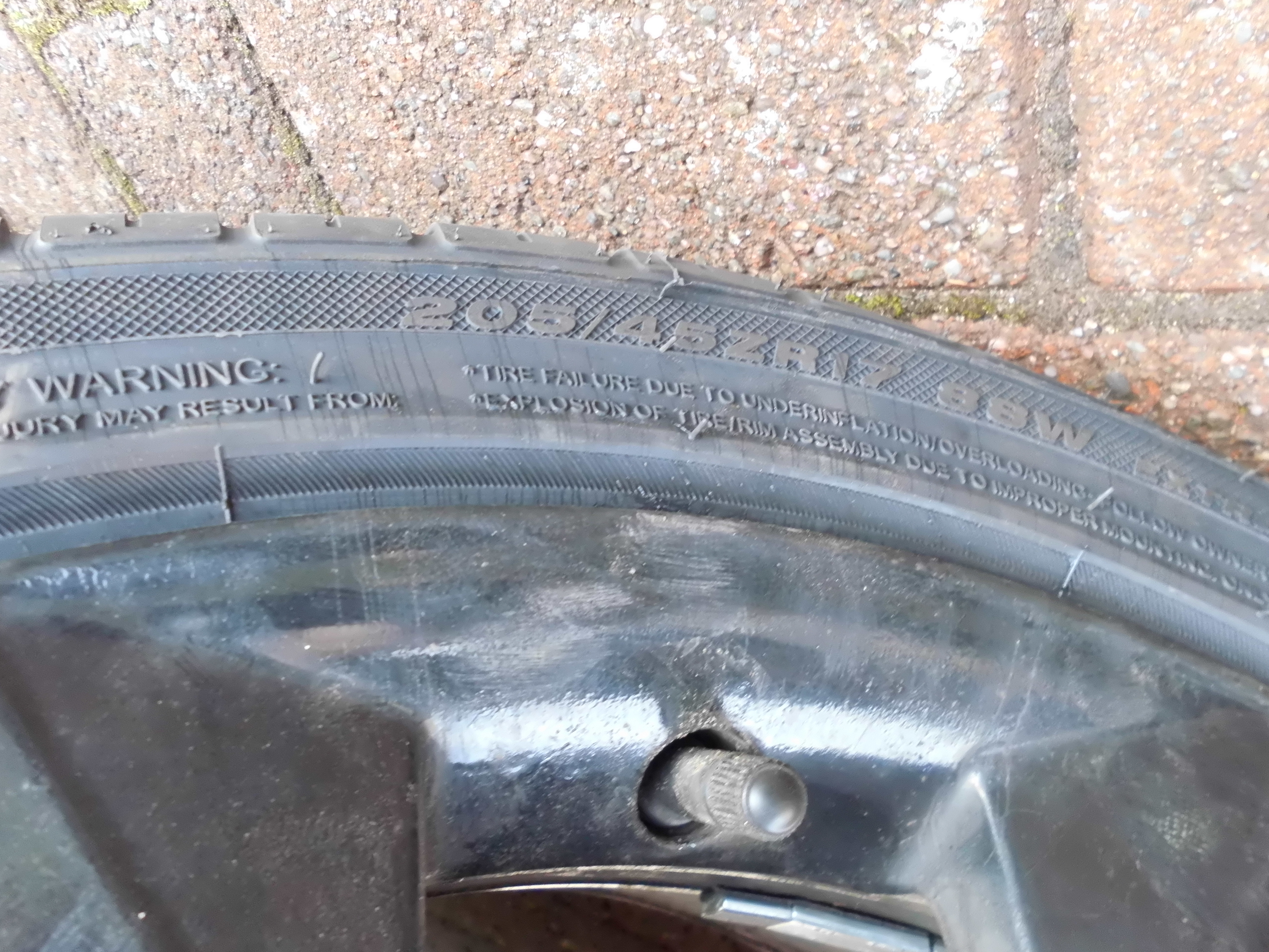

Whatever brand of tyre you choose consider 205/45/17 instead of the o/e 205/40/17.
A definite improvement in comfort & no loss of cornering ability, according to my wife, it's her car.

But that will change the rolling radius by 5% and send the speedo out...?
It will correct the speedo but not read over more likely, and not all 205/45 R 17 actually measure more than 205/40 R17's
Likely new Pirelli Zero Nero 205/40 R17 are taller than some 45 profile if you measure side by side.
I put 205/45 R17 Goodrides on last week that are just the same size as 40 profile tyres i have.
(They can be more comfortable as 215/40 R 17 can be, Brand / Compound / Sidewall dependent.)

These do not give a softer ride as tough sidewalls (XL / Extra Load) and no difference on the Speedo /GPS readings from 205/40 R17's
