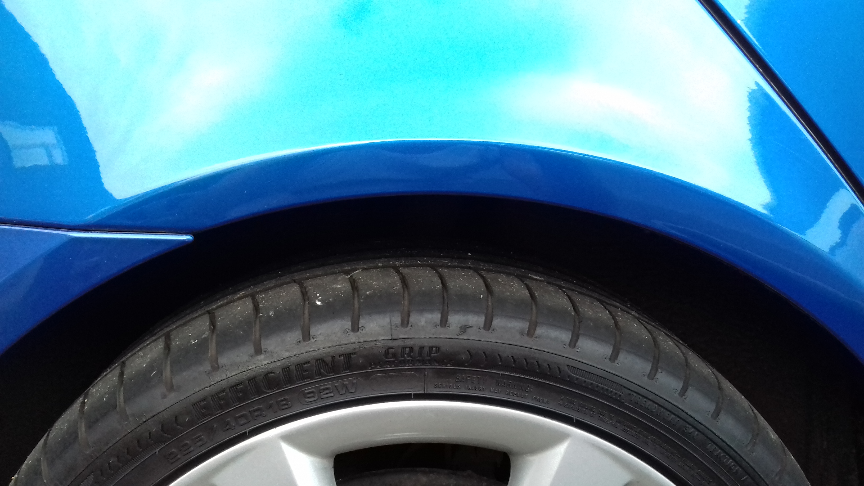

Well just to fully close this topic, the second set of new springs have been fitted, the correct ones this time. It's amazing what a difference a drop of only about an inch makes to the look. Thanks one and all for the info provided.
Thank goodness. I'm sure the garage was wrapped in changing the springs out twice!  I do wonder how much might have been TPS user error in interpreting the parts diagrams, especially if different variants are used in footnotes notes in parts diagrams.
FWIW, your tyres Goodyear efficient grip by the looks are W rated, on my vRS the tyre plate minimum is 92Y, technically W is illegal, although in practical terms of course it is all irrelevant.
Yes. don't know how TPS got it so wrong. Can't beat the old days when the parts man knew off by heart every part on the shelf for all models.
I think I should be okay with a W rated tyre. W are rated to 168mph. Can't quite get up to that speed for some reason. Your Y rating allows you to exceed 186mph.
It is academic I agree, but I don't make the vehicle regulations or the law pertaining to vehicle compliance.  We can't fit H rated tyres for the same reason even though they well exceed 70MPH. How low can you take it?  I was just pointing out to you in case you were unaware and if you ever find yourself against a fine print focused glasses wearing insurance assessor with pocket protectors.....
