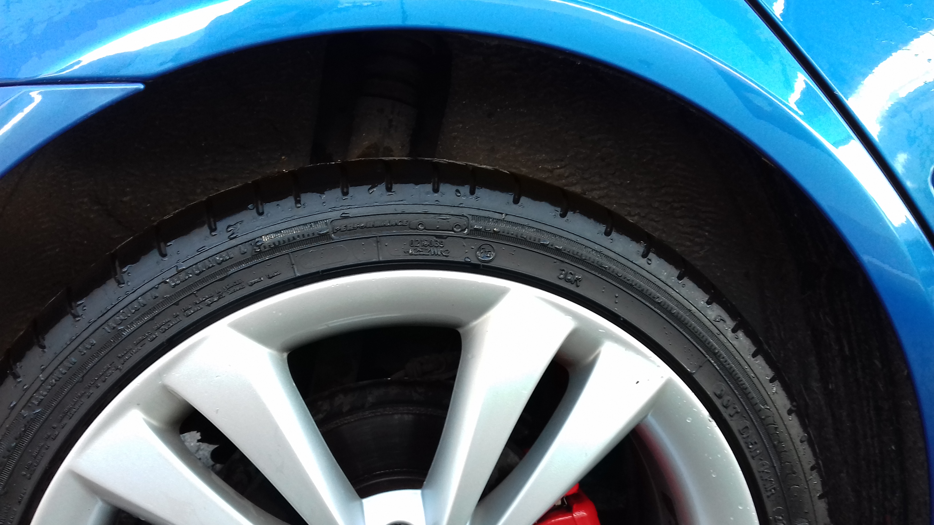

See what I mean, bloomin high. Looks like the wheel arch and the tyre have had an argument and want to keep their distance.
Looks kinda high.  Was thinking of a full side on pic of the whole car to compare with the front too to get an idea.
But yes that does look like a good size gap!
Will be interesting to see how the new springs from tps compare with those ones side by side off the car.
Hi Redfab
The space at the front is at least a 3rd less. The space I have now is the same as the space on a standard Octavia, as I found one in a car park and asked the owner if I could measure it. He may at first, before I explained why, have thought I was a crazy man!!  There is another VRS that always parks just around the corner and when I look at the rear of his, it reminds me what mine looked like before these new springs were fitted. Hopefully when TPS get the back order of springs next week, they will be the correct ones.
