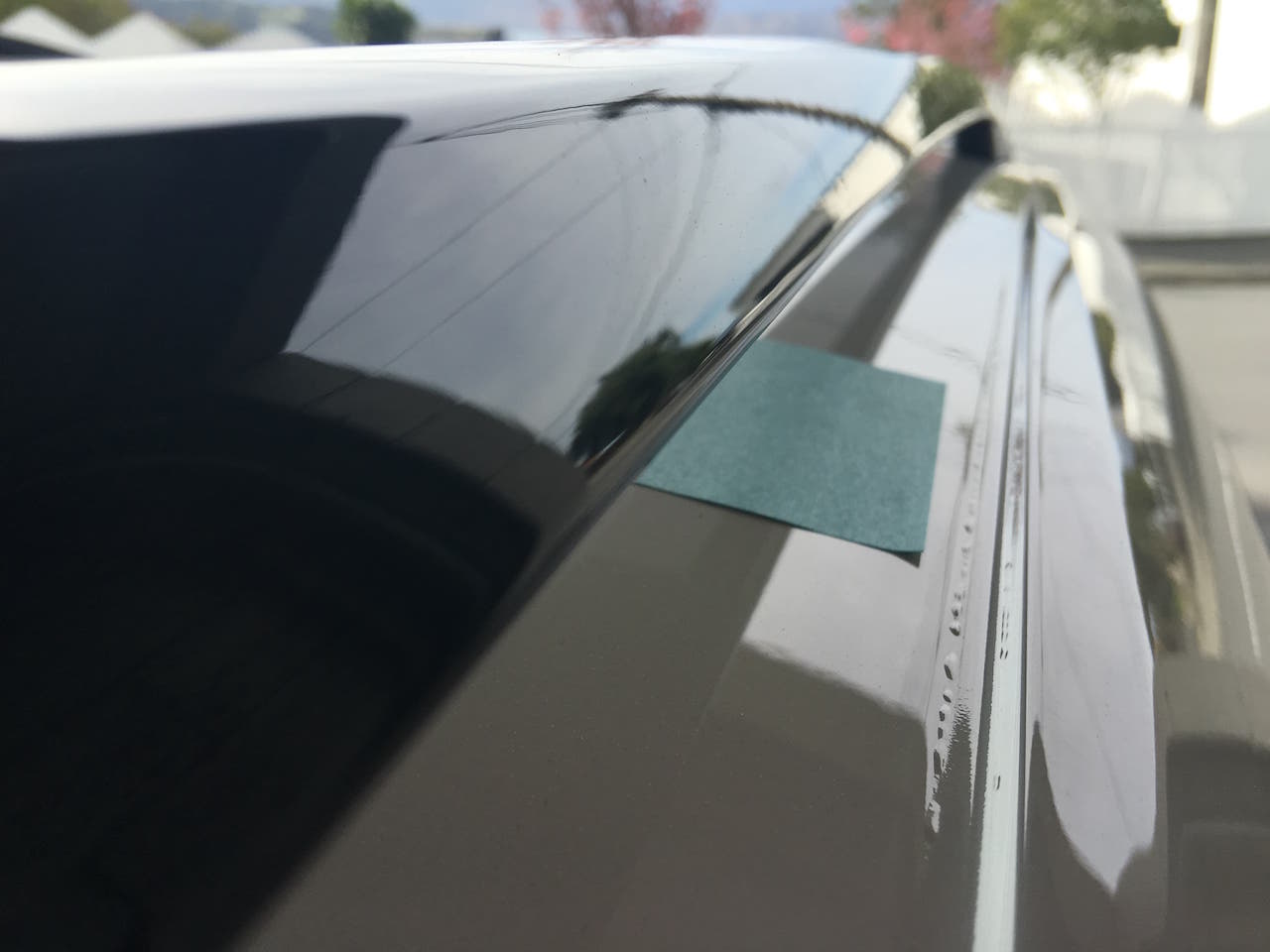

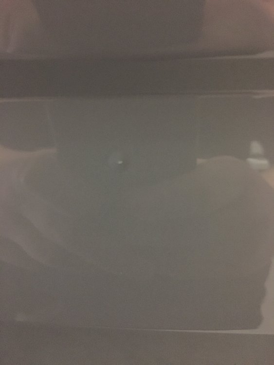

Here in Finland, we have lot of cars with one or more zinc bubble.
Usually they are in front doors or in trunk lid.
Skoda importer usually says "those are stone chips" even though these also have been fixed in warranty.
Every dealer with whom i have talked to has acknowledged the problem but they can´t do nothing because importer says "stone chip"
Have you guys noticed that problem?

I had an issue with mine with water bubbles on the roof. The dealer arranged to have the roof re-painted under warranty.
Bubbles? Anybody?
