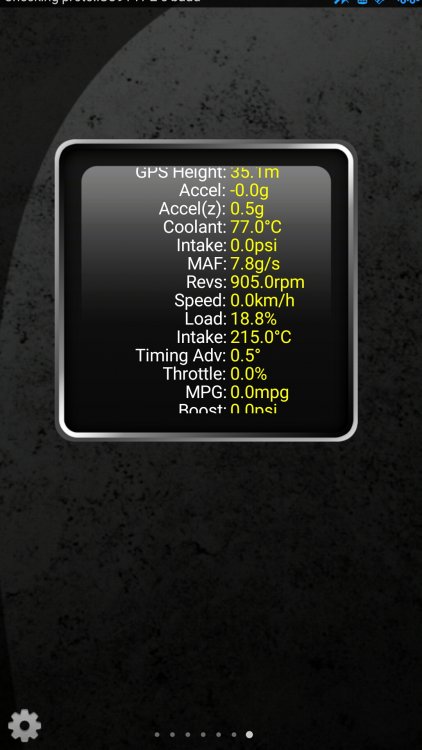

Hello, plugged in obd2 found two errors. Turbo boost sensor A low input and intake air temp high. Can somebody point me the exact location of turbo boost sensor and intake air temp sensor? I will look for any grounds or shorts. The vehicle is fairly old and ran 200,000 kms.
I feel underpowered especially when vehicle is under load. Mileage seems reasonable at 15 kmpl but I am a very conserved driver.

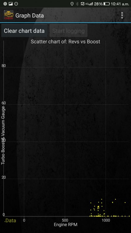

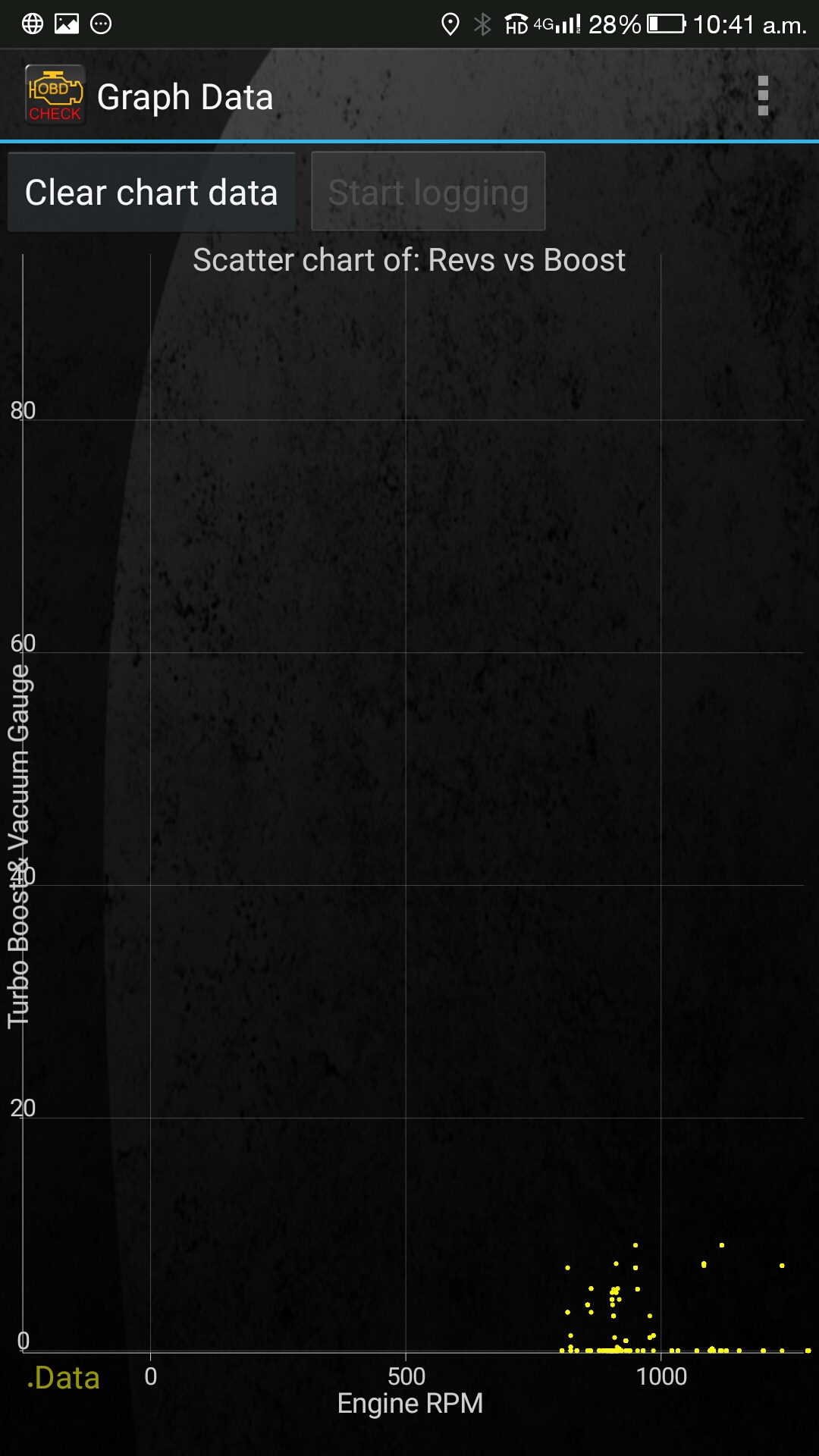

The second pic attached is a graph between revs and turbo boost. Are they normal?
