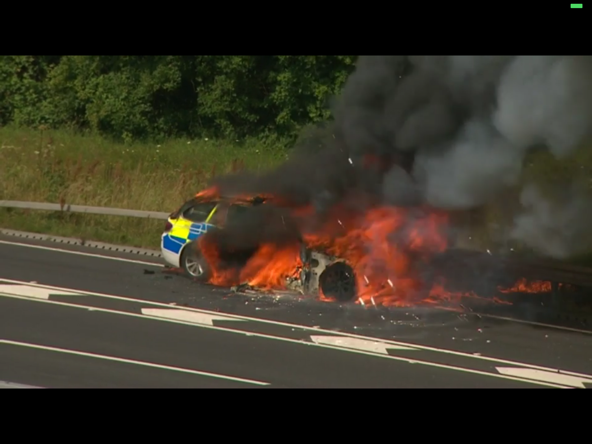

Just been covered on BBC Watchdog, trouble after fix
Post fix or gm Safire ?
9 hours ago, HowardBury said:
A BMW 530D apparently, although you might find yourself speculating about what else was in the car to make it explode that way ........
Could be one of the seat belt tensioner explosive devices.
Possibly, but I'd have thought that maybe the insurance companies would be having a fit at the thought of cars being totally destroyed in this way. I'd much prefer that it was an armed response unit and this was their ammo going off big style.:wondering:
But that explosion is not what started the fire just the result of it.
Could have been something as simple as a poorly fitted replacement heater fan resistor starting the original fire as in most cases of fire with the Vauxhall Zafira.
