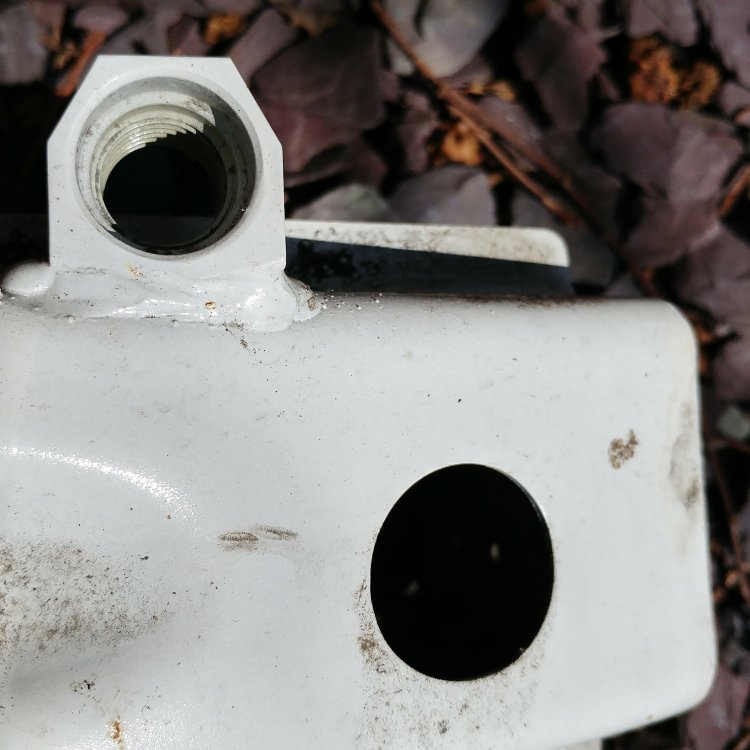

Just fitted a oem towbar to my Octavia mk3 and when removing the cross brace to make room for the towbar assembly I noticed the towbar doesn't have the big screw that the towing eye screws into. If you didn't know this you spend all day after removing the blanking plug in bumper trying to screw it in. Guess you just have to use the towbar it's self now I guess !!!.

"On vehicles with a factory-fitted towing device, there is no mount for the screw-in towing eye behind the cap. Use the built-in detachable ball rod for towing.Towing the vehicle using the towing device is a viable alternative solution to using the towing eye.
If the towing device is removed completely, it must be replaced with the standard reinforcement of the rear bumper which is part of the mount for the towing eye" The detachable ball rod must always be in the vehicle so that it can be used for towing, if necessary.
RTFM? :tongueout:
Still NOT clever though - they have eye-mounts in tow-bar ironwork for other cars :angry:
