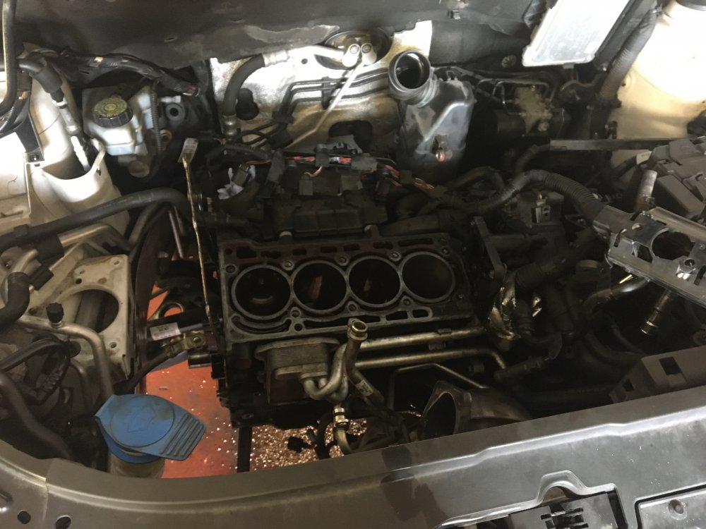

Piston melted in cylinder 4, no damage to cylinder luckily enough, timing chain was aslo loose, 2 of the valves weren't sitting right either
Current condition of my car
that sucks hope they find the cause of it
