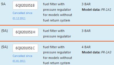

3 or 4 bar depends from model data. PR numbers can be obtained from Škoda dealers, according VIN- with full explanations for each PR code.
Maybe some data from vehicle sticker helps too?...

Thank you for that picture with filter numbers, I will look for PR number on the sticker in the trunk. I was on VAG diagnostic at my friend, one error was there, drive battery voltage. I dont know what that means, car is going fine, mostly on short trips, wife drives it everyday, 1-5 kilometers. Sometimes 10. Fuel spending is 8.5/100 KM, that is wery well for short trips.
