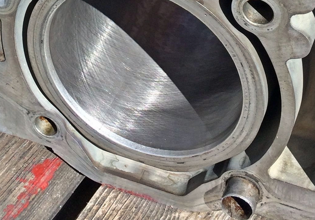

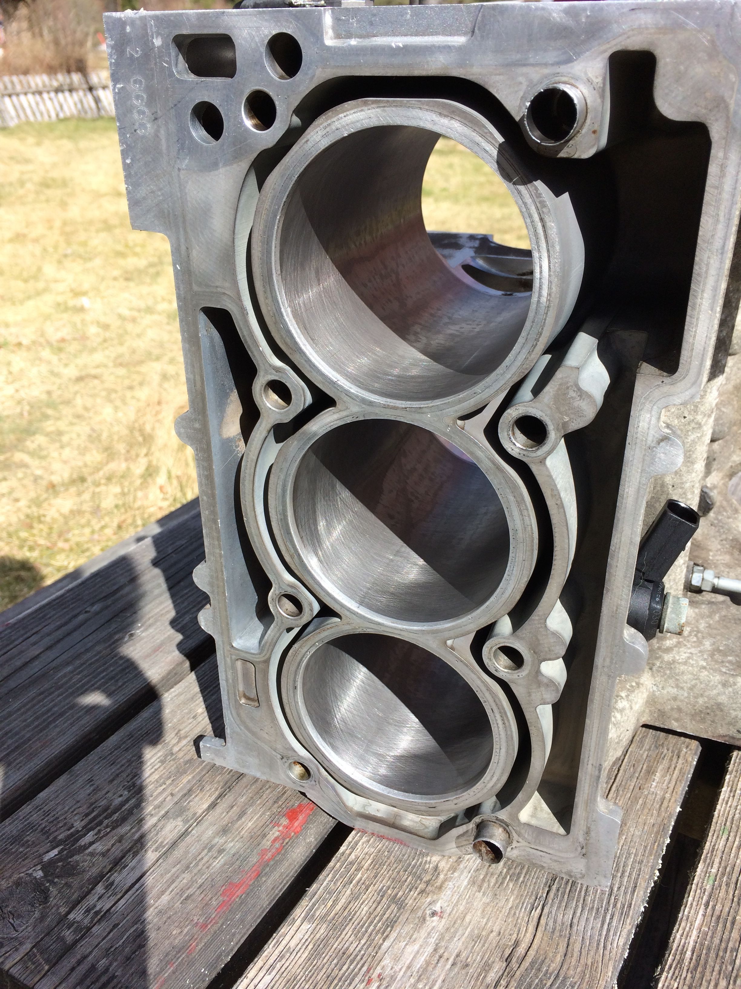

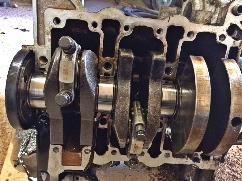

Drossling the outlet from the PVC-valve to 2 mm hole -jet. Redused the spring (changed) inside.
Fixed worn camshaft bearings so so the oil don't  popped out directly to the crankcase ventilation outlet to the air filter - wrong place.... But by having good camshaft layers I let it go. Before it brought large amounts of oil drops just over to the intake - under the filter.
Stopped oil supply up to the pistons by turning the bearing on the piston bolts 180 degrees. Drill 8 mm holes halfway down into the the top lining to collect oil for lubrication. Old style lubrication. Stopped the inside oiling in the conrod.
Here I had overfill with oil to the pistons when the bearing were worn. Not necessary for me that Im not drive racing.
Replaced all bearings in the motor
Purchased a new piston and used two used, from another engine with new piston rings.
The to other piston gave 10,5:1 in compression, so I took off 1,5 mm on the top of them and cheeked the weight - 250 gram to all tree, and compression 10,3 on all. The two was from an azq-engine. Near the same compression on all now.
Precision-honing cylinders - very important!
Changed cam chain and oil chain.
Set the camshaft 2 degrees forward to increase the torque so that it will peak from 2800 rpm - before 3000 rpm. More quick response!
All bearing changed:
