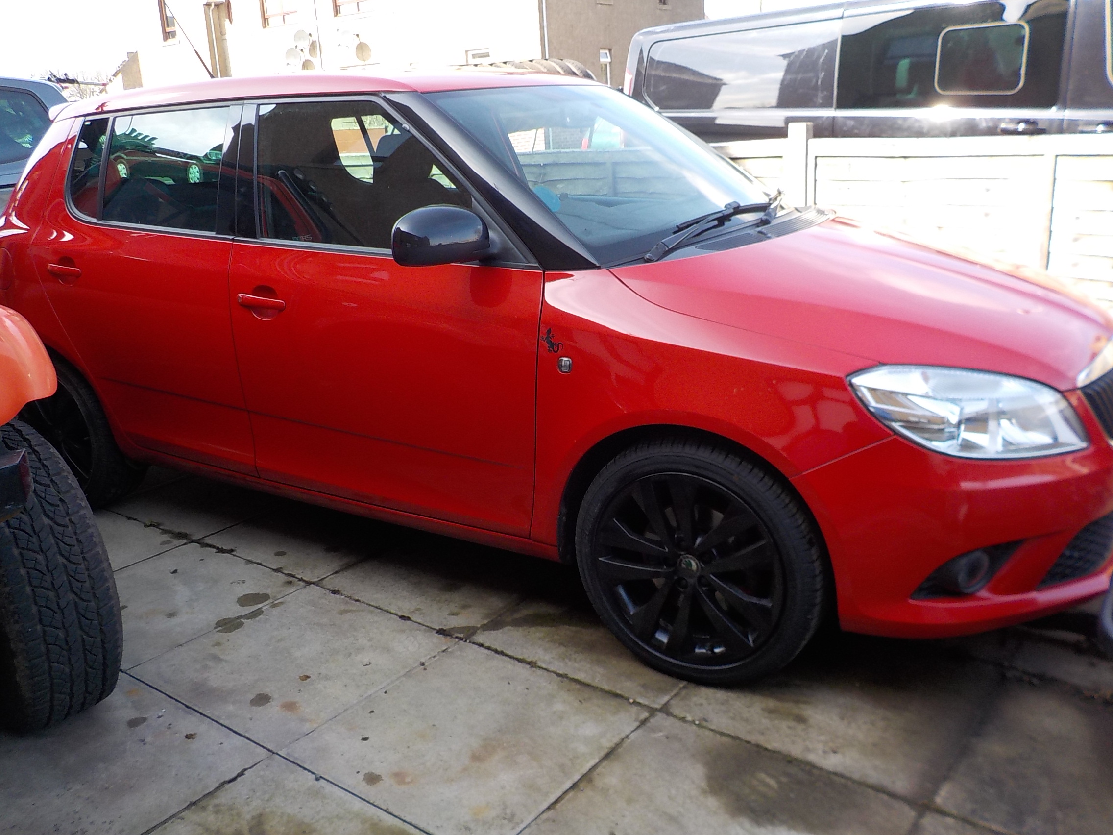

To go slightly OT again then, i fit Dunlop Sport Maxx 17's in the warm weather because i get them cheap because Skoda when cars had Pulling Left issues because of bad alignment from the Factory they approved fitting Pirelli Zero Nero because these hard sidewalls and non directional tyres disguised the cause.
Good tyres IMO for spirited driving in the dry, but the sidewalls can be easily damaged, you need to watch the inside sidewall, and they can go out of shape on the rear.

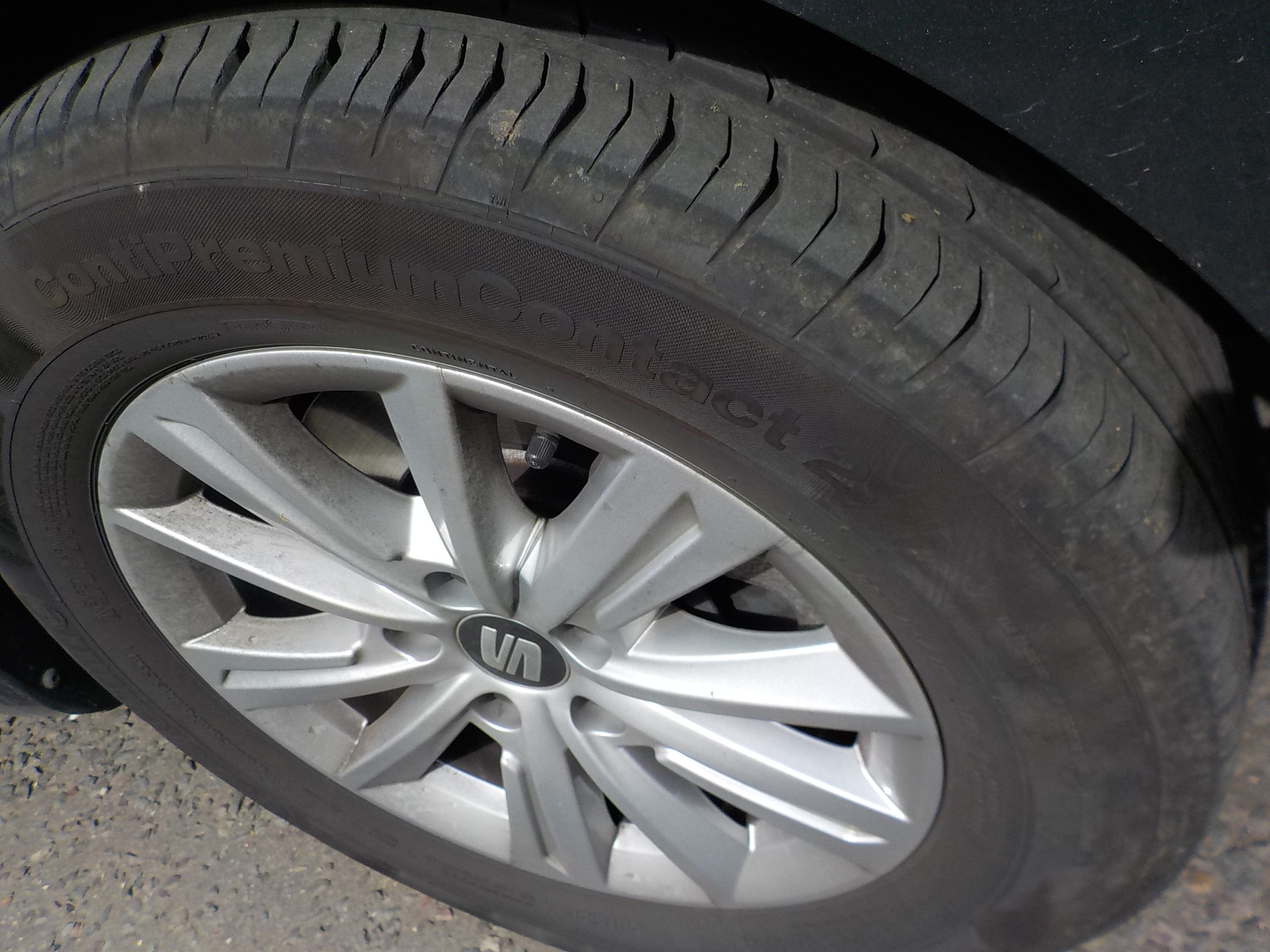

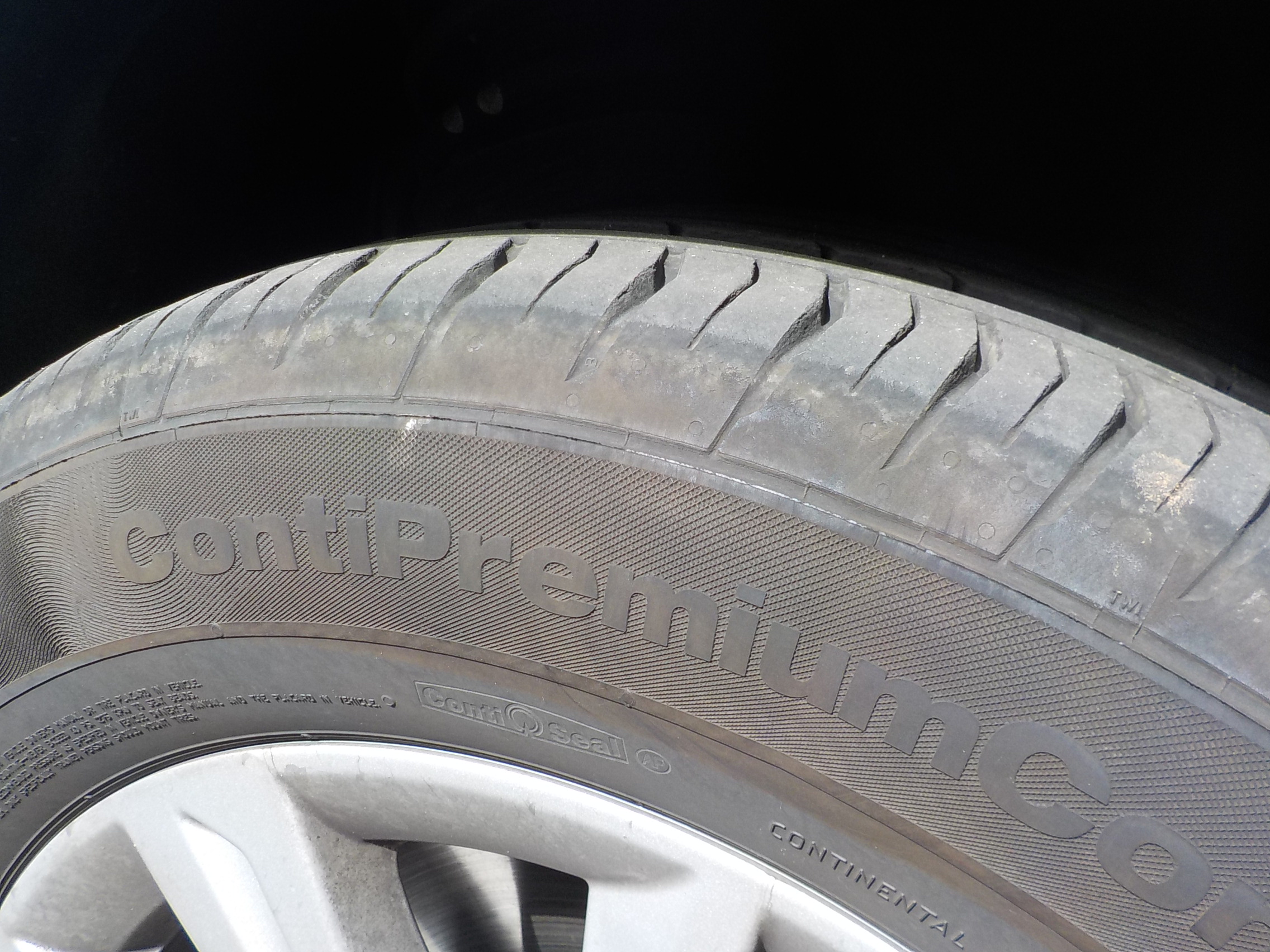

My daily drive has Continental Premium Contact 2 ContiSeal which i thought were dire when i first got them but turned out to be great over this winter in the wet and cold. Good comfort as well, but then the ones i have have a big sidewall in 215/60 R16.
(needed to get 2 spares to carry for going to areas where a wrecked tyre would be an issue, so i got a pair of Winters.)
