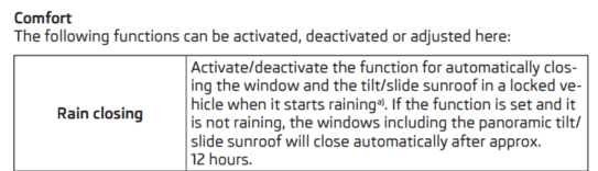

Basically:
- The sunroof and windows will close if the rain sensor detects rain while the car is off and locked.
- This detection starts within about 5 minutes of the car being locked.
- If after 12 hours, the windows and sunroof are still open, even if no rain has been detected, the sunroof and windows will close.
- The closing of the sunroof sliding panel (automatically) will also close the sunscreen.
Someone else may need to check me on the "off and locked".  As I park my car outside, it's never unlocked.  Someone who leaves their car inside a garage unlocked might comment that it still closes.
It was on page 27 of the manual, where it talks about the menu settings.  Not the most logical place.  I'm one of those weirdos who read the manuals from cover to cover.

11 hours ago, wokwon said:
Basically:

Yes, see the line in my response:
"- The closing of the sunroof sliding panel (automatically) will also close the sunscreen."
The same triggers to close the sunroof glass sliding panel (i.e. rain, 12 hours) will close the sunscreen/sunblind.  There is no built-in way in the CECM to automatically close the sunscreen/sunblind on locking the car.  It will close 12 hours after the car has been locked.
@wokwon, that's it!  It's the 12 hour thing that closes the roof, or sometimes it closes in a shorter time if I've parked somewhere outside and there's been any moisture on the windscreen.
