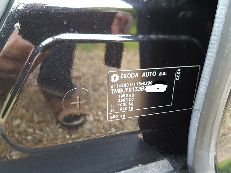

Pics below: Axle loading on Vin match the manual tech supplement for the NON N1 ratings (why they list both not sure).

The sticker is only a partial list of PR codes as the full list won't fit. A friendly dealer should be able to provide a full list otherwise you can use erwin to get it but you'll need to pay.
I would probably stick to the estate springs even if the maximums is much greater that yours. After all, it is a maximum rather than a minimum. You could always ring Blistein to confirm?
