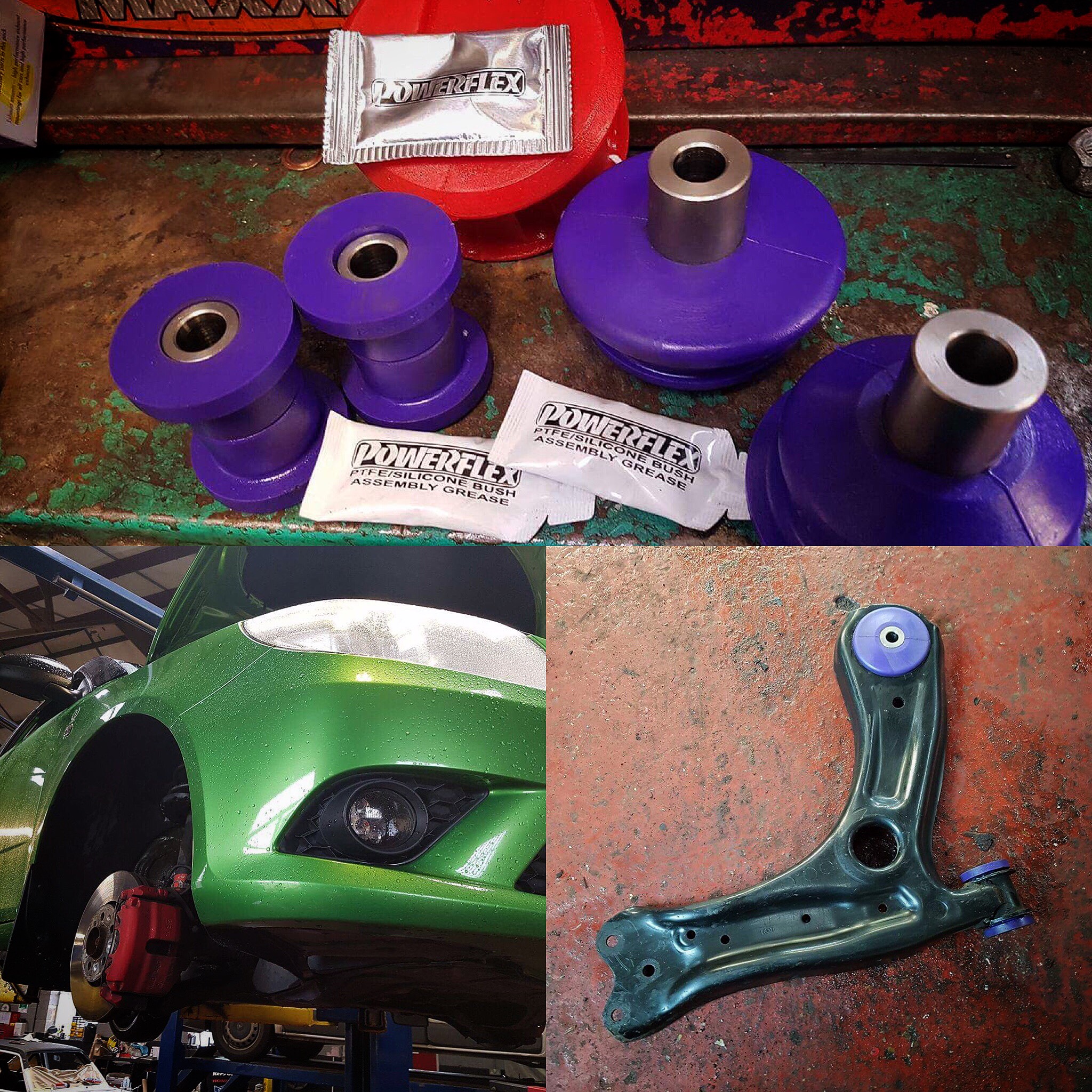

So the car is booked in to get the front bushes changed for Powerflex, and a service.
Also having the engine mount one done too, so we shall see what difference it makes.

So the bushes are getting done on Thursday!
Hope it sorts the front end out once and for all.
Its had shockers, top mounts, and these are all that's left to tighten it up!

So the cars been dropped off and I can't wait to get it back....
Let us know what you think once all fitted
Matty
Very good!
Tightened everything up a treat, and I put some Mondeo drop links on too, and that's sorted the crashy feel of the H&R Springs too.
Highly recommend the bushes to anyone though.

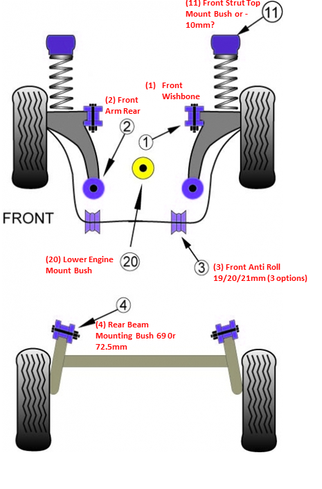

Hi All, If im getting AP coilovers approx 35mm lowering, which bushes to update below, unsure of sizes as well, ive copied the info onto the powerflex diagram. Car is 7 years old now but can only really afford to update 2 types of bushes (4 in total) + the cost of coilovers + cost of fitting, I want to reduce the body roll slightly. (I realise a RARB to go with would be best handling solution as well but will add this at later date) Hoping for track day next year !
https://www.powerflex.co.uk/road-series/products/Fabia+5J+(2008-)-2783/1.html
11) Front strut is 2 options... - 10mm?
3) Anti Roll is 3 options 19/20/21mm
4) Rear Beam is 2 options 69 or 72.5mm?
