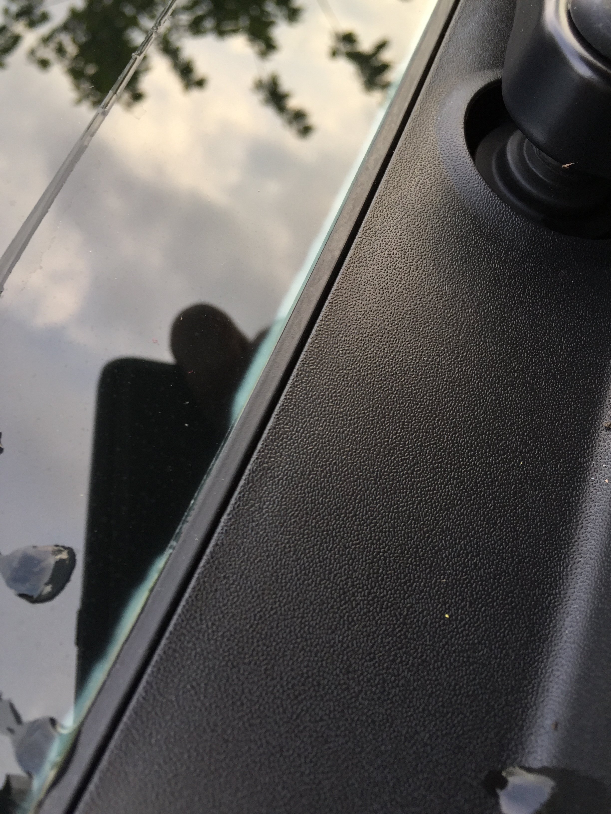

Cleaned the car last night, and noticed this along the bottom edge of the windscreen....it runs almost the entire length of the bottom edge, but not entirely.
Looks like a poorly fitted windscreen to me, with the white / milky edge showing water ingress.
The car's not yet 2 months old (well, that's when I collected it, but it could have been sat in a yard for 2-3 months!).
Views / thoughts, before I trudge over to see my dealer?
Thanks.

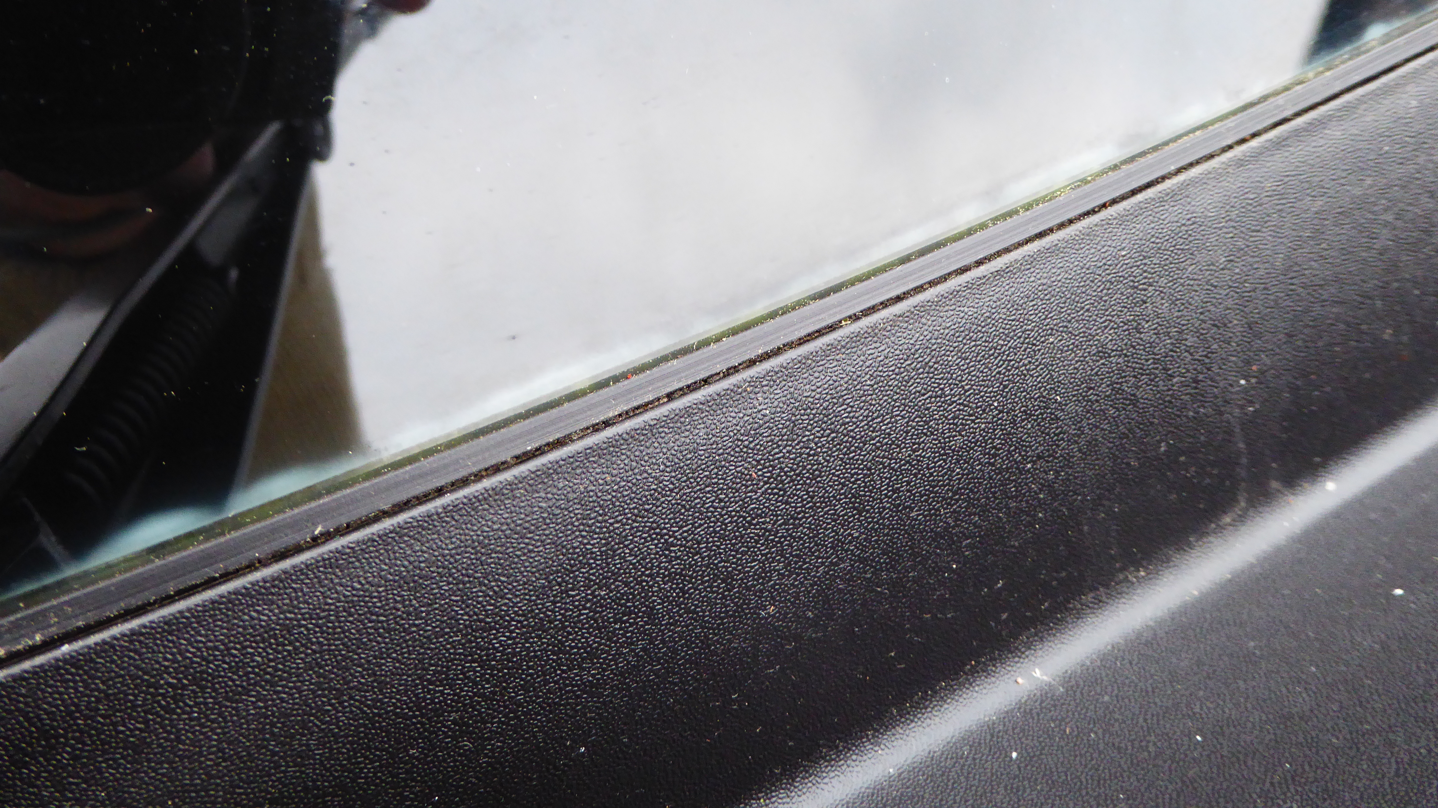

This is mine,runs for about 12"/14" drivers side, rest is okay. I wonder if anyone else has similar, is it as common as the 'rattle':D
Wow...!

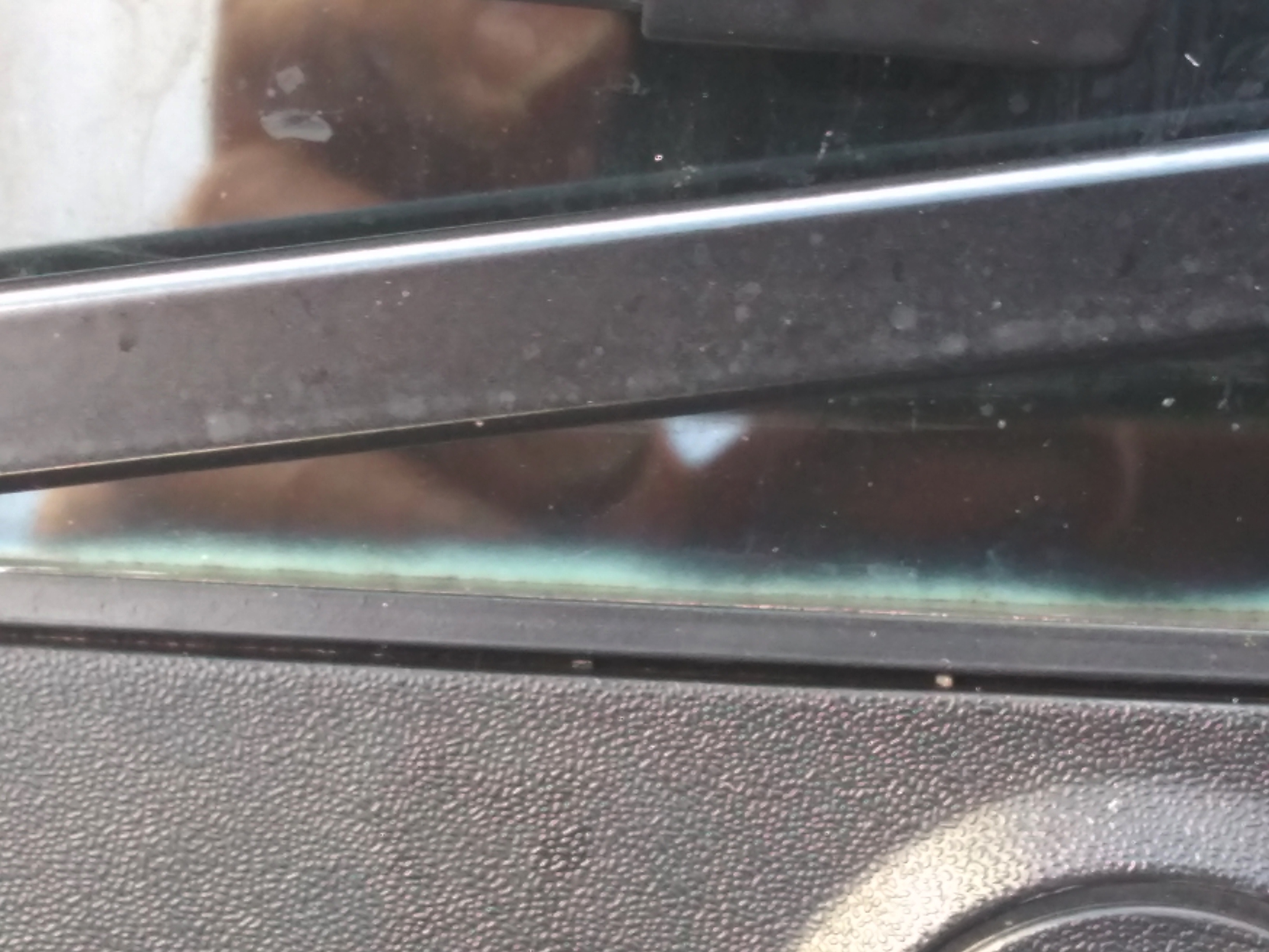

Oh dear....it's gone again....
Waiting a call back from the dealer...
Clear signs of delamination along bottom edge of screen...
