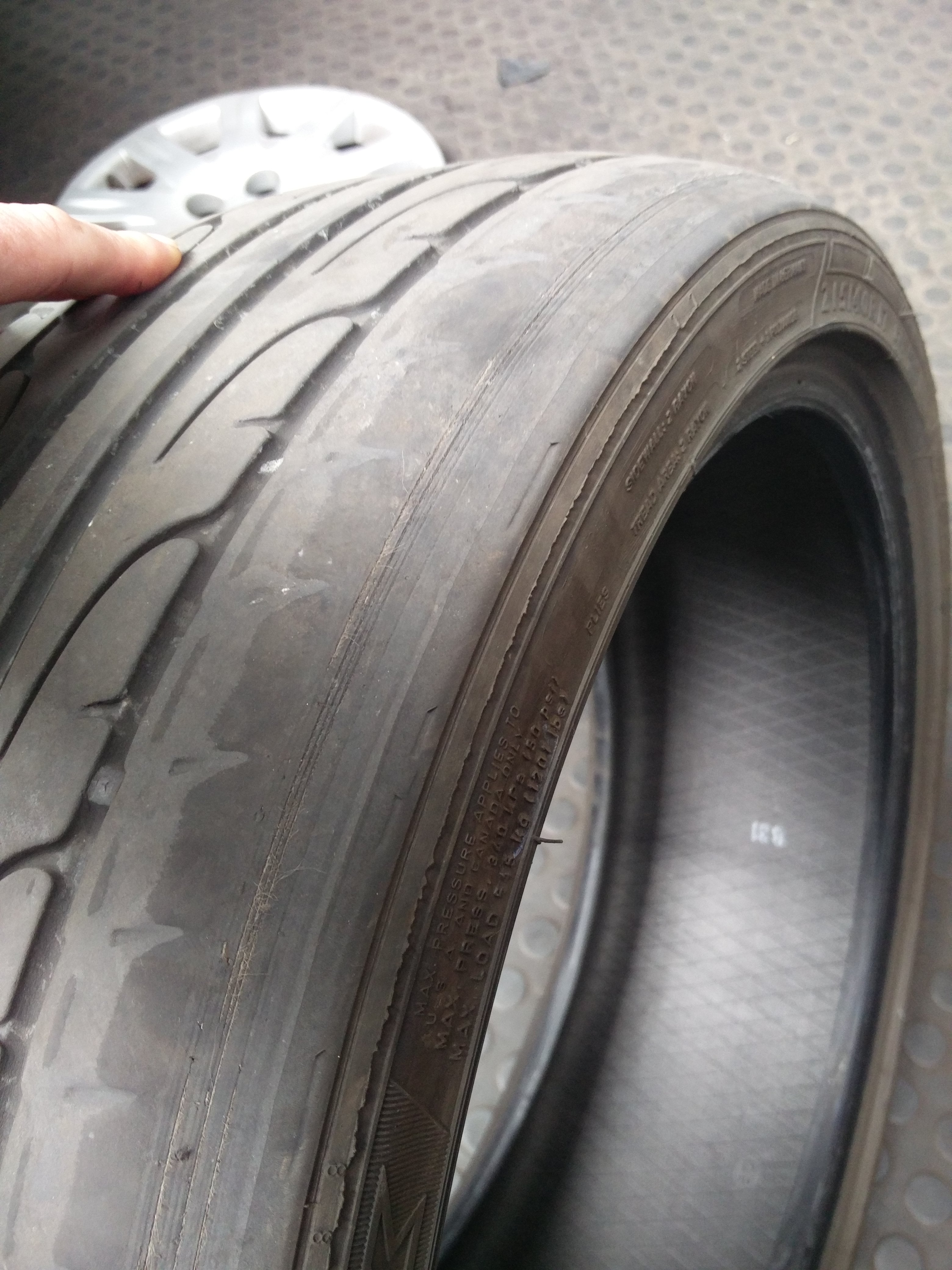

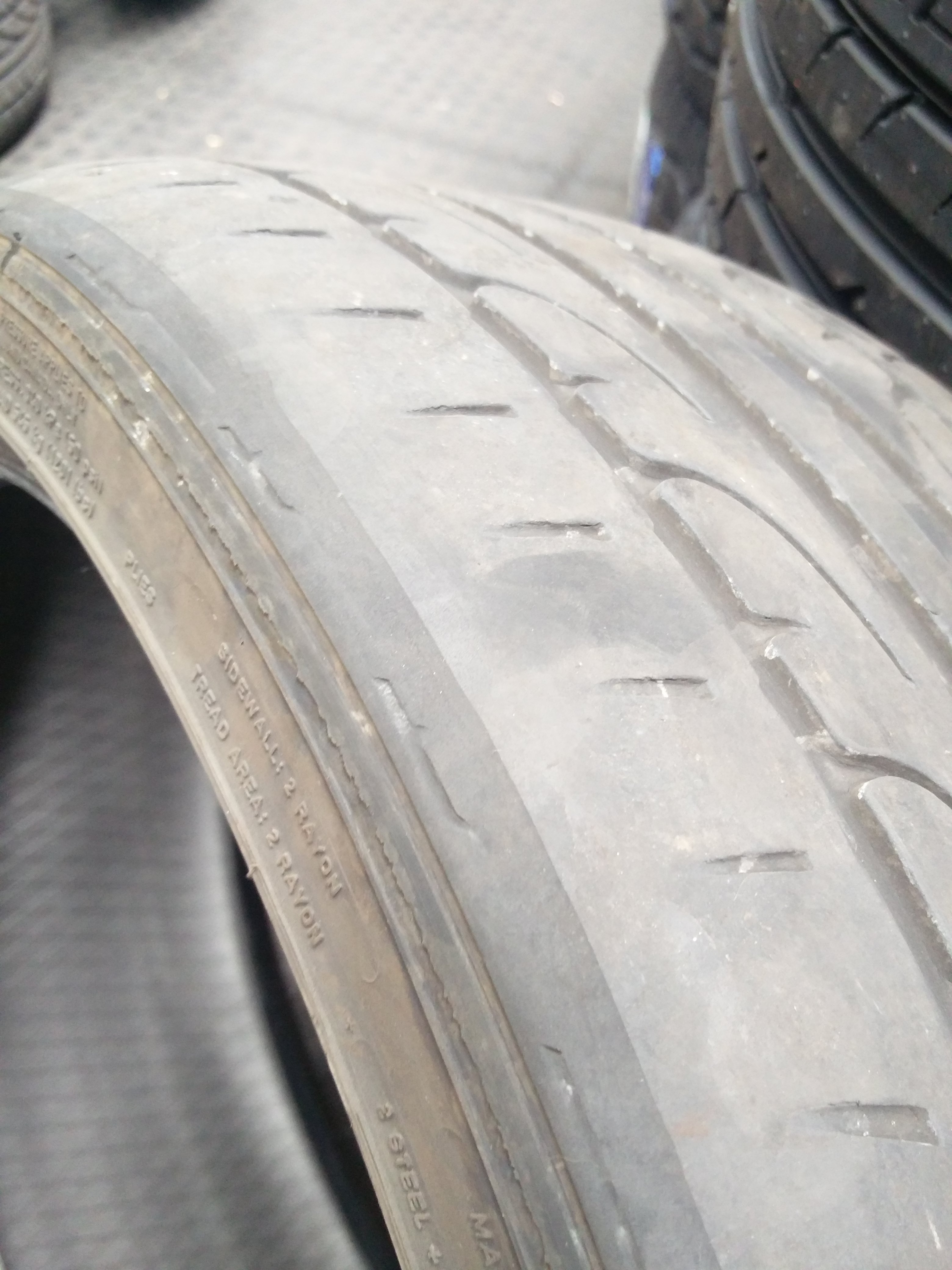

So, I'm running 17" OEM wheels and tyres... had them on for 12 months if that... had an MOT end of march with no mention of tyres... today I get my tracking checked and leave with two new tyres!
IMG_20170505_142842.thumb.jpg.a0c795d439434322894963bb4639b86e.jpgIMG_20170505_142922.thumb.jpg.3d6a4d15290cd213e0fb0d6d71100b4d.jpgIMG_20170505_142939.thumb.jpg.f2acaf845e44ff146987f8fdcdae8a5b.jpg
Ouch. My 17's have done 30000 with only one rotation so far.  Does yours have alignment issues with the lowered suspension?
The last tyres wore in a similar way, no quite as quickly.

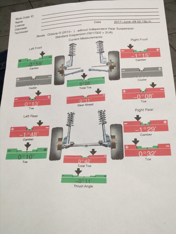

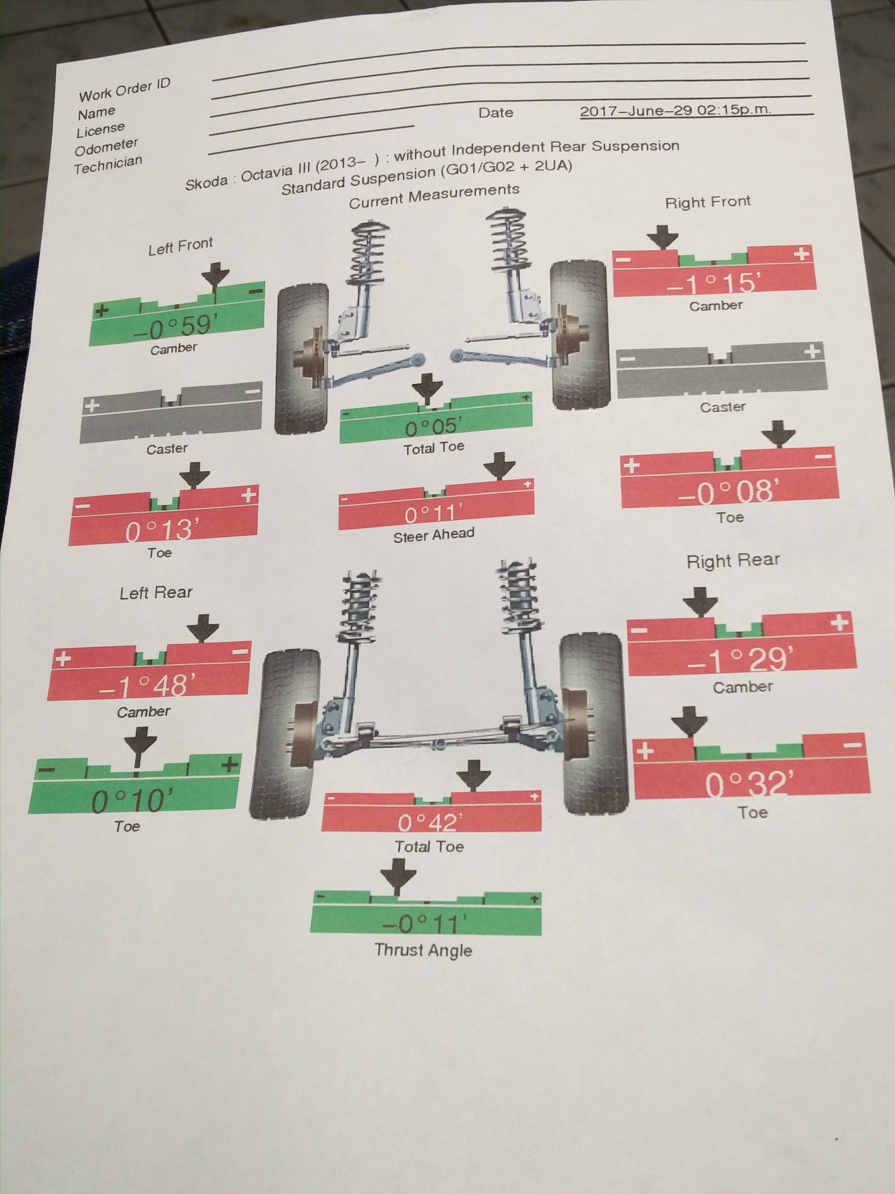

So having had the tyres changed and rotated and the tracking done just over a month ago, I thought I better get the alignment checked... Took your advice and went to a hunter alignment (formula 1 Cheltenham)... Here's the result:
Apparently the rear is fixed and not adjustable in the slightest :(
The wheel aligment form you posted is for an octivia as per the text... The settings will be different or is that free form text??
I picked up on that to, they tell me it's the same for both...?

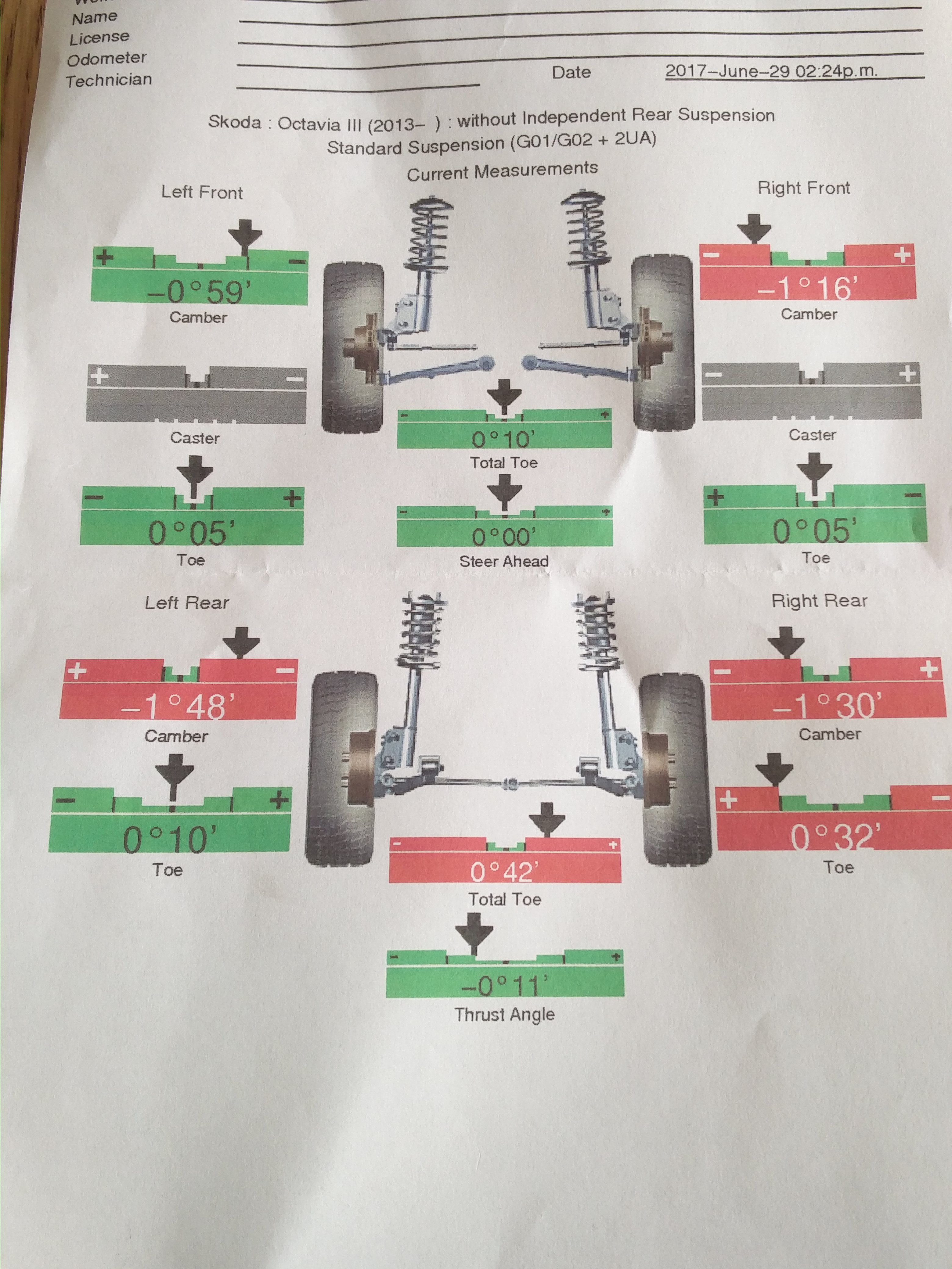

And here is the after...
Still looks very red...
Good job you changed them, you might have got a ticket as they look dangerous. One looks much worse than the other.
Yeah, it really surprised me as I'd only had the MOT in march! May the tyres and alignment and now end of June alignment again :(

Erwin has detailed alignment geometry data for Octy2&3 (Section 44), but the Rapid (Section 44) download I have has no geometry data.
Anyone have geometry data to share?
I've lowered cars in the past and had to use either adjustable strut top mounts or modified lower control arms to avoid consuming tyres at a fast rate.
For the rear it was usually washers or shims between the stub axle and beam.
Front suspension is like Polo 6R , so it may be possible to fit Polo 6R camber adjusting top strut mounts (which do exist).
Rear suspension looks like Golf Mk4, and I've seen Golf owners adjust the rear geometry using shim plates or washers between the stub axle and axle beam. (for camber and toe change)
