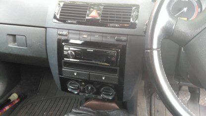

Hi There
Got one for sale. Kenwood KDC-BT73 DAB. It's currently working in my Fabia but I'm selling it as I'm getting a Yeti in 2 weeks. Dead easy to fit and I use a windscreen mounted aerial that came with it. Had hardly any drop outs

Sorry Chip, I've only just seen your post. What sort of price are you looking for it? I'm tempted to buy a refurbished Pure Dab for £60 off ebay, but if yours is in good nick........will it come with all the surround, wiring and aerial etc? Many thanks :-)

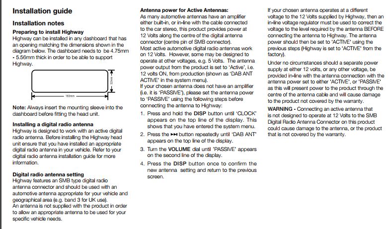

Just revisiting this topic and I was wondering what's meant by "Use the blue wire as your power source for the aerial, this will ensure the DAB aerial receives necessary power."? Many thanks :)
DAB aerials require power to work properly. You typically have a ground connection (windscreen aerials use the frame of the car for this) and another wire that requires connection to the positive somewhere.
Most radios have a blue wire that is used to power an electric aerial, so that an aerial can be extended to listen to the radio and retracted when the radio is turned off. This wire is ideal for powering the DAB aerial.

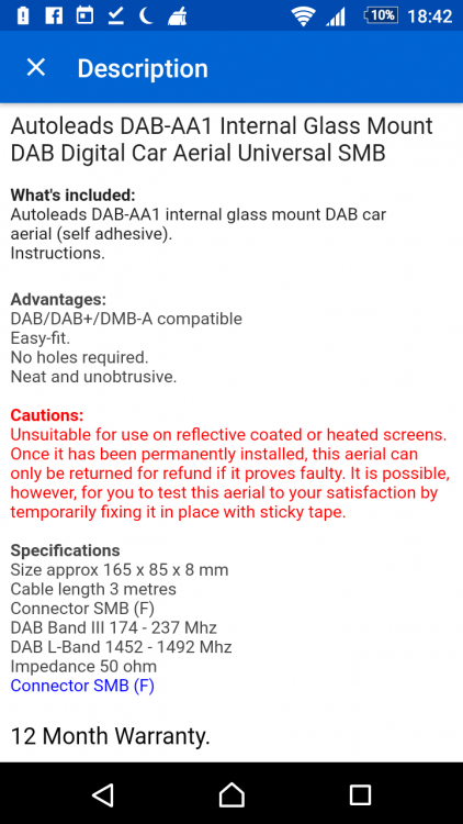

Thanks Duck. Sadly, it looks like the aerial that you posted about won't fit my new headunit. Maplin list it as 'Kenwood only'
Here's the connection that mine has (SMB) Any suggestions on a good aerial? And can anyone make sense of the guff in the Pure manual?

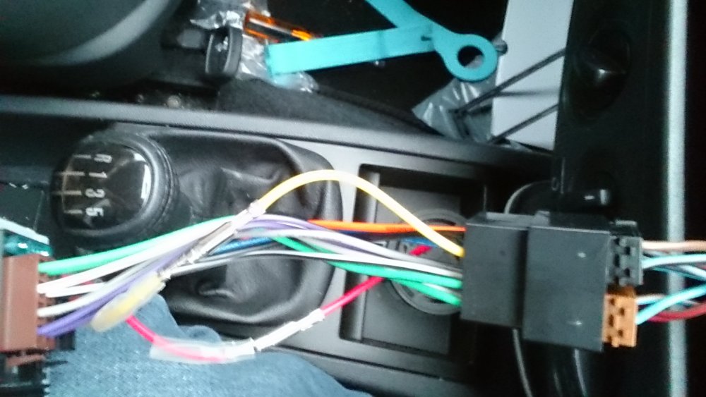

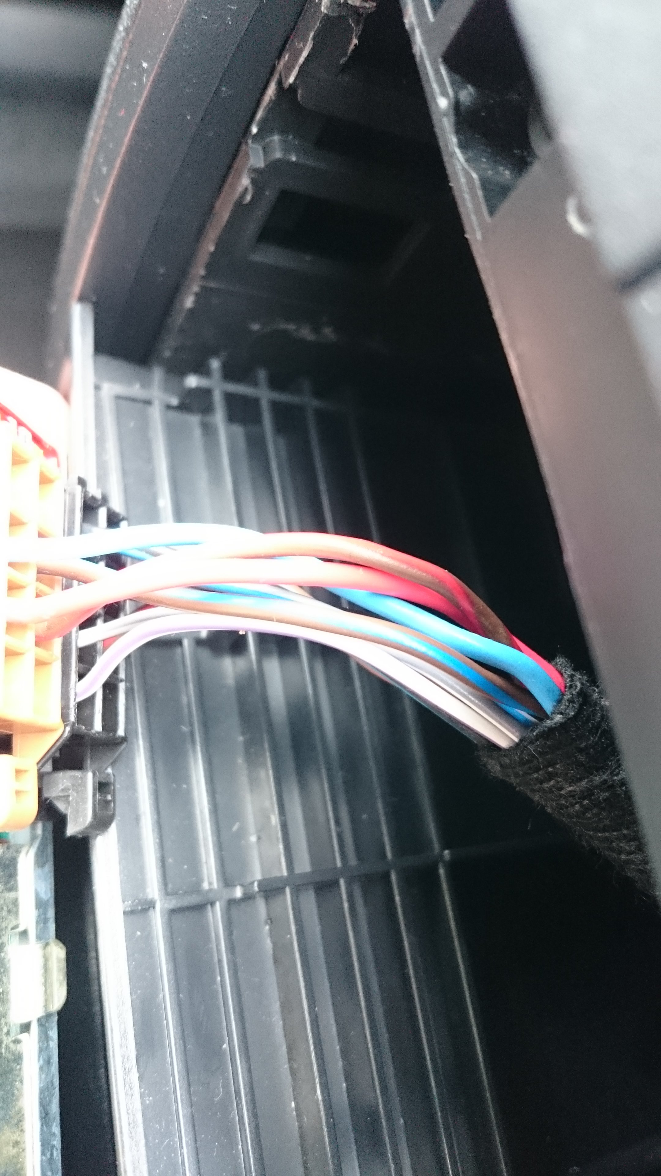

Also, I took a picture of the wiring coming out the back of my standard headunit - which blue wire do you splice the power into from the windscreen antenna? (Sorry for the duff picture)
