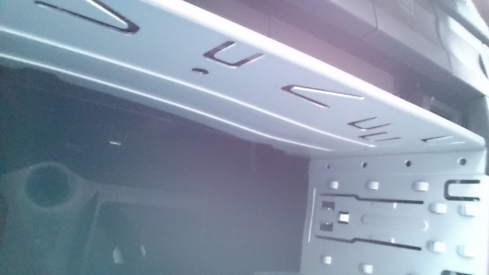

The cage for the radio was a complete PITA to get into the dashboard. I even took out the cubby hole beneath it and removed the glovebox and the heater vents for more space! It now seems to be flush (after clipping some of the plastic off the inside part of the cubby hole at the back, but none of the metal tabs on it really line up. due to the internals of the stereo slot, any suggestions? (Picture enclosed)

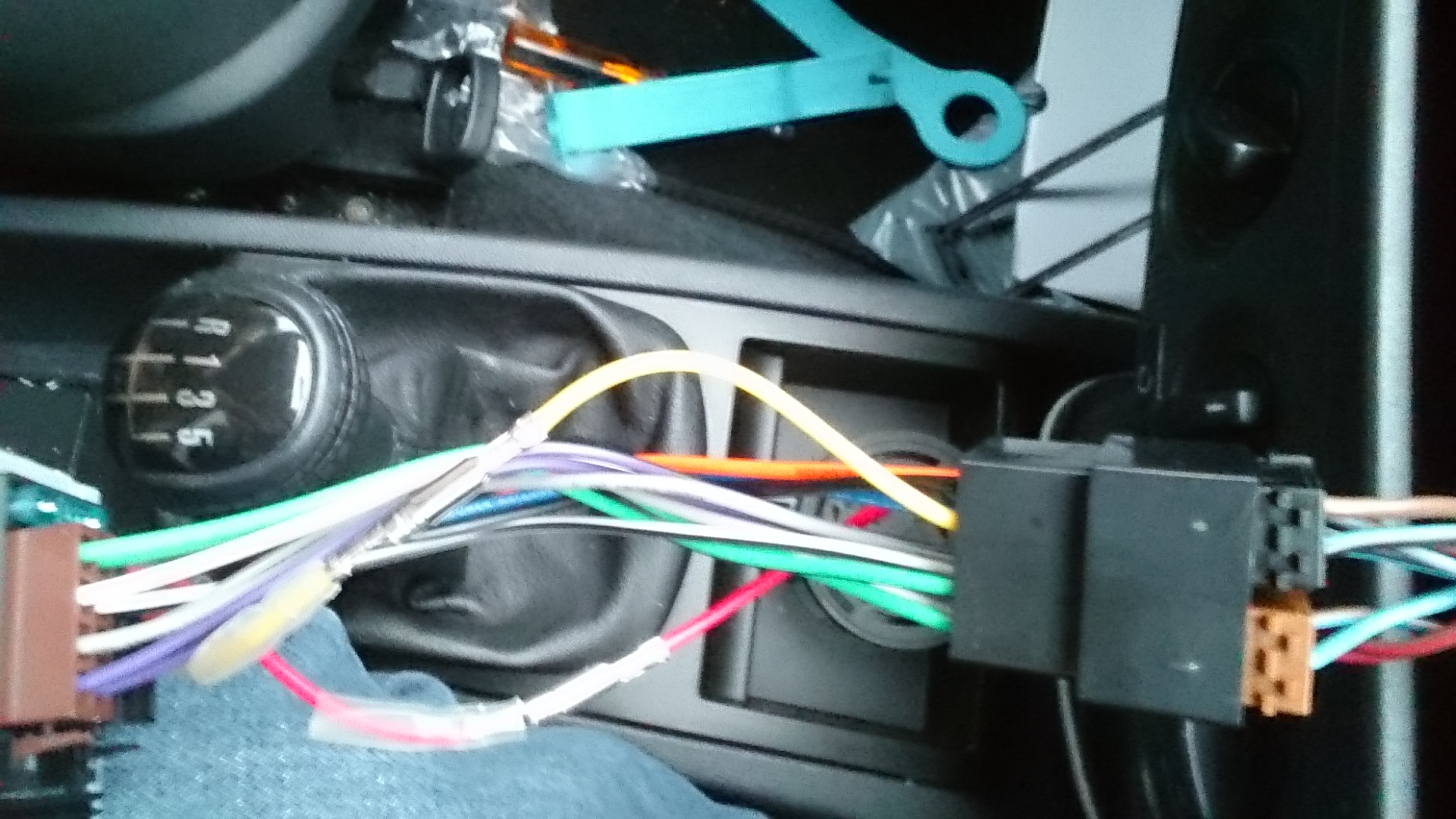

And on the wiring front - I've managed to plumb everything in, but I read somewhere that you have to reverse/rewire the yellow bullet connectors, or else your battery could run flat? Is this correct? Do you just crimp them together, as well?  (picture enclosed)

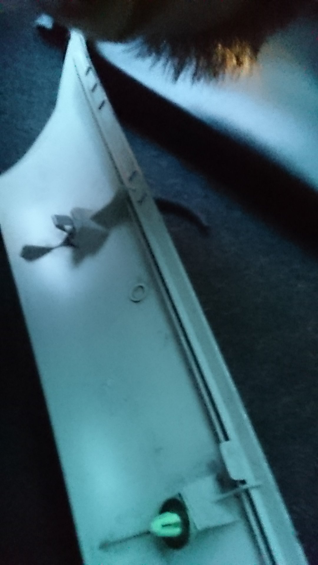

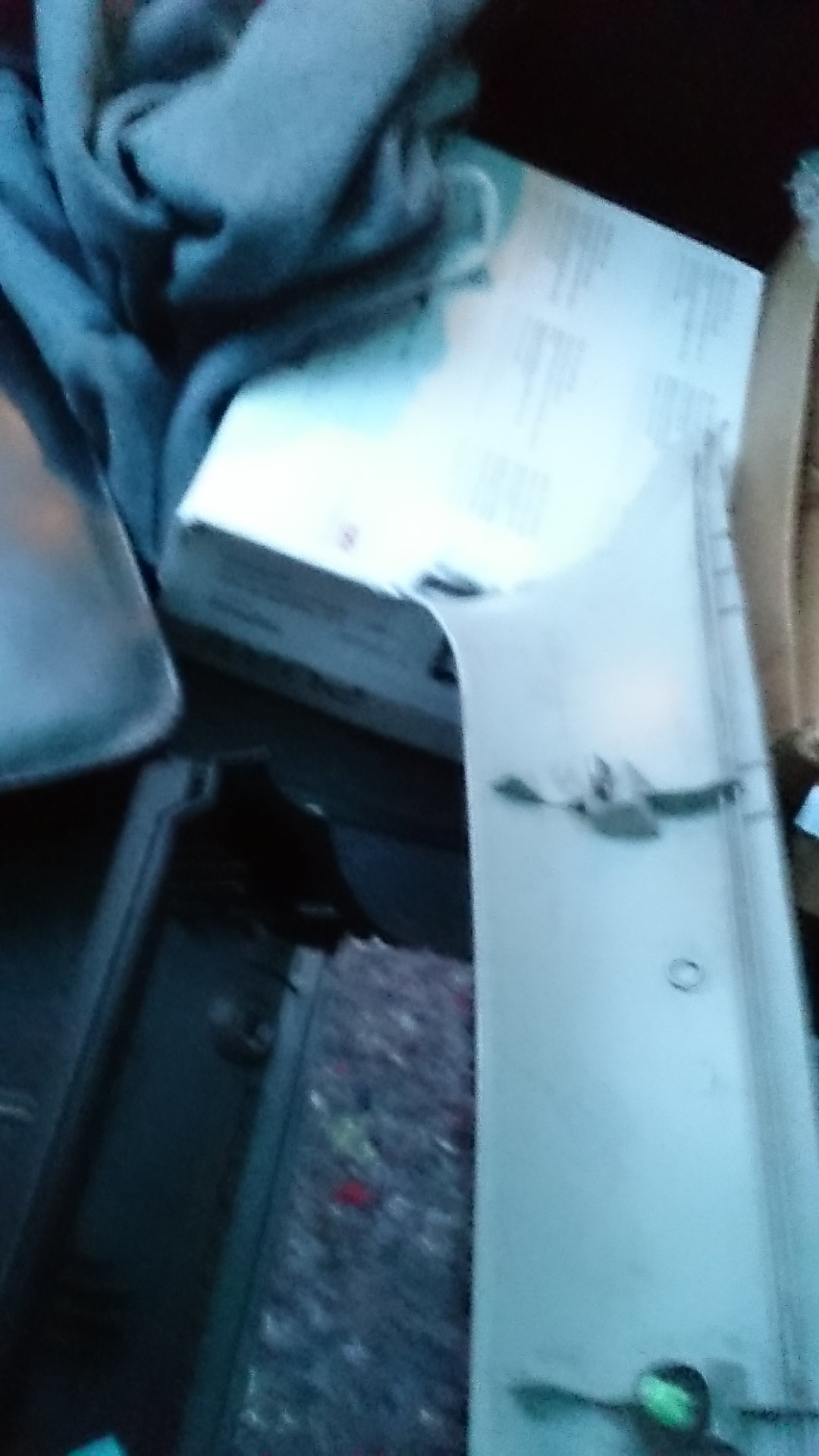

Also, where can I get a metal clip for my A-pillar, as I've lost one - can I use one of the plastic clips that secure the door cards as a replacement? (picture enclosed)

The green door card clip won't work as it is meant to clip into a round hole.
Here are the metal ones on ebay http://www.ebay.co.uk/itm/10x-Audi-Boot-Tailgate-Lining-Metal-Trim-Panel-Clips-Metal-Interior-Trim-Clips-/371767234782?hash=item568f0dd0de:g:SYoAAOSw8w1YB08y
The red and yellow wires need swapping because the switched live and the perm live for the memory are the other way around for standard head units.
You don't have to bend the full tabs around on the cage. If you can just bend the ends of some of them it should hold it. Have you got the cage in far enough? I didn't have any problems when I did mine.

So with the bullet connectors, I just put yellow/red yellow/red instead of red/red etc? Do you just crimp them together?
You can just swap the bullet connectors if they're the same size or you can join the wires any way you want  - Scotchlok connectors, soldering, terminal blocks etc. The bullet connectors just push together.

There is a large gap at the bottom of the headunit and the cubby hole underneath - is this a common problem with aftermarket stereos? Would I need to file some more plastic off the inside of the cubby hole? (As it feels there's 'pressure' causing the cubby hole to bow slightly)
Many thanks ;)
I've already got one of them. I think something's bowing the top of the cubby hole, so there's a gap - I wonder if it's one of the plastic 'spines' that are part of the plastic moulding......
Oh right. Yes could be something like that.
Er, got in the car this morning, no presets! I did swap the red and yellow wires. Maybe the wrong way round, or to the wrong inputs?  Any ideas. Thanks :-)
You need to swap them back, that should fix the problem.

Thanks John. As the wires are now yellow/yellow and red/red, could I have problems with a flat battery? What are the bullet connectors for?
Also my locking tabs didn't lock, which was lucky because the removal keys don't engage, so I had to slide the unit back out. There's a gap around the facia so you can see the cage. Happy days #hireaprofessional

Not sure what you mean? Bullet connectors are just a means of joining wires.
Bullet connectors are designed to make it easy to swap the wires should your radio need them swapped.
Notice that you can only swap those wires that feature bullet connectors, swapping the other wires would stop the radio from working properly or send sound down the wrong speaker.

EDIT: I've got my new trim clips through the post today, so I'll give them a bash tomorrow (Thanks TMB) and I managed to get the head unit to sit better by popping the heater vents out with a trim puller and moving the wires around behind the back of the stereo. Just need to sort the removal keys and cubby hole fit and finish now  (Oh and stop my OSF tweeter buzzing in my ear!)

No, the point is to have a universal power cable as some cars provide the always on and ignition switch wires reversed for their stock radio. Some radios are wired that way, others use the standard wiring.
You know the difference when you turn the ignition and the radio starts and then remove the key to find the radio keeps playing or it forgets the presets, then you have to reverse the red and yellow wires.
