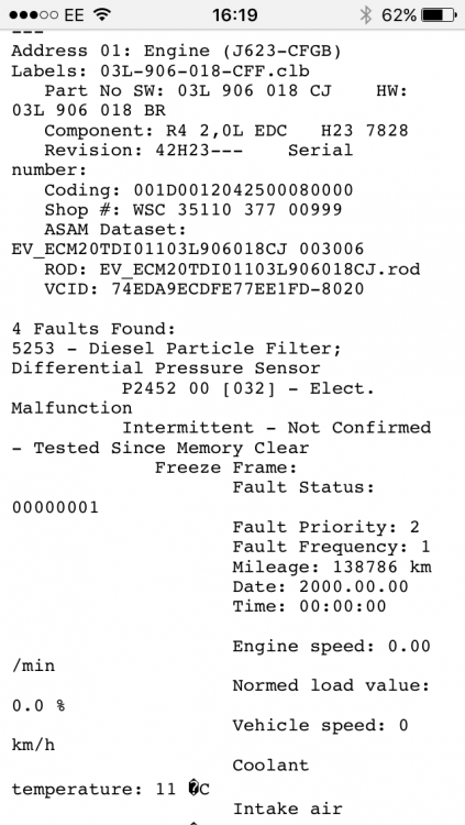

I now have some VCDS info thanks to cjb on forum here

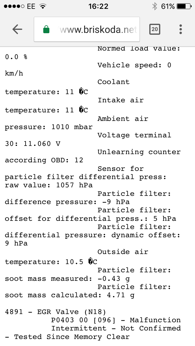

Attached is a subset of what is my first scan of the car.
Its on 87912k now. But the engine error km to miles converted in google was 86237 I don't think I was on that mileage when the glow plug light flashing issue occurred more like 87795. So if the conversion is right it happened early in my ownership though, but i have never seen any errors before.
Any ideas anyone ?

Seems like you have the well documented G450 sensor failure, a common issue and easily fixed...
Fault Code No.1: P2452...
http://wiki.ross-tech.com/wiki/index.php/18884/P2452/009298
Faulty sensors often result in other related faults, so I'd start with the G450 before looking at replacement EGR's or DPF's...
Fault Code No.2: P0403...
http://wiki.ross-tech.com/wiki/index.php/16787/P0403/001027

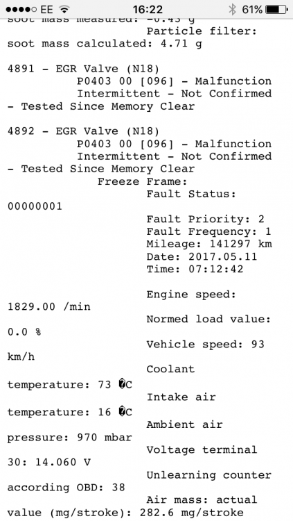

Other than insisting the DPF sensor is replaced. There is fears the EGR may need replacing based on that error recording on the day I had the limp/coil glow light problem. The time and date stamp on VCDS corresponds to glow plug light flashing. Where as the DPF sensor is a few k before, no date stamp.
Should I prepare myself for the EGR showing faults afterwards and is this something that I can check for in VCDS after a few hundred miles ?

Fix the problem you know you have and go from there. There's very little shared labour between DPF sensor replacement and EGR replacement. When the sensor is replaced, have the garage do a forced regen on the DPF to make sure it's cleared out.
EGR replacement is expensive because it's difficult to access, therefore the labour cost is high. The part itself is relatively cheap. There are also other reasons for the EGR system to display faults than a faulty EGR valve. Things like vacuum leaks, N18 solenoid issues, MAF sensor problems, etc.

Just reading back over your earlier posts, the N18 is the solenoid control valve
for the EGR, not the EGR valve itself. Possible causes are damaged valve, loss of vacuum (leaking lines usually), damaged wiring. It's an easy enough diagnosis/fix for someone who knows what they're doing.
