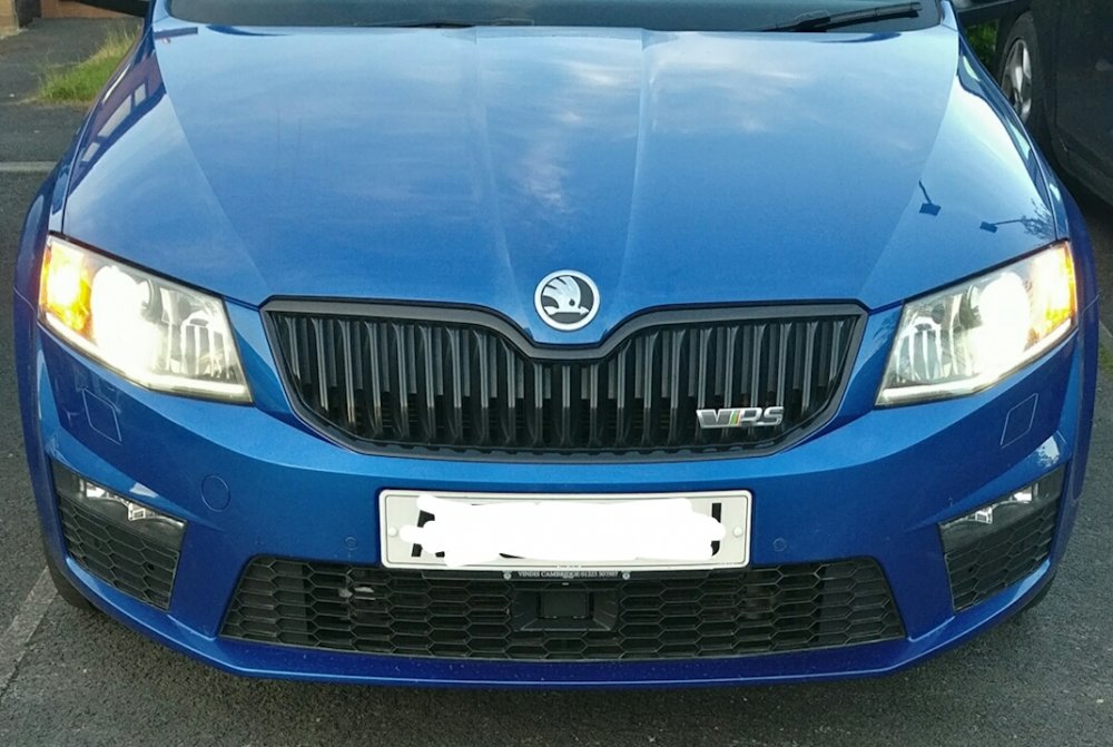

Thanks for that. I've just been back out and it doesn't look too bad for reflection compared to the original on the passenger side (right of image).
Those bulbs you got do look shorter which probably helps. Yours looked spot on from the video

I'm definitely happy with the bulbs. Fill out the reflector nicely, and don't give much of a fried egg look when off.
The removal of the orange fried egg look, and the instant on/off are definite pluses for the LEDs

A side by side of the original and the new LED:
And in action (left of image is LED, right halogen):
Happy with the result, they are brighter and maintain an amber colour. No fried egg effect in the headlamp when off either. Space was a bit tight behind the headlamps without removing the bumper or going via the wheel arches, but it is possible with the right tools :)
