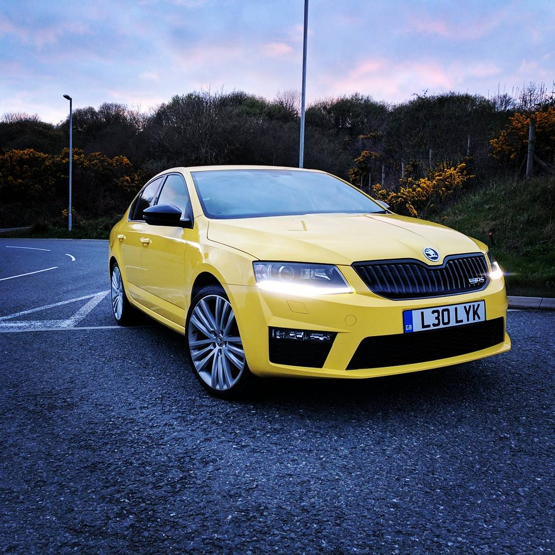

Hi. They would fit just fine. The difference in ET would mean they protrude 5mm further out that your wheels now.
They fit fine, been done already and look good IMHO:
See here:
