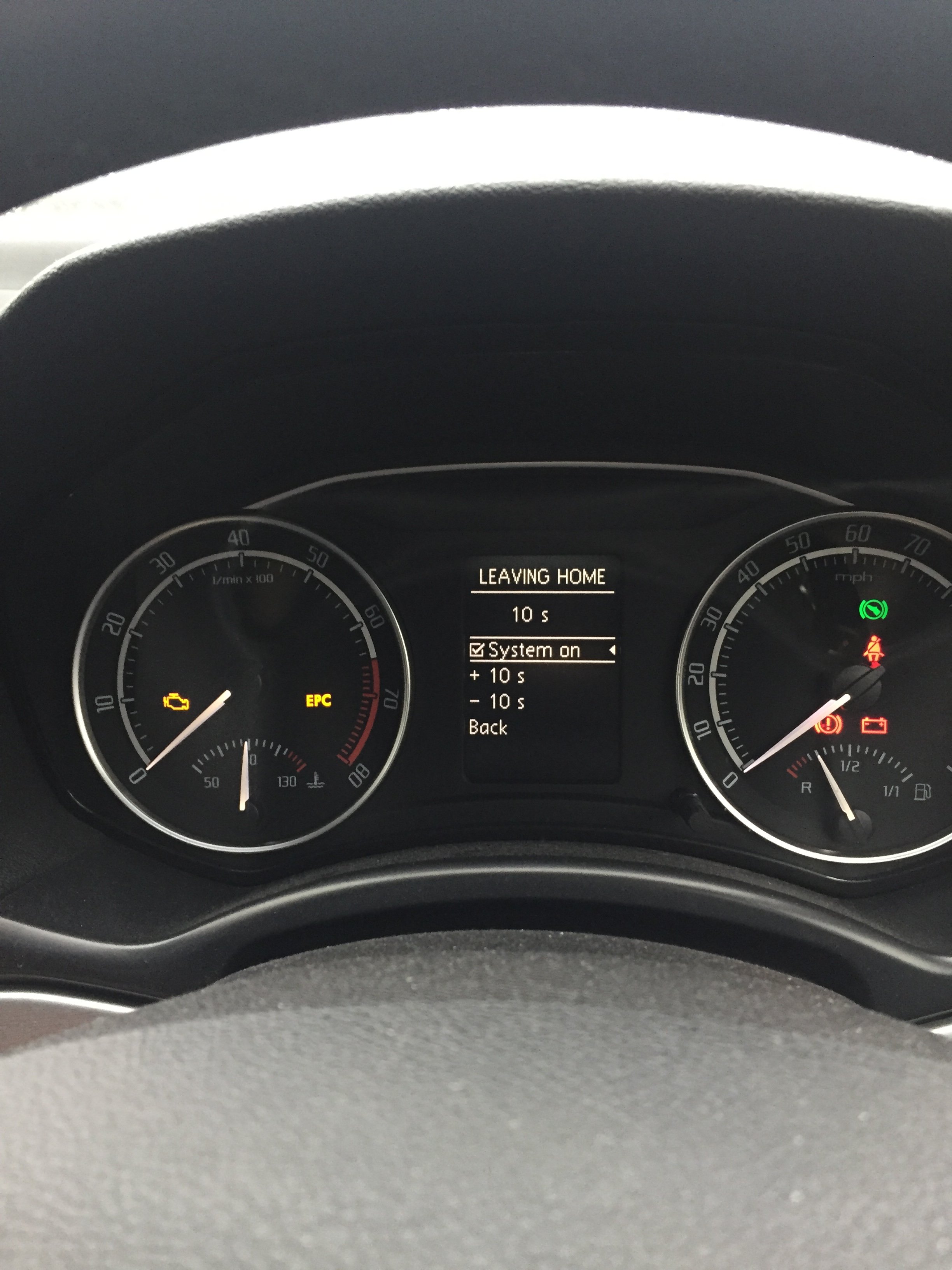

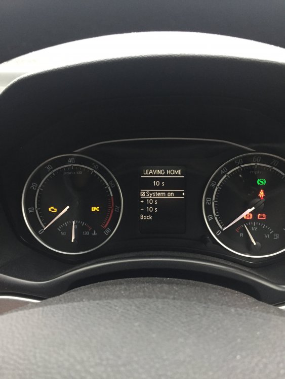

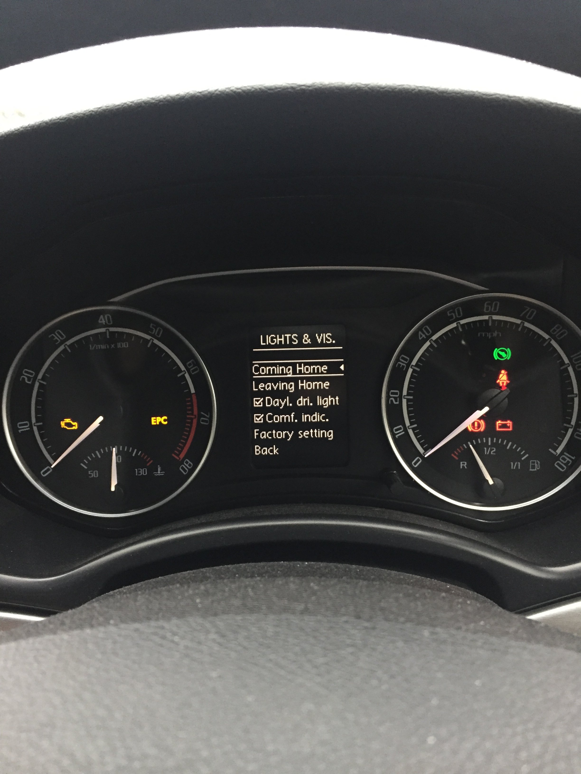

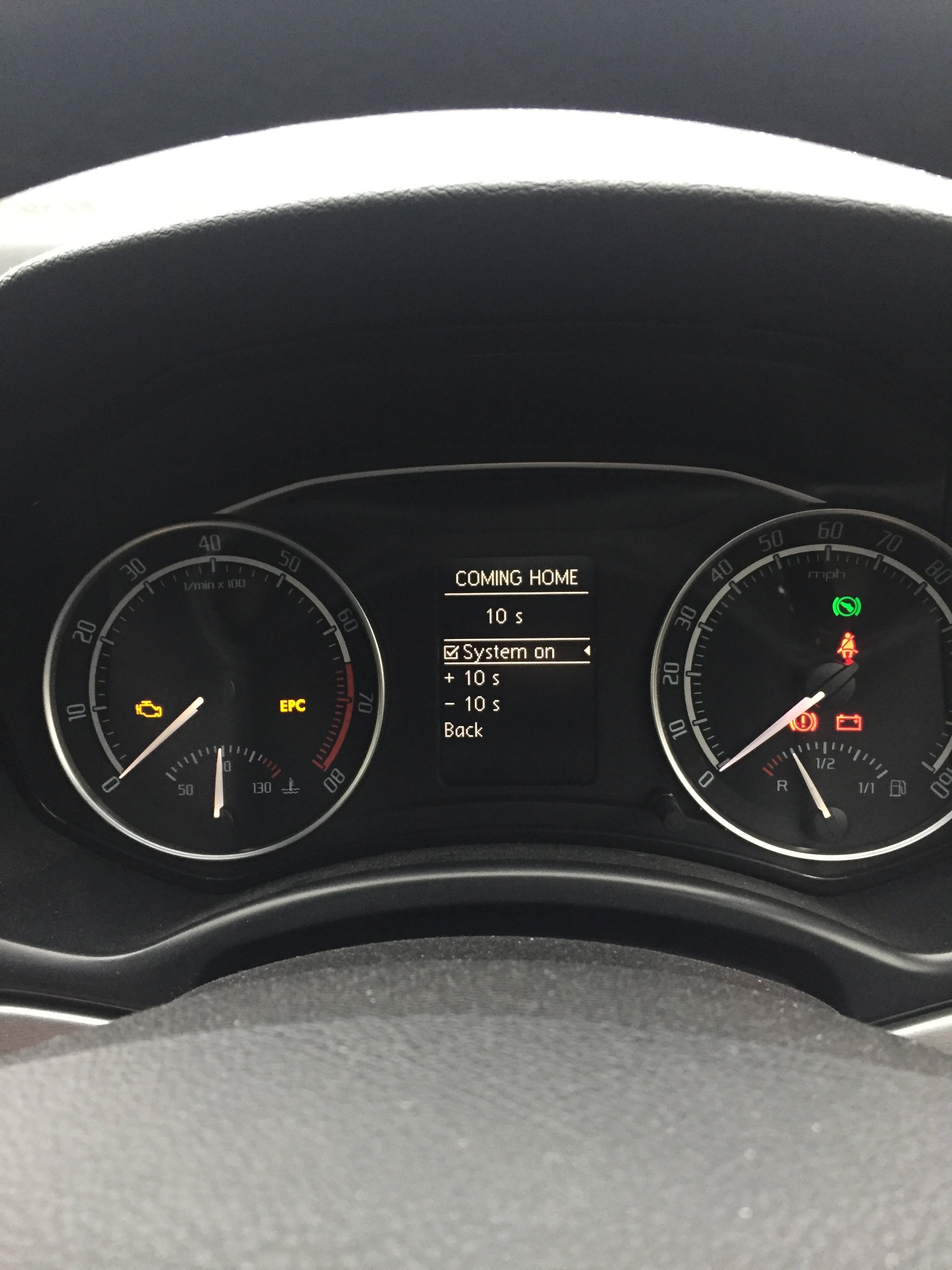

Hi,
Do you know why my c/l home lights aren't working?
Please advise
Thank you
Does the light switch need to be in auto ? (if you have auto lights )
Hi i have auto lights but from ebay with the sensor and they are working fine. Do you think this may be the issue?
Thanks
That would be the problem I would say. A stand alone aftermarket switch with sensor won't be integrated into any of the car's electronics modules so the car will not know if it is dark to activate ch / lh.
Maybe search any supplemental coding with VCDS that can be done and perhaps then it will be like factory's (embedded) functionality and thus could handle the c/l home lightning..
Yes, but you'd need an original auto switch, an original light sensor and possibly an extra wire per other posts on here for adding auto light functionality.
