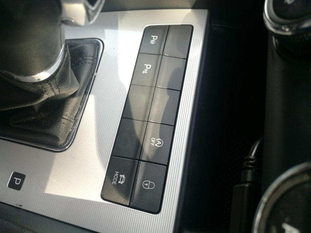

Hi skoda fans, maybe anyone fitted USB chargers in those slots and could show me what parts do I need and how to do it?

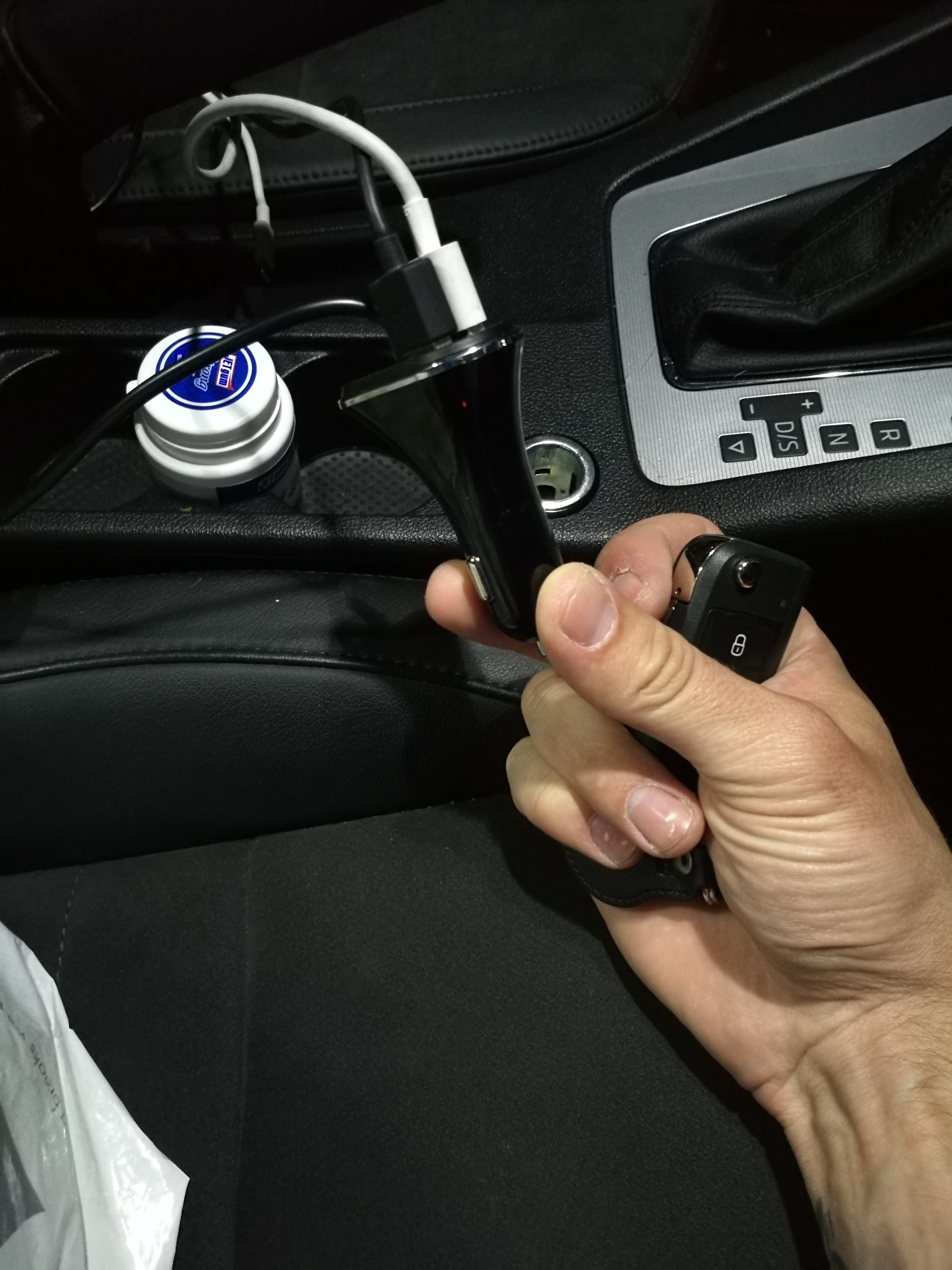

I order parts like all those above, original plan was same just to put in ashtray but yesterday I noticed that there isn't any space to make cable thru as it's Bluetooth box,so stuck with ideas..And to use that belkin in cigarette socket Is annoying as cigarette socket is pernament live,so don't want to all the time whichin on then off and hiding all cables

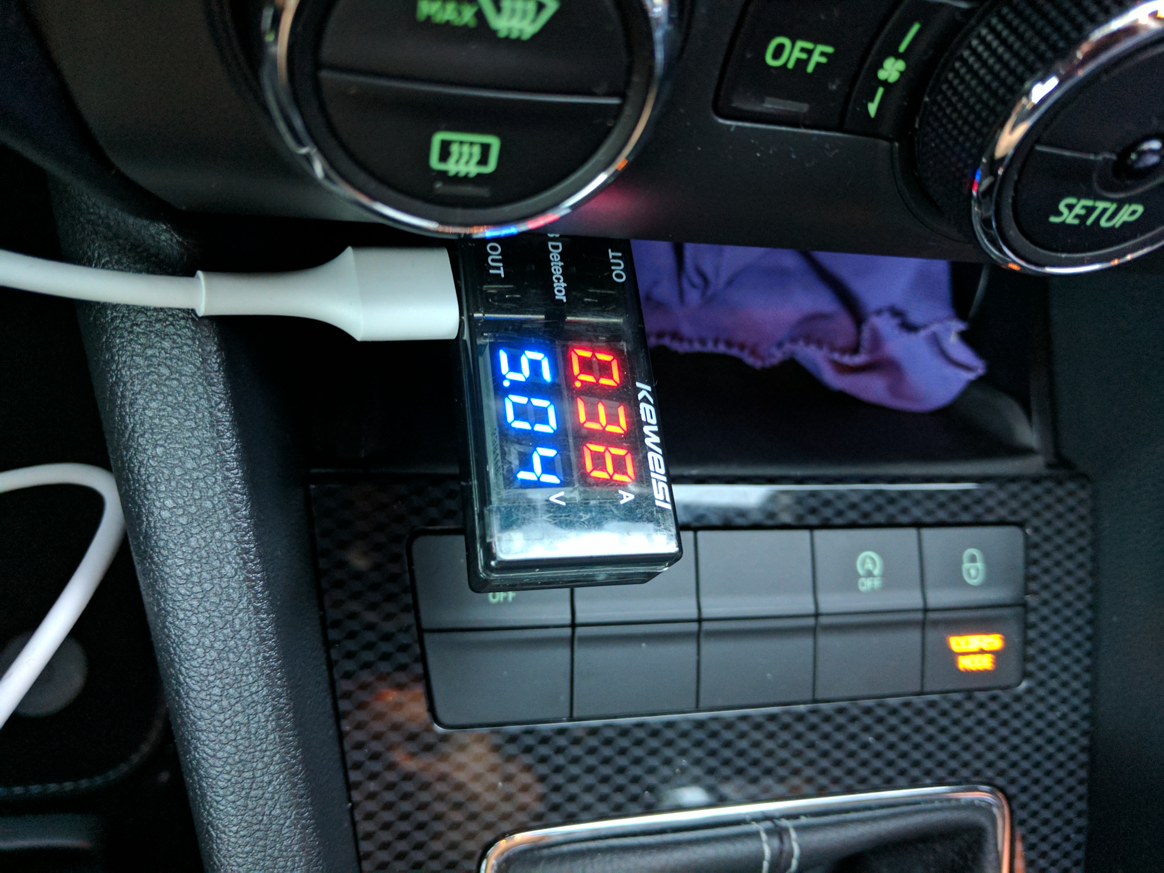

The USB socket in front of the gear lever is capable of charging my phone - if its not using too much power. Not sure how much it can deliver though.
What is the insurance situation on modifying electrics with piggyback fuse adapters?
Not much
And this is with a USB c cable cable on a quickcharge phone, so it can pull up to 3a.IMG_20170527_200043.jpg

I have this one, everything would be perfect if that 12v won't be pernament live as now all the time plug in and plug out its annoying
It is not very easy to fit anything to the empty buttons because the entire row is one mold with one connector.
Not entirely impossible, I'm fitting some on/off switches myself but it is rather time consuming job.

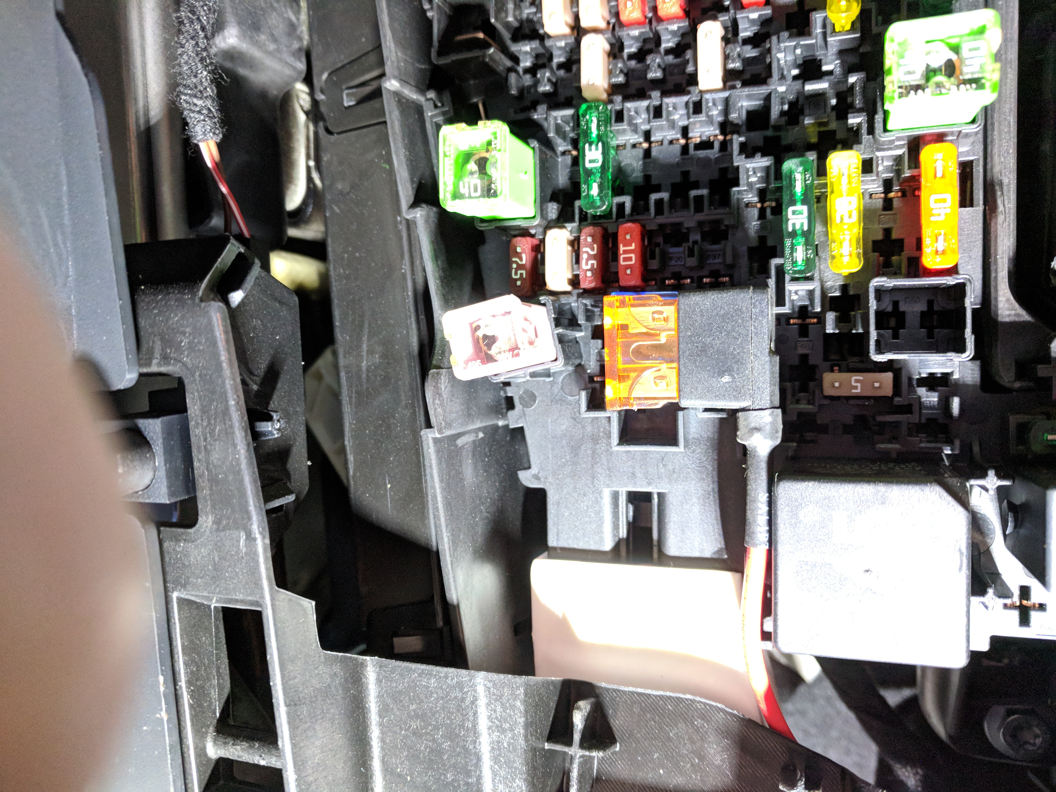

I'll second this as described above. I have this in my new FL Octavia SE L DSG Estate and had it in my previous one. Very easy to complete, the hardest part is getting the glove box back in place and the damper rod connected again. I took the fuse out of the position shown in the picture. (This is in the FL model) iirc this fuse position is the rear  wiper fuse) then position the 12v socket extension to the drivers side cubby. (My 12v extension has 3 12v sockets and 2 usb sockets) it is cable ties in place after I removed the cubby and drilled a couple of small holes to pass the cable ties through and it is used for the dash cam and a usb charging lead for my work mobile.
you can easily mod the cigarette plug to switch with the ignition, far easier than cutting a hole in a blank.
