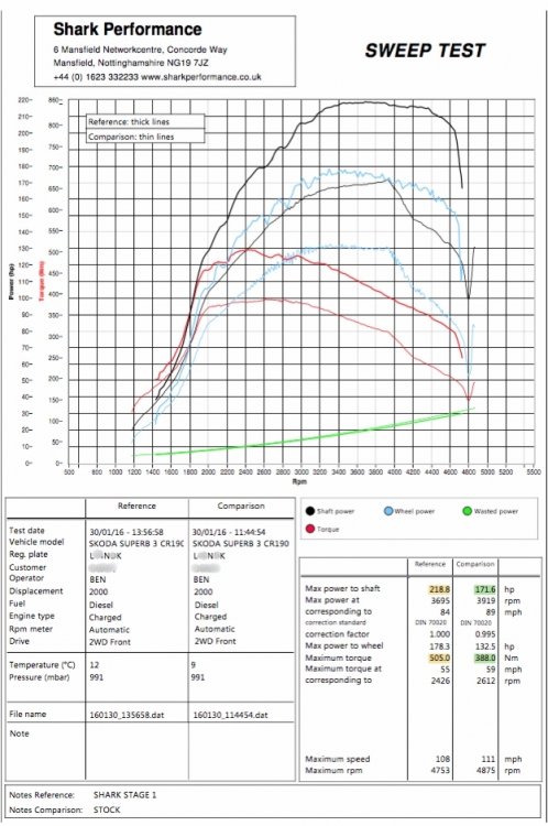

Here you go:
190 TDi Superb (same engine) which produced ‘just’ 171.6 BHP as std, remapped to 218.8 BHP, the injectors were holding it back from producing more power.
= 28.8 BHP increase over what it should have left the factory with, but in reality it actually meant a 47 BHP increase.
OWEN_SUPERB_CR190_STG1_220.pdf

If you look at the correction factors, you will see that the remap has a correction factor 1, while stock has 0.995, if you count that in you get the stock values of about 182HP and 395Nm torque. This is due to the transmission. The Superb III has a DQ250 DSG with max 400Nm limit, while Kodiaq has a DQ500 with 600Nm limit. This is why in Superb, the CPU limits engine performance far more, because the engine specs and the clutch limits are the same. So the engine is the same 2.0TDI 190, while you will never get the max torque/power because of the CPU limitator to safeguard your clutch-pack.

Now here is the problem. There is only one possible answer:
a ) You did change the clutch-pack and the dyno results are valid.
b ) The remap included the removal of the torque limitator (which is set at 400Nm), which will increase your clutch-pack wear&tear and the dyno test is invalid due to the clutch slipping before hitting 500Nm.
c ) The remap didn't include the removal of the torque limitator and the test is false, because you can't possibly achieve 505Nm max torque, if the CPU limits the torque output at 400Nm.
Honestly, I don't know what you will do with all that power and torque on a 2WD car. Even at 250Nm starts, your front tyres lose grip and jump/skid requiring ESP intervention, with 400Nm travelling at 90km/h a gear-kickdown to 3rd will result in wheel slip and ESP intervention. So you turn off ESP and all you do with that extra power is wheel spin and lose grip.
If you haven't got these problems, than i doubt your car actualy has 500Nm torque and if it doesn't have the torque listed, it doesn't have the listed power either.
I believe that your tunning increased your engine performance from about 190HP to 205BHP and the torque from 400Nm to 430Nm (pure engine values not influenced by the clutch limitations) and that the garage didn't reset the torque limitator so it sits at 400Nm. This will leave the max torque at 400Nm while increasing the gradient of the torque/power curve, making it achieve it's 400Nm max torque at 100 RPM sooner.
Or do you have any other explanations, why the dyno test shows values in the range of clutch-slip? Maybe the 2.0 Superb has a different clutch-pack as stock than the standard DQ250 transmission? Why would they put a mph-RPM relation in the stats withouth mentioning the selected gear and why does the gear ratio change too after remap? Is this an indication of clutch slip on the dyno?
This is something that Ben @shark_90 would need to answer directly as he certainly knows how this stuff works. I did ask about torque limits for the DQ250 and like you have found out he confirmed VW have never confirmed (in writing) any limit for this box, but several were pushing over 500 Nm without issue.
What I will say however is the car drives TOTALLY different (for the better) now and has performed faultlessly over 25K... all but the odd rough gear change that even std cars are doing, which was cured with an 034 Motorsport aluminium insert for the dogbone.
