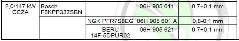

  • Well, always try to verify correct plug according engine code and year, 1.8 TSI needs different ones than 1.4 TSI etc. As example, for EA888 engines (1.8 and 2.0 TSI) were recommended and fitted
  • I believe this is enough to confirm, ETKA before latest updates ... VAG numbers and their versions from OEM suppliers. Again, it is always about information and right source. The same info is in works

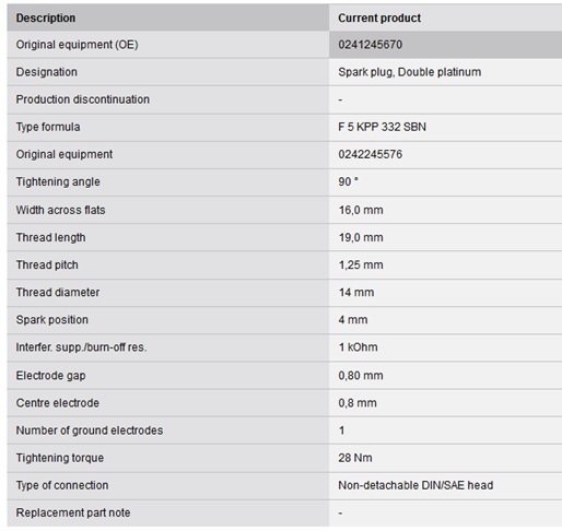

I've just checked on NGK website and checked the number. According to them, the plugs as quoted for the vrs is PFR7S8EG. The upgrade plug is IFR7X8G. These are for the 2.0 tfsi engine. Can anyone confirm?
Edited by meaty101
Having been in your shoes a few weeks ago I did my research, it's not worth upgrading from double platinum to iridium plugs.
The NGK part number you quote is correct. I went for Bosch as they are of a comparable quality but were about £7 cheaper than ECP who were the cheapest for NGK.
Those are the NGK aftermarket products they recommended using their checker, yes.  The genuine fitted product was double platinum either NGK or Bosch and suggested 60k mile interval IIRC.
The full iridium upgrade plug is probably overkill unless you want even higher service interval than original fitment.
The Iridium IX plug planehazza referenced is also commonly used, even though it doesn't appear on their product chart for your engine. They are a combination plug i.e. traditional ground electrode, iridium centre. They won't last a full 60k miles but most people tend to change well before. Depends on what service interval you want to use on the plugs really. They can usually be picked up under £30 for a set, a bit cheaper than the double platinum.
As said, genuine will give you a double platinum made by either NGK or Bosch and about £15 each per plug AFAIR.

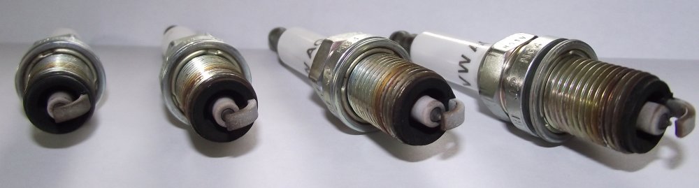

eg.
1.4tsi Twincharger, we know they burn out one spark plug, especially NGK , VW/Audi OEM ones.
Bottom are OEM @ 15,000 miles. Top DENSO from same engine @ 30,000 miles.

AFAIK Denso offer three plugs for the BWA / CCZA which mirror the three options being discussed here for NGK. Double platinum, part iridium or full iridium. So there are still the same choices within that brand.
The BKR7EIX is even on the cross compatability for the IK22. I've never had a problem using NGK or Bosch but in a specific application, like the twin charger engine that had certain "issues" I can see how some may have had a proven brand preference.  I just haven't any experience of encountering that situation.

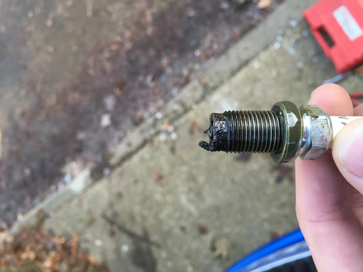

I'm presuming those plugs came out of a twin charge 1.4 tsi ? Imo, no matter what brand of plug you use, an engine should not burn out a spark plug like it has on the first plug on the bottom row and i would suggest that engine had a few serious issues. Looking at the colour of the top plugs it looks like it's running lean. However, all denso plugs look a different colour. I have also used NGK plugs for years and never had a plug burn out like that. I'm not sticking up for any one brand I'll buy plugs of any well known brand depending on value for money.

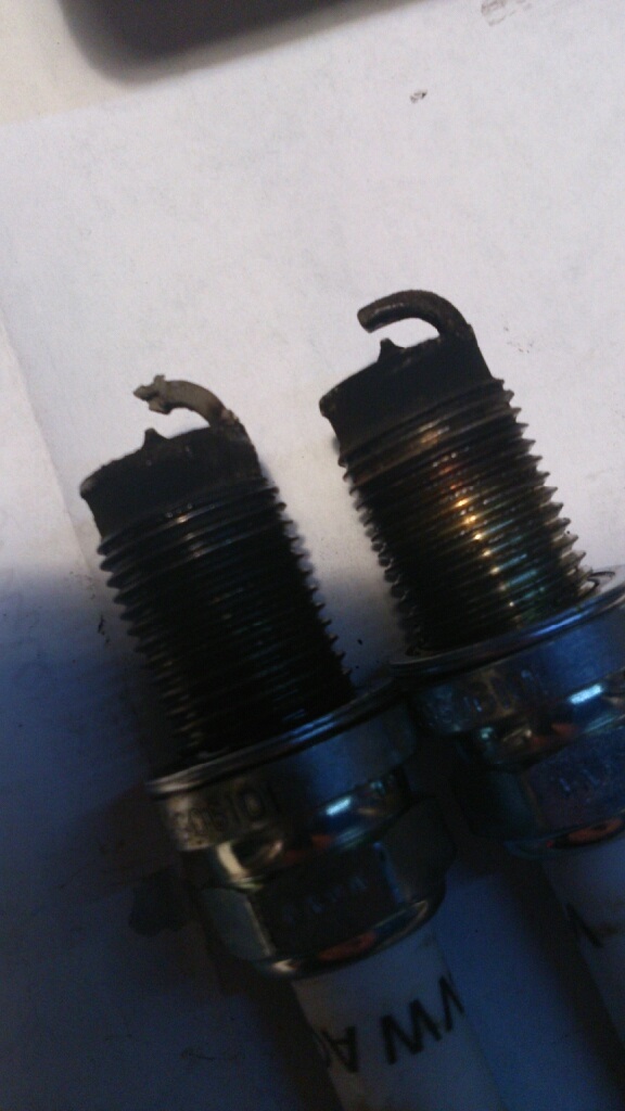

Pics,
Also of OEM plugs from 1.4TSI Twinchargers and taken from Threads / Posts that have been running since 2010 & are still running 7 years later.  Same happened from 2013 with the Upgraded engines, change of plug type and reduced gap as per TPI's.
As example, for EA888 engines (1.8 and 2.0 TSI) were recommended and fitted on assembly line plugs Bosch and NGK. According current ETKA they seem to left NGK and prefer Bosch now. Always wins the best volume price...
I am sure with that much oil in the cylinder as on photo above would give up any spark plug.

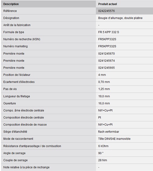

Yet, UK site of NGK say that IFR7X8G is one for upgrade, but German say it´s for Renault ... Also its resistance is higher, 5KOhm instead of 1KOhm
https://www.ngk.de/nc/en/product-finder/produktfinder/////IFR7X8G//
https://www.ngk.de/nc/en/product-finder/produktfinder/////PFR7S8EG//
In case I go for upgrade, I would go for LPG plug, which must survive higher temps. In this case PFR8S8EG
