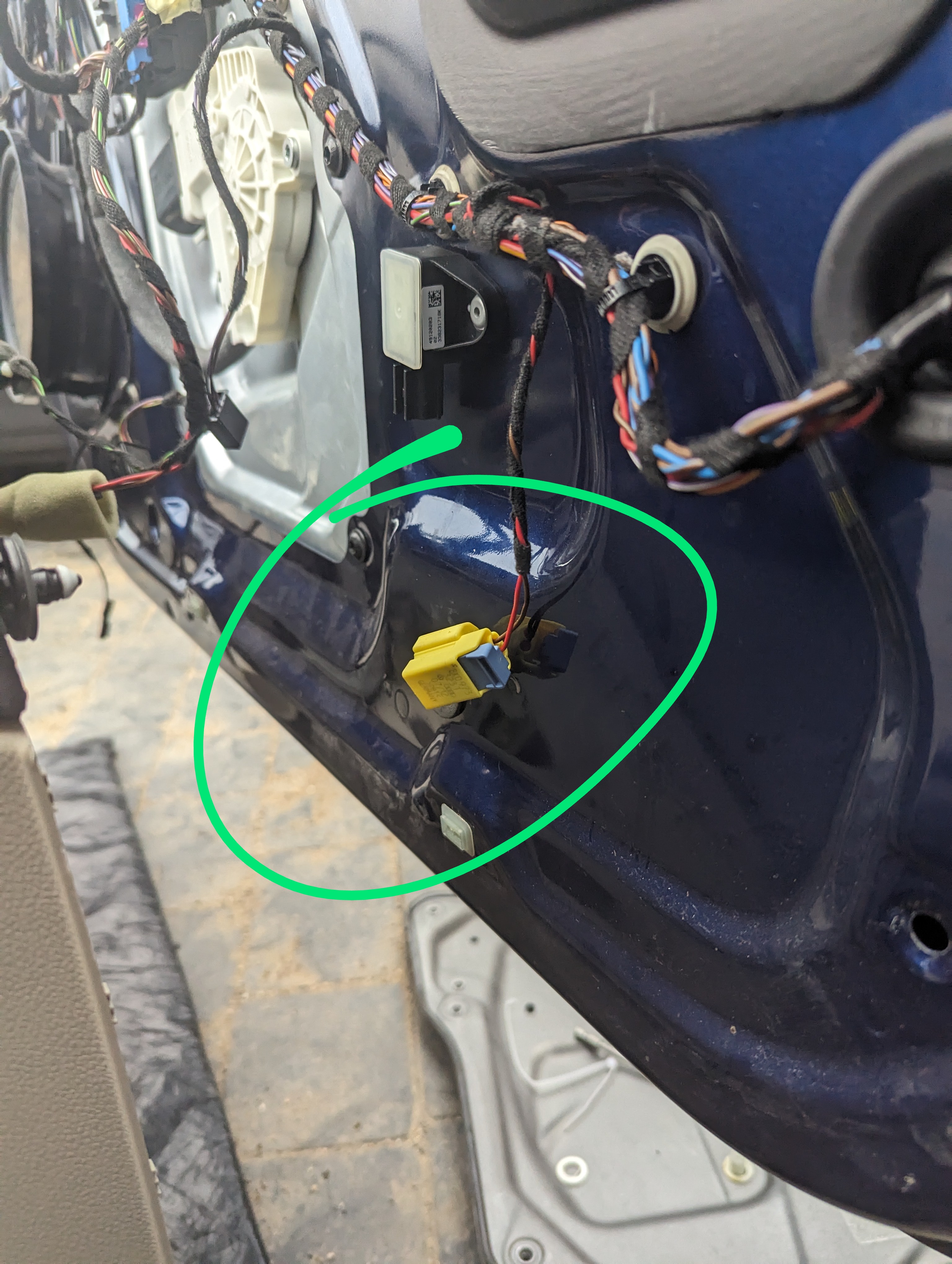

Can anyone tell me where I'm supposed to plug this connector in to please?
I thought it'd be obvious when I took the door card off as it could only go one place, but I can't find anywhere for it to go!
I've taped it up for now as I need to get the car back together. I'm guessing it's something to do with an airbag somewhere as the airbag light is on now.
The good news is that the electric window works 👍
Thanks for all the previous posts and especially the doc from @superbdreams! Couldn't have done it without all this info!
I've just been looking and noticed that the photo @IanJposted in this thread back in 2019 shows where it goes 👍
