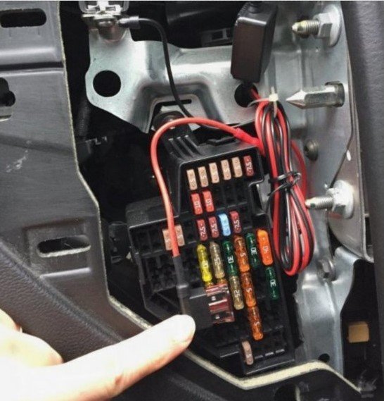

the rear wiper fuse is a switched live , can i take the power from there then earth to car body :blink:
Ok
1/ put twin fuse into rear washwipe on fuse box then earth other cable
Edited by craigandrew

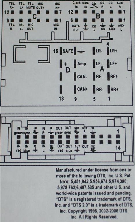

this is what ive found recently it should say on the top of your head unit witch conection is can hi and can low, pic belowe is just an example
Connection:
Orange - CAN High
Brown - CAN Low
Red - 12V
Black - GND
all i realy need to find out now is if the Red - 12V
ca be connected to the rear wash/wipe fuse as thats a switched live feed:wondering:
https://www.cars-equipment.com/www/en/shop/rear-view-cameras/oem-rvc-rear-view-highline-camera/

I took the Red/White within the cable loom where it goes down from the fuse board under the floor carpet in the driver side footwell. Look at my picture 6.

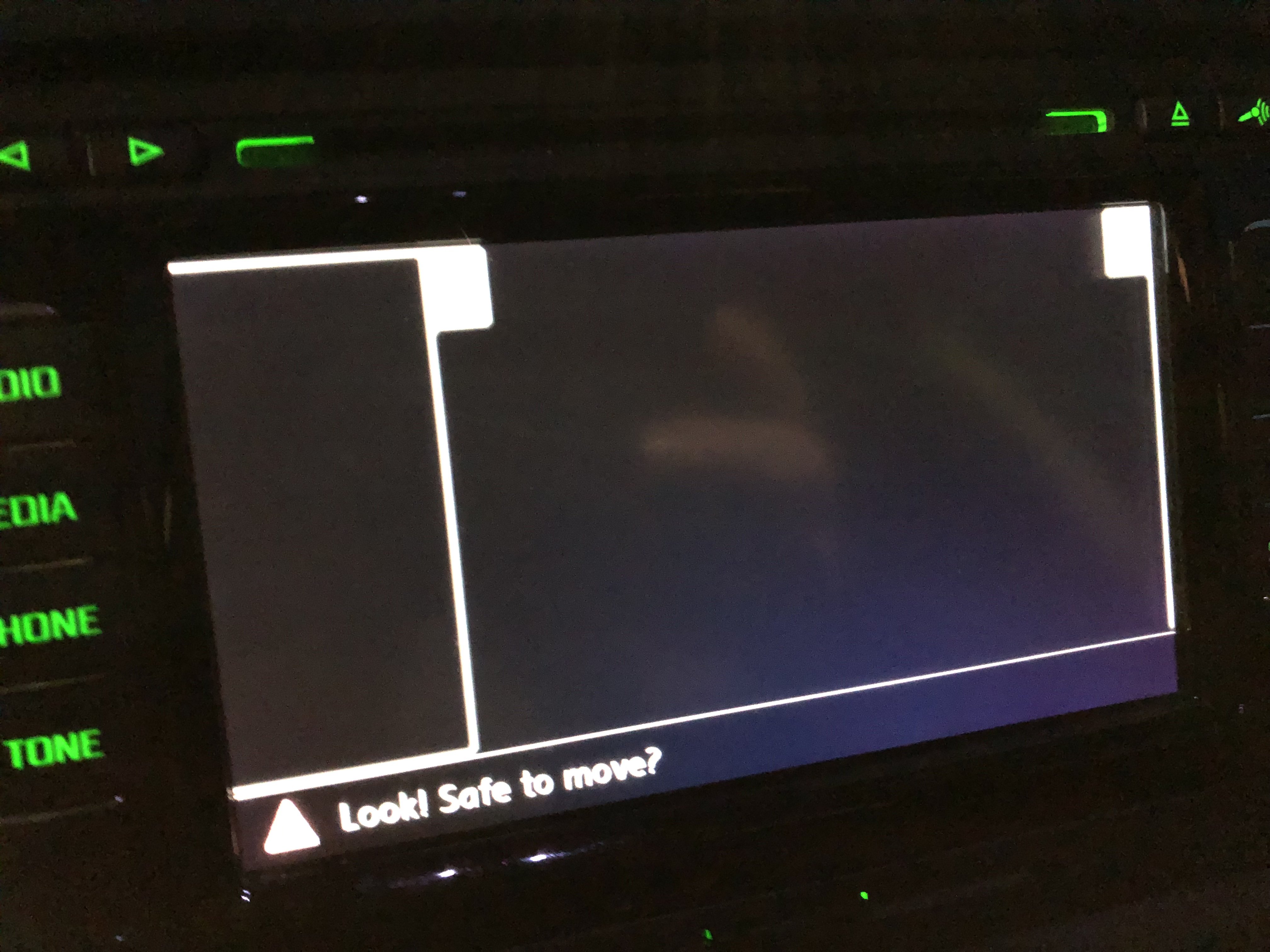

Tried to connect all wires as suggested, but nothing happened. I think that problem is in coding. If i tried to activate rvc with vcds, i have there only choise "rvc LOW installed" in navigation adaption. Did not find rvc HIGH anywhere.  After activating, appears on screen right bottom corner rvc image when shift is reverse. If i push on icon, then i see black screen only.
Any ideas?
I thought you have to unlock that in two different control units.
Which guide did you follow?
Check this thread:
This goes for high version, but I remeber when I coded my camera, I found isntructions somewhwre in net, searched something like B6 passat RVC retrofit VCDS coding.
Edited by linni
Check your connections again properly. When I put the Columbus back in after fitting I slightly dislodged the plug. Also check the controller in the back.
You have to go into Ctr 19, 6c, 10.
Have you got any DTCs?
Post an autoscan.
Edited by 26DIPP

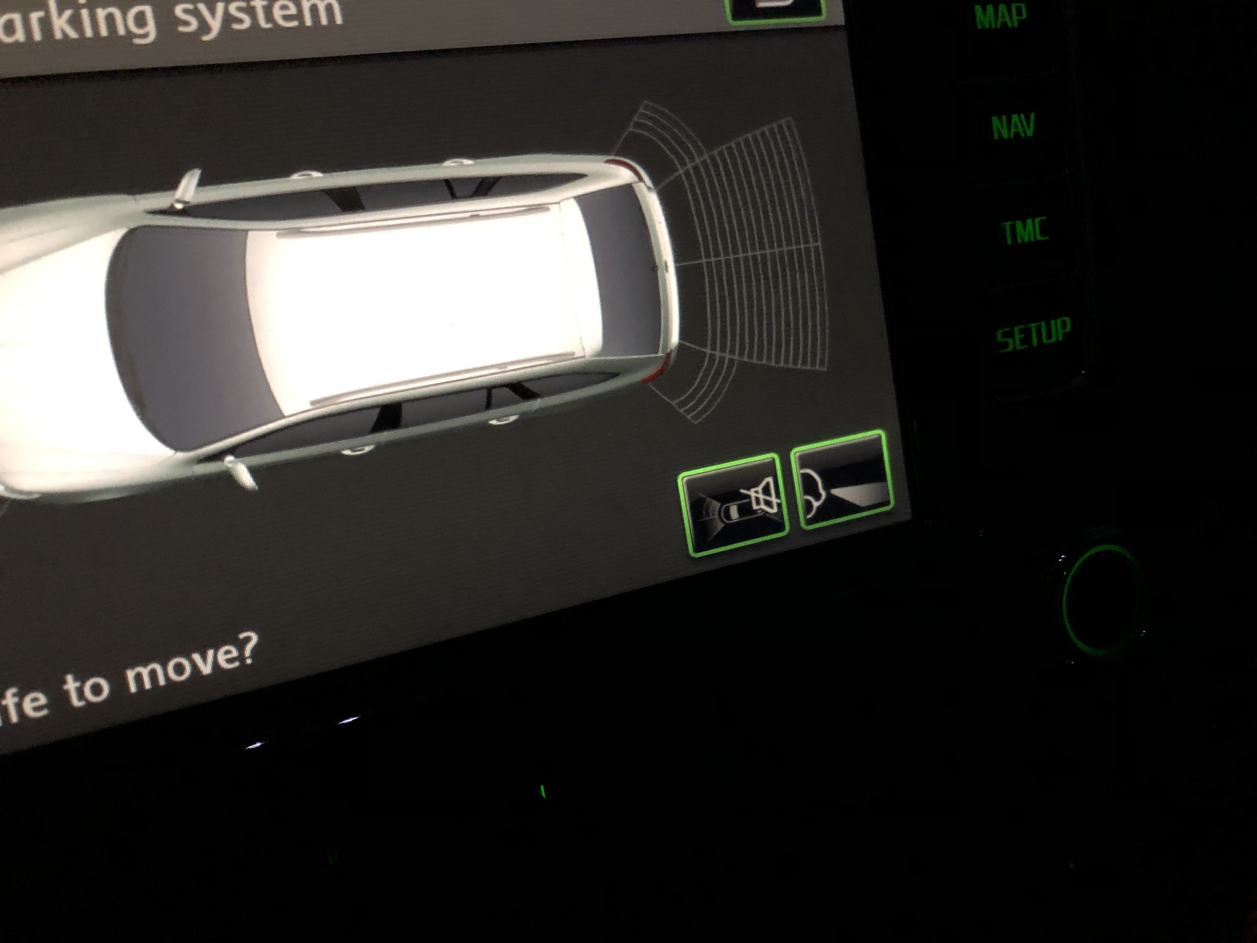

Thank you linni, it helps! Finally  I got RVC picture on my columbus screen. But of course, now i have new problem - I dont have guiding lines on screen. If I look on VCDS backcamera adaptions then I see steering angles but on screen not even green box. Camera what i have is 5ND 827 566 C and RVC unit is 7N0 907 441. Is it possible to activate these guidelines somewhere or i have wrong spare parts?
Edited by janar
typo
I thought I have wrong camera and bought camera 5N0827566AB, but problem still exist, i dont see guidelines :(
