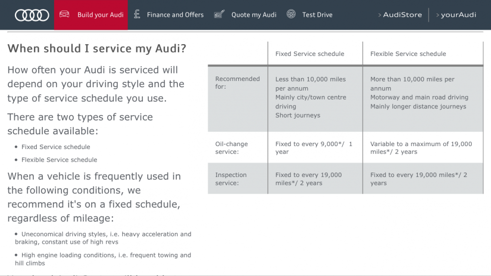

The Octy has been in for its 3rd Variable/Longlife Service this week; however, upon collecting it from the dealer, the inspection service was set to 18700 miles (30000 km) / 365 days, whereas the oil change service was set to 18700 miles / 730 days.
Initially I believed that this was an error by the dealer (as my 2 previous services and the 3 previous on the Leon had not been like this), but after challenging them, I was informed the following from the master tech and service manager:
'for vehicles MY2013 (sic MQB platform) onwards the first Longlife service is 18700 miles / 730 days; however, after the first service it reverts to 18700 miles / 365 days for inspection service and 18700 miles / 730 days for the oil change service.'
The reason for this was the fact that after the first 2 years, Skoda want to see the vehicle every year for a £45.00 inspection service.
This is is utterly ludicrous in my opinion and totally undermines the whole 'condition based maintenance' Longlife rationale - You pay more for the Longlife Service in the first place, and then have to pay extra for the inspection service out of phase, and have the inconvenience of having to still go to the dealer annually.
Furthermore, this differs from the rest of VAG. A screen shot from Audi.co.uk is below:
Come on Skoda - surely this is a backward step?
Fortunately I have VCDS and in 2 mins everything will be set properly (and in line with the remainder of VAG).
