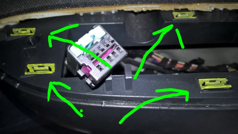

Oh blimey! Now I can't work out how to get the switch module out of the trim (unless you need 6 hands to do it!) Any ideas?
Yes, there's 6 clip points, you can check the photos below to figure out the mechism. I haven't removed them before, I think since you have to unclip them all, maybe at the same time, to prevent them clipping back, so special tools could be needed.

Yes, NOSDylan is correct. You need to unclip the pins. This can turn out to be quite tricky. In My case i tried to wiggle each out by damaging the plastic holding them in a little. By pushing them out and trying to pull each clip more and more upwards. You can also put some thin plastic between them that would prevent the pins from going back.
After this i was still able to secure the switch tightly.
PS. If i remember correctly, then the switch itself was secured in trim panel with pins. And same pins are also keeping switch together. So you might need to do this for both.
Remember to test the switch first, before assembling it all back :D.
You can also test the pins by shorting the metal circuit, where the metal switch is laid on. This will operate the switch function.
PS.2. In my case i had more difficult problem because the switch had not continuous connection. So i had to do some soldering, but in most cases this should not be necessary. If you are interested in more details, i can try to explain to you more.

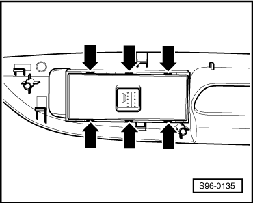

Even though I'd looked at the Workshop Manuals link, Removing and installing the switch for the power window lifter I hadn't realised it's the whole handle and switch that comes out, which makes things a bit easier as you can then take it indoors.
I just worked round it gently with a screwdriver, you can hear it click as the clips free up.
