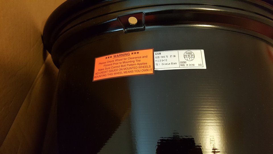

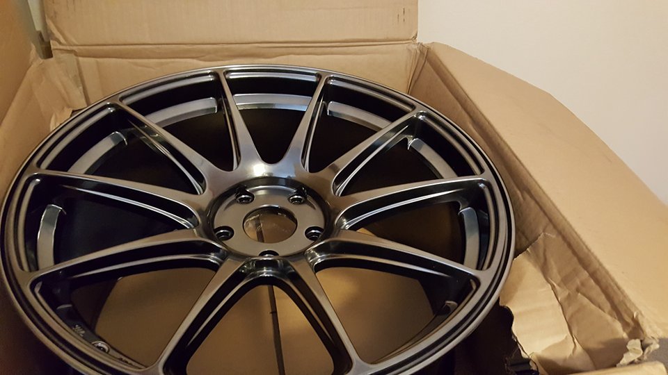

    This is my new Skoda Superb MKII 2008 169 HP .I  recently  bought a new pair of alloys on 19 but I'm afraid that they will not fit . The alloys are from XXR with dimensions : 19*9.75 offset 38 Chromium Black what do you think they will fit ?? Now on car I have 225*40*18 width 7.5 offset 46 . Yhank you .
Congratulations on your purchase! I'm afraid it's very unlikely that those wheels will fit.
16 hours ago, AlexP83 said:
That doesn't show that they will fit, it shows you how much closer to the suspension and how much further out they will poke. Looking at those figures it's a definite no.
To put in in perspective I run 7 1/2 x 18 et 51 with 15mm spacers on the front and 20mm spacers on the rear. This is just about the maximum you can go before you start to foul bodywork.
Now you only need wider flaring wheel arches to cover the wheel tyre combo.
