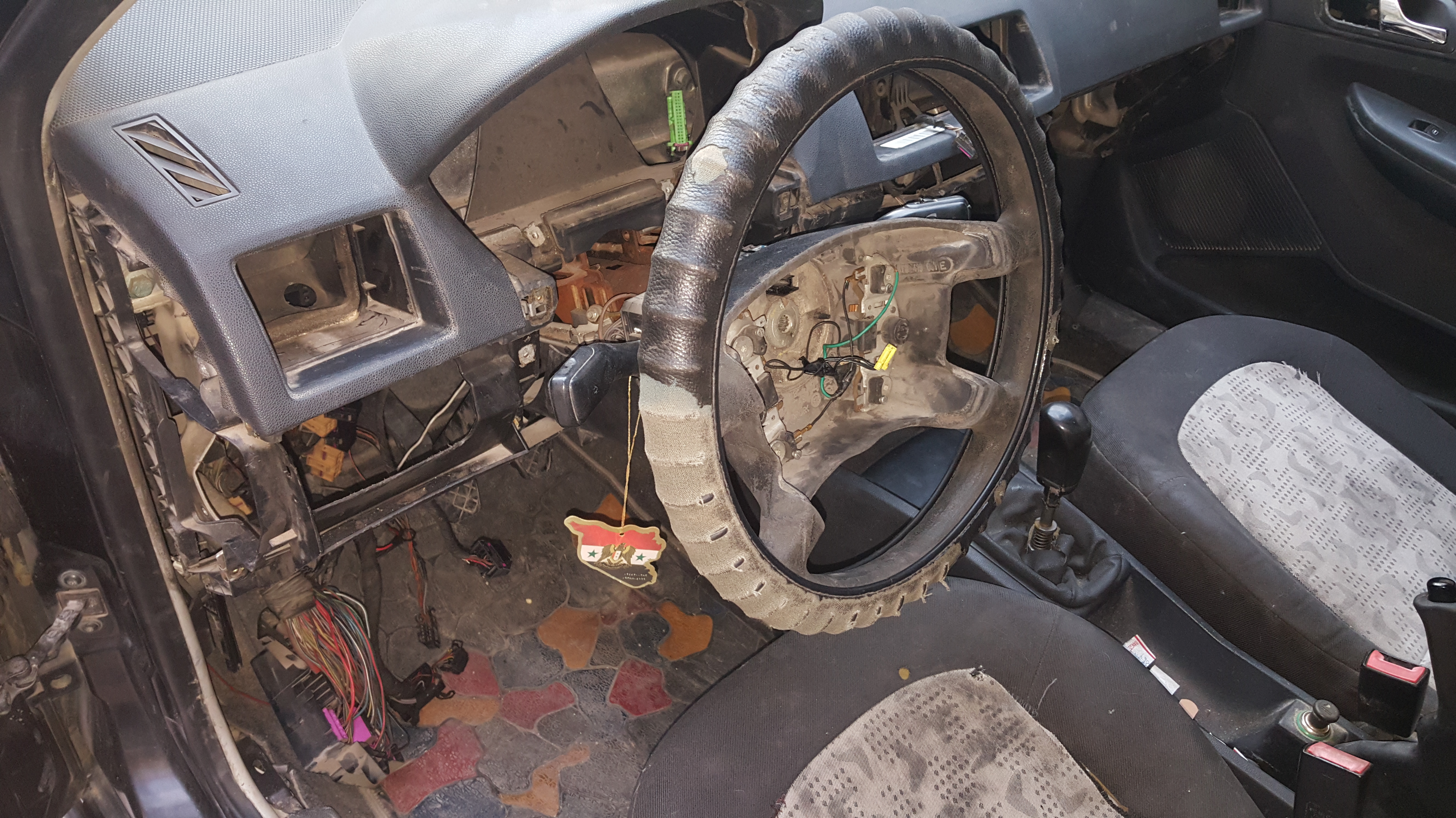

It finally began after a month :giggle::giggle:
While working on the car's electricity.

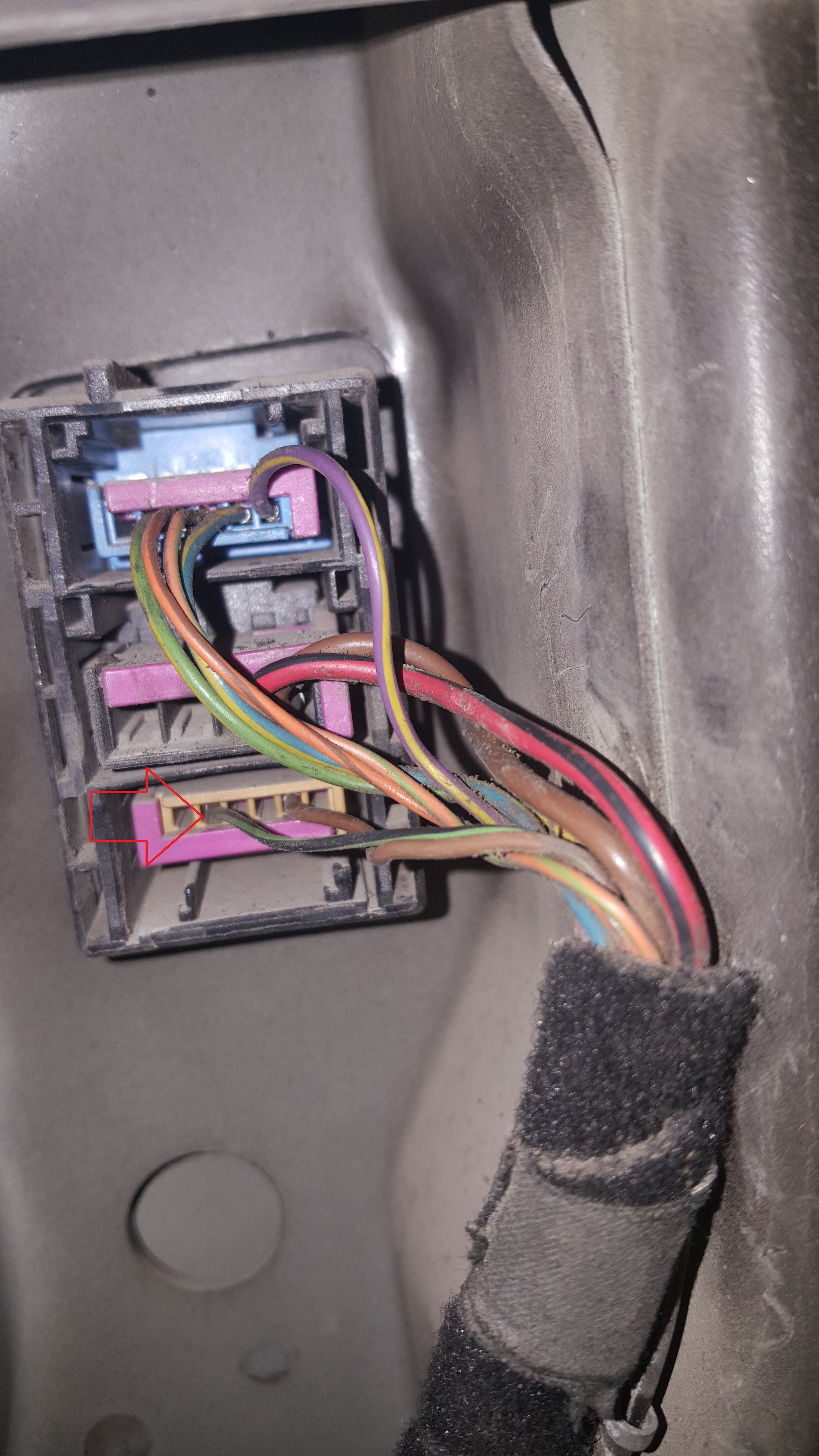

Check the wires of the right rear door.
The wires were all fine, but I found this wire black and green, and I did not know why this wire was used.
I checked the diagram but found nothing.
Why is this wire used?
:blink:
If you look at item 10 on the central locking diagram there is a black and green wire that goes to the right rear door central locking. It changes to brown and yellow at some point before it goes into the door.
