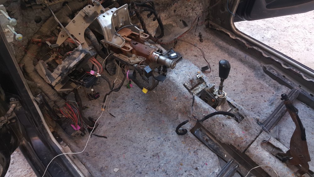

This is the shape of the car right now
I have checked the rear lights and wiper glass
Tomorrow I will clean it and return some of the pieces

What is the story with the car? Did it need all this work doing when you got it?
This car is for my father.
When he bought it he did not check it well, the car in general was good but the electrical connections were very bad.
Because car prices and car parts are very high, when the car needs maintenance, maintenance workers do not repair them well because the pieces are low and expensive.
So most of our cars are not in good condition, because we are not allowed to import cars since 2012.:)

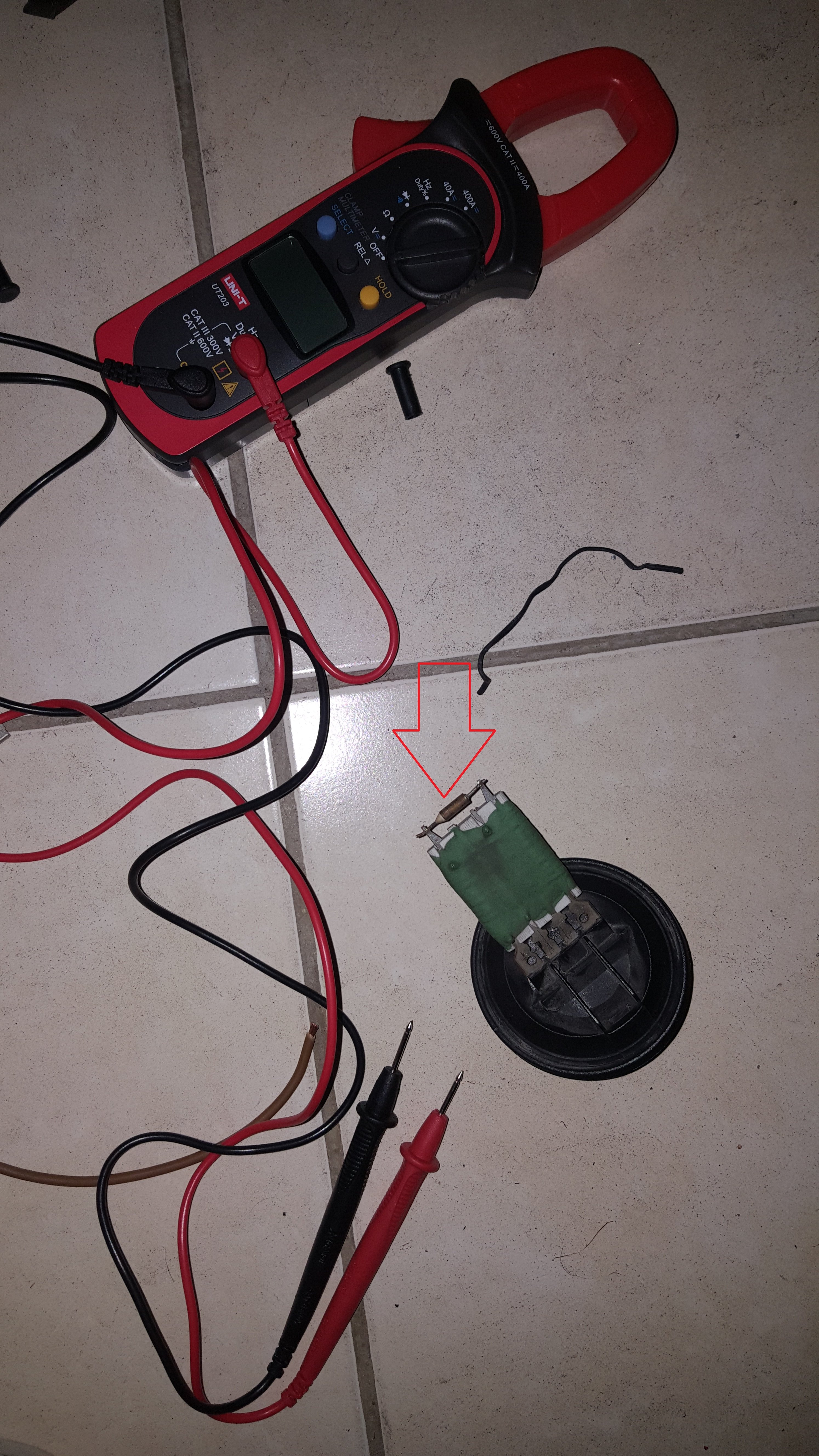

On 31. juli 2017 at 21:23, hussien95 said:
after testing,The problem was overheating fuse.
So I've welded the wire on the fuse,So the overheating protection has been disrupted.:giggle::giggle:

I bought some thermo fuses and screw one on in a Fiat  Ducato, ant it i still working. Success! So I bought more with different temperatures from China.. Very cheap....  The coupe filter must be clean - if nom it can burn more easy...

I have searched for a fuse, but I also did not find him:laugh:
Now it works well until I find the resistance I will change.

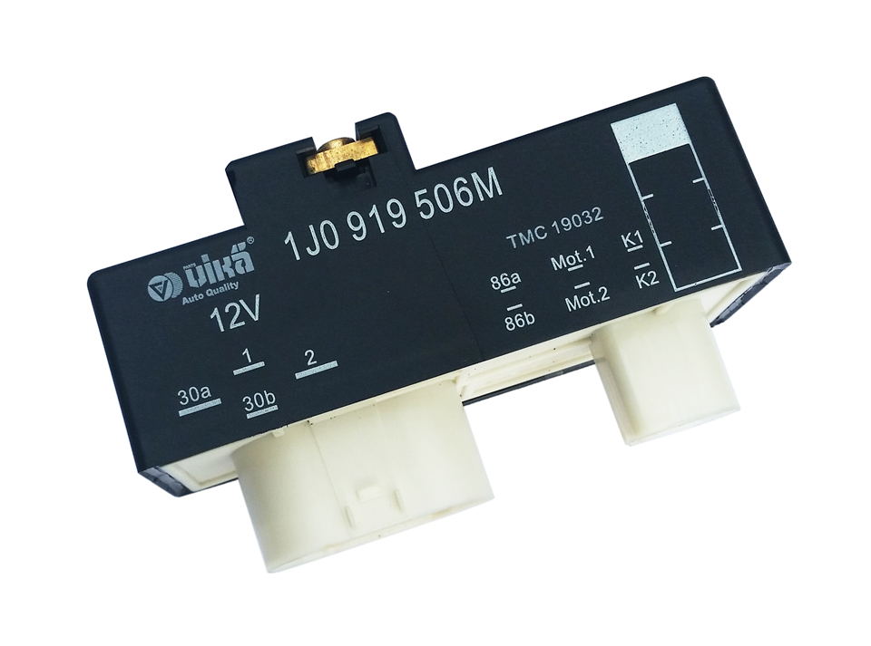

I did not find (Radiator fan control unit) in my car,(Missing pieces):sweat:
and As usual I searched for it but did not find it :@
The problem now is that I checked the diagram and found these wires connected between (AC control unit and Radiator fan control unit).
Lack of Radiator fan control unit prevents the work of air conditioner?
Yes. The inputs labelled K1 and K2 switch the fans on at low or high speed according to the refrigerant pressure (measured by G65 pressure sensor).  I guess if that control is absent, the A/C control module will only be able to control the pressure by reducing the duty-cycle of the compressor down to a very low ratio, providing little or no cabin air cooling.
