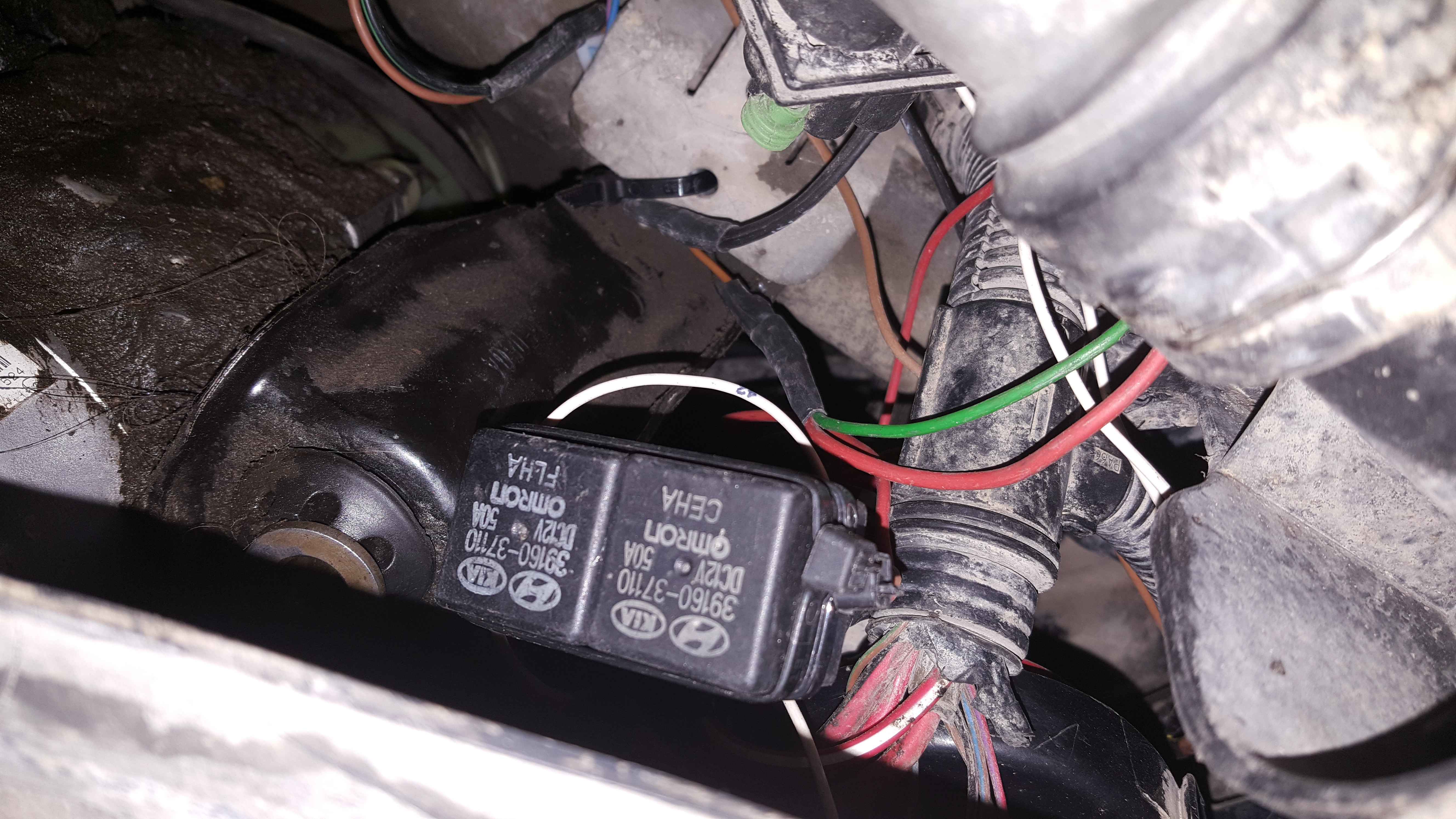

So put a 50A relays for low and high fan stage.
and for the AC system,i put 2 diodes (1n4007) from j301 to relays and its wock just fine.:wub::wub:

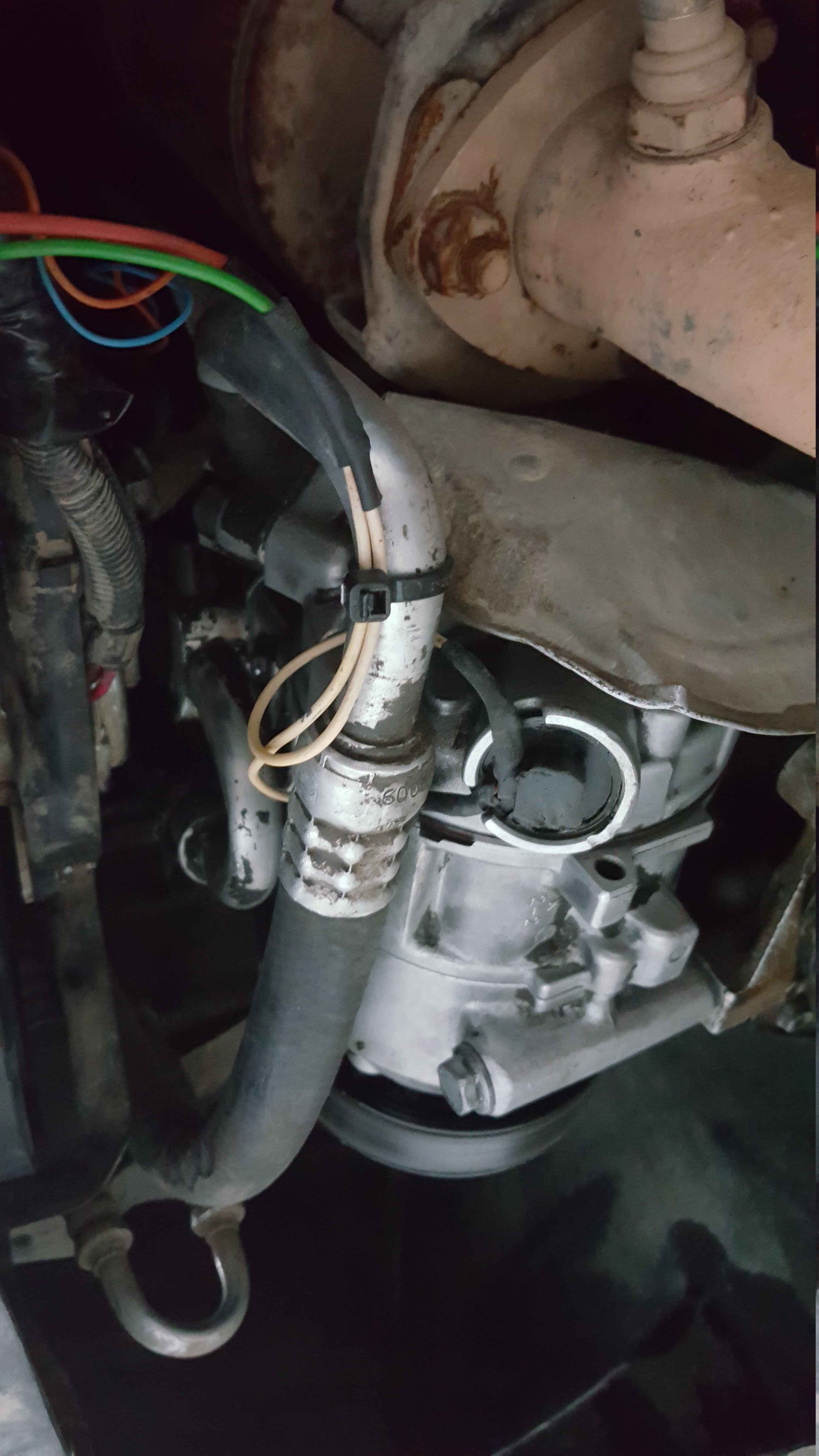

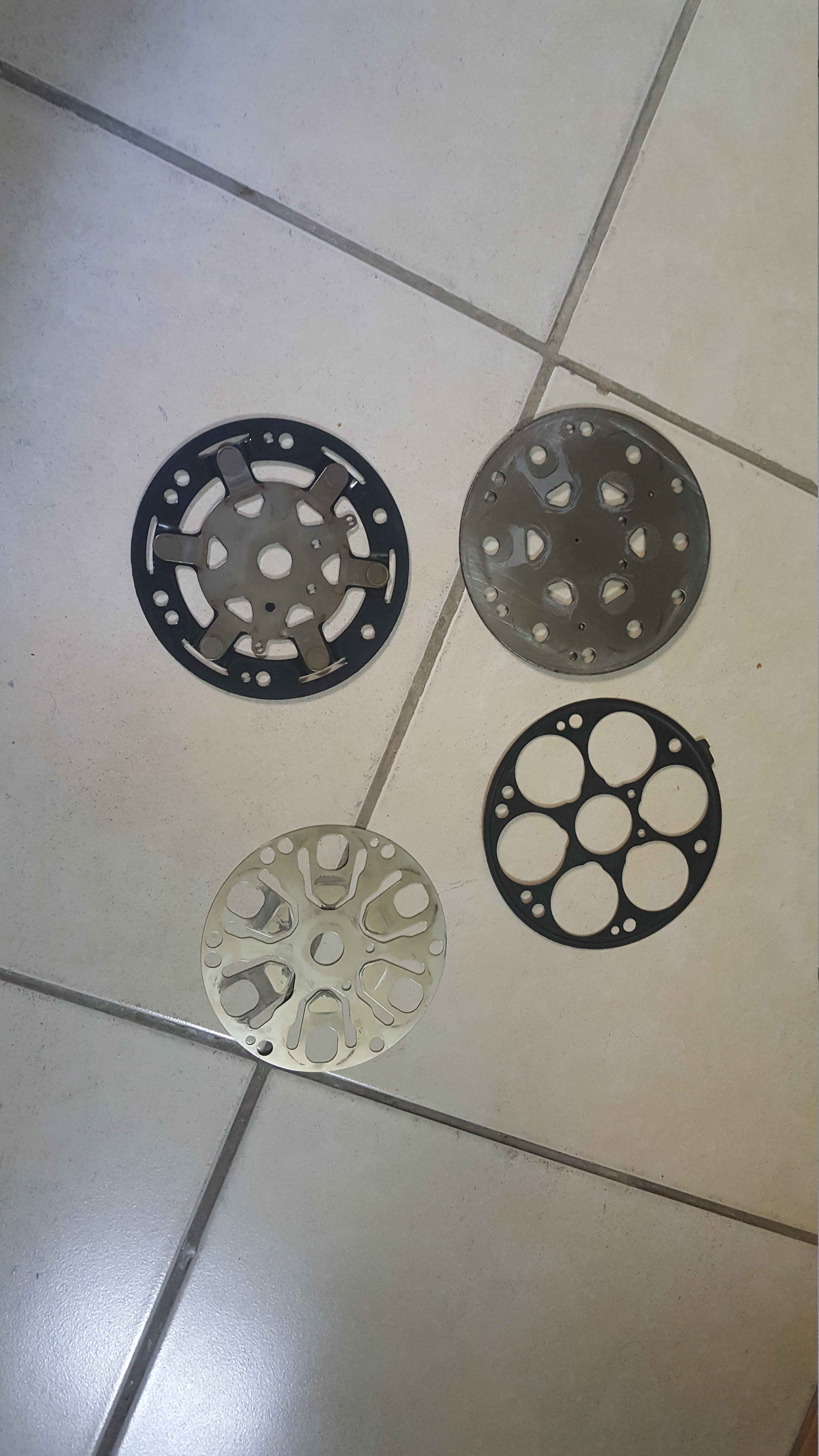

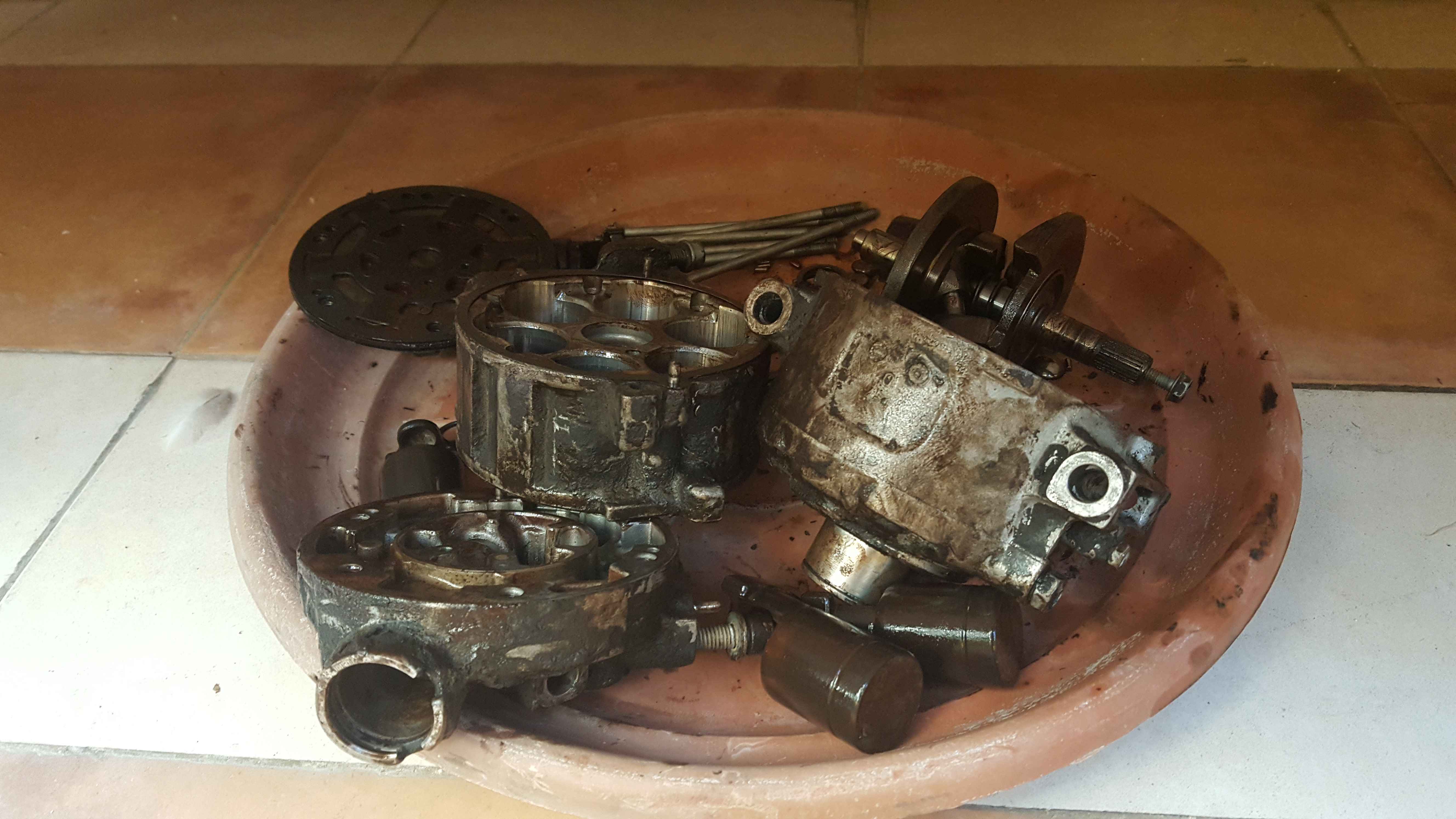

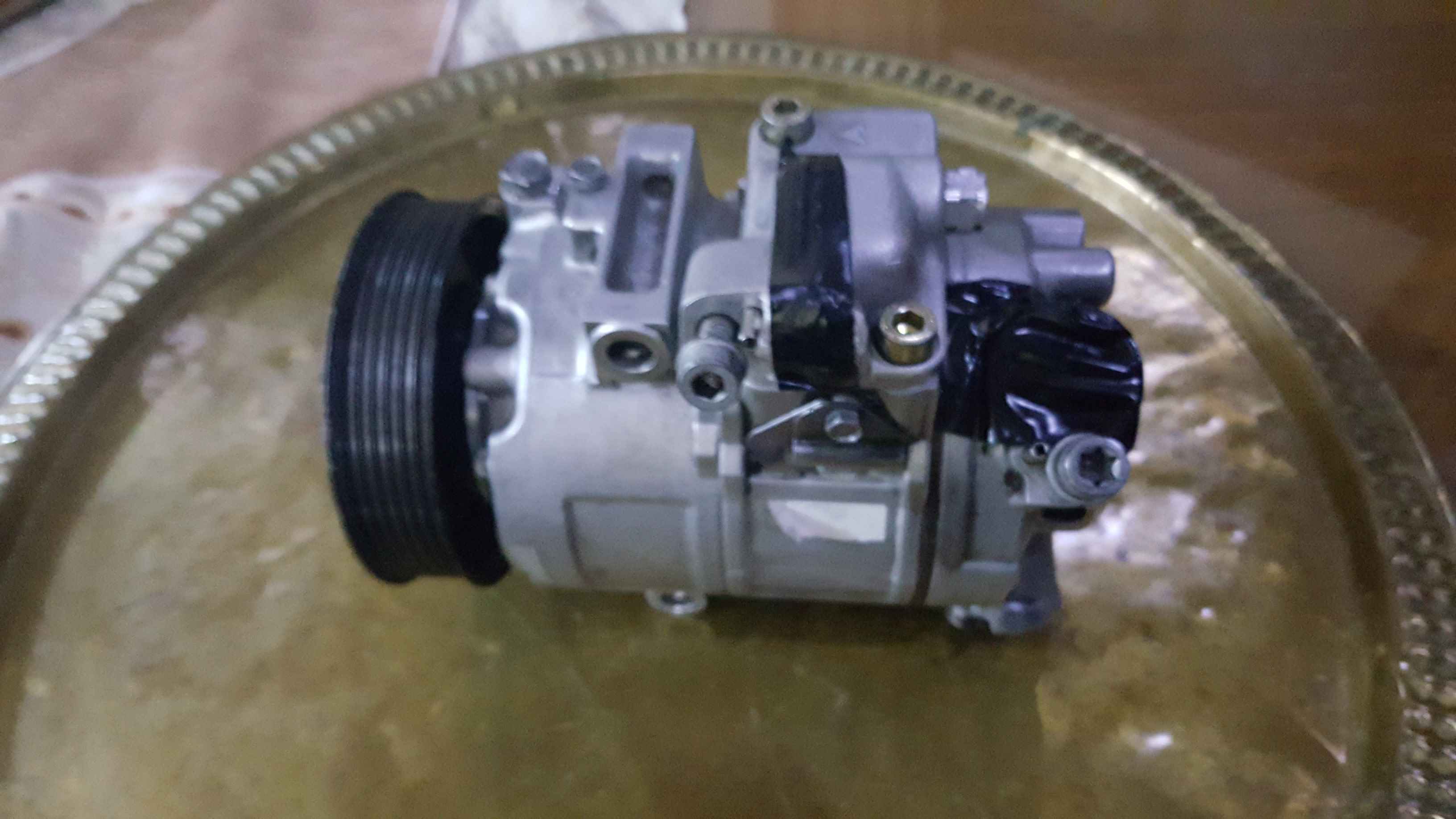

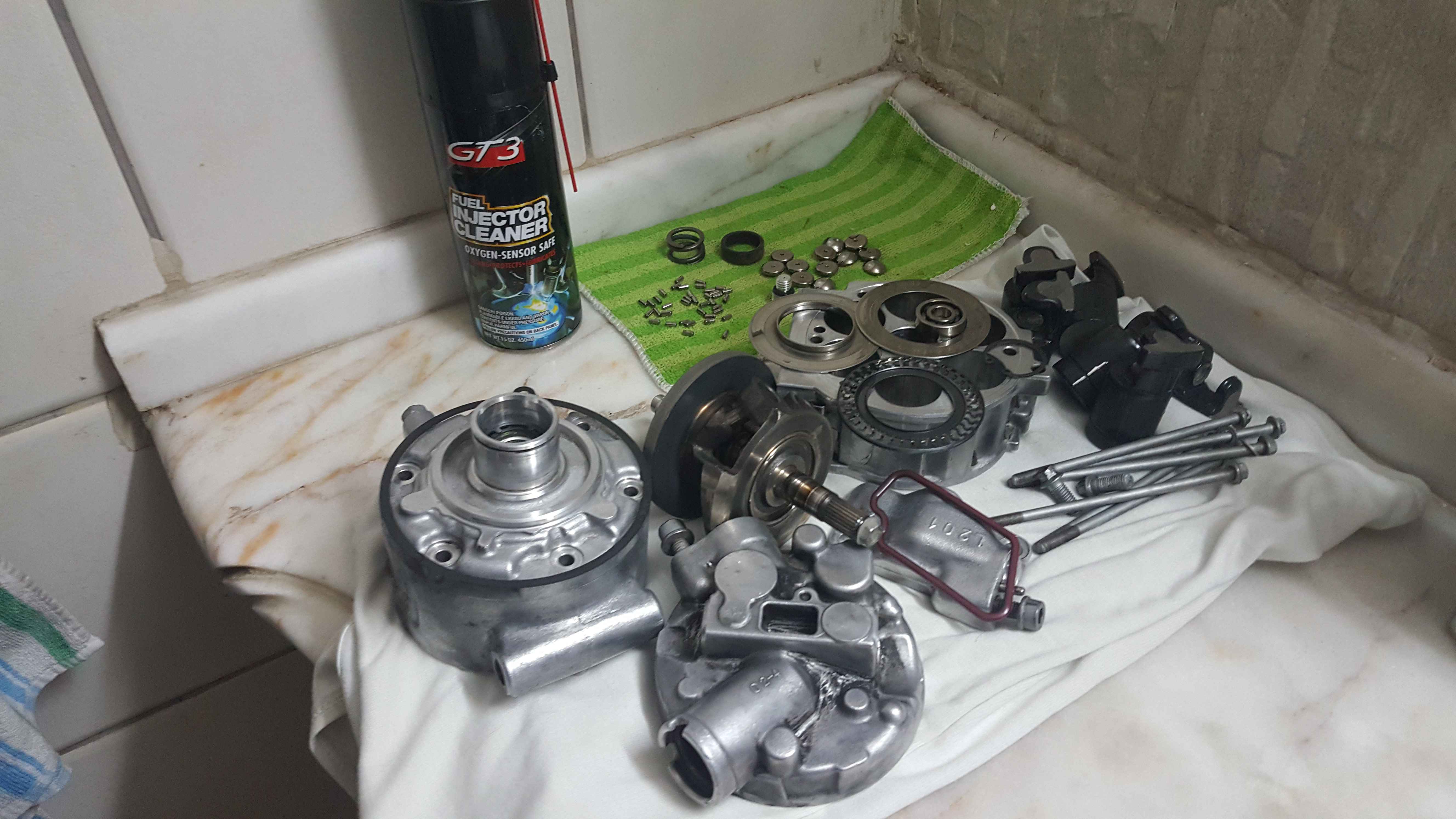

even the AC compressor was in a bad condition and there was no oil in it,So I've fixed it and cleaned it and it came back as new:laugh::laugh:

I did not rebuild the compressor, but just cleaned and installed it.
I could not figure out the correct amount of compressor oil, because the compressor model number does not exist.
So I cleaned the whole air conditioner circuit with compressed air to remove the remaining oil.
Then I searched for the correct amount of oil and found that there are different types of compressor air conditioner and each compressor needs a quantity different from the other and the difference is big, there is compressor need 80 cm of oil and another compressor needs 140 cm of oil.
So I added the number between these two numbers (110 cm).
I hope that this will not adversely affect the work of the air conditioning system, but I have no other choice.:laugh:

When I unplugged the compressor I could not find oil in it.
