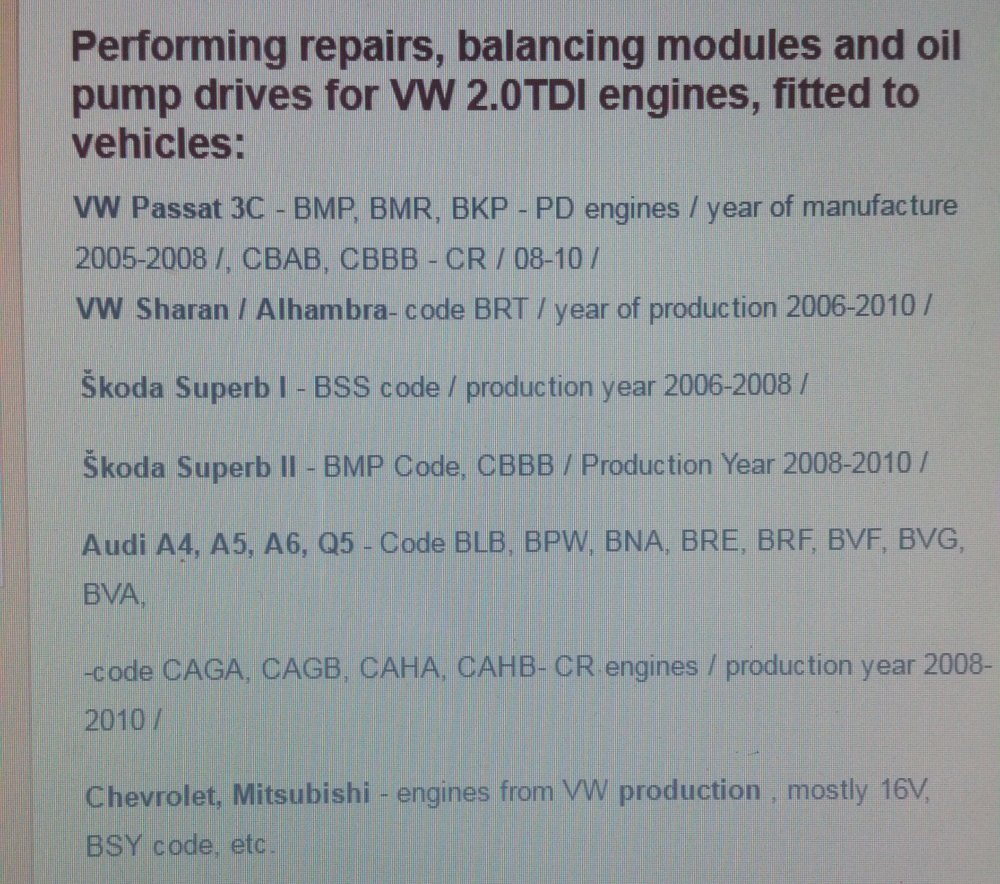

from what I can gather the CFGB engine does have the hex key but must be more reliable than the BMP, CBBB engines listed on this attachment,
The CFGB does not have a HEX drive and the CR engines in general, do not have the old PD Oil pump issues.

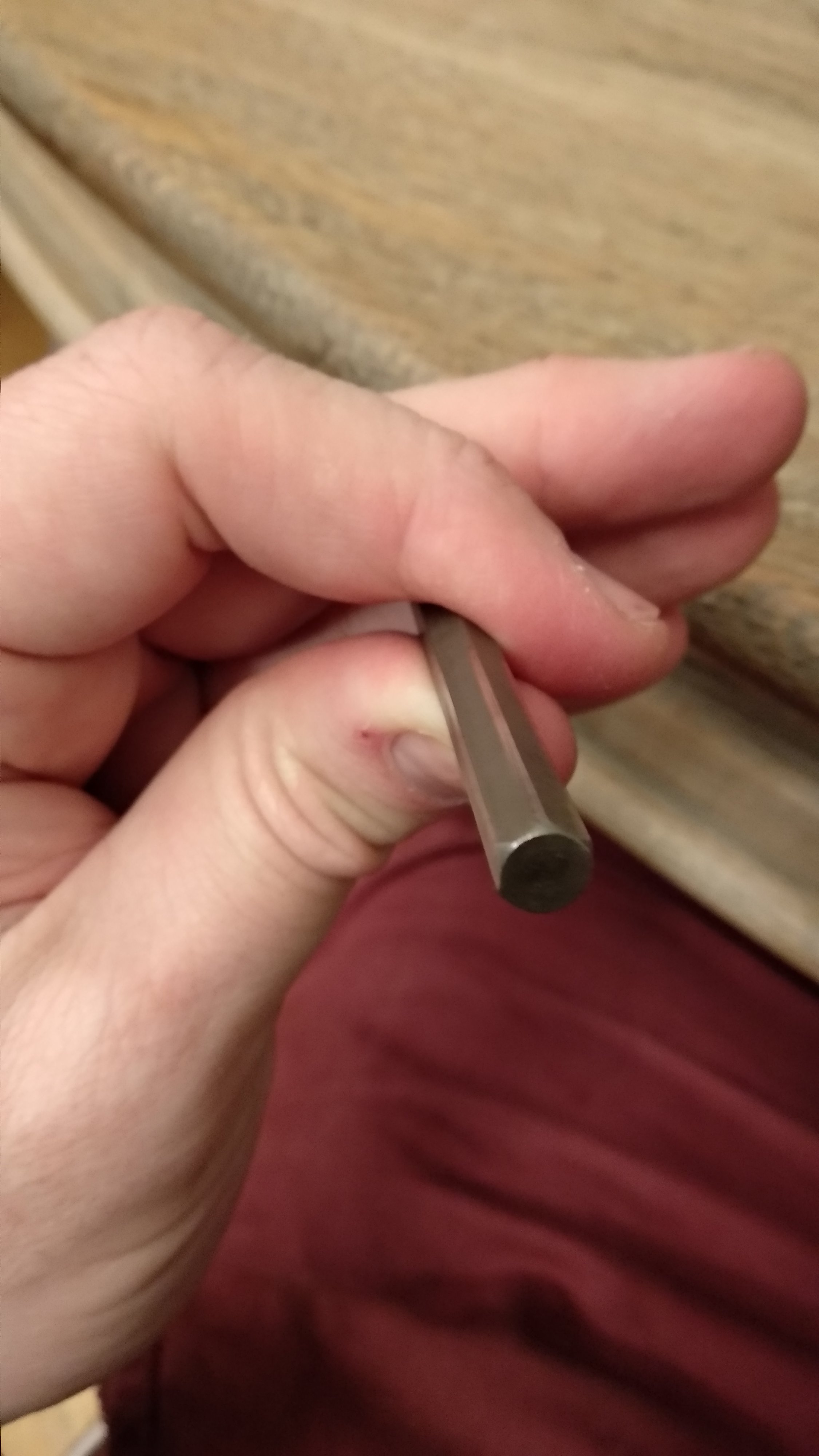

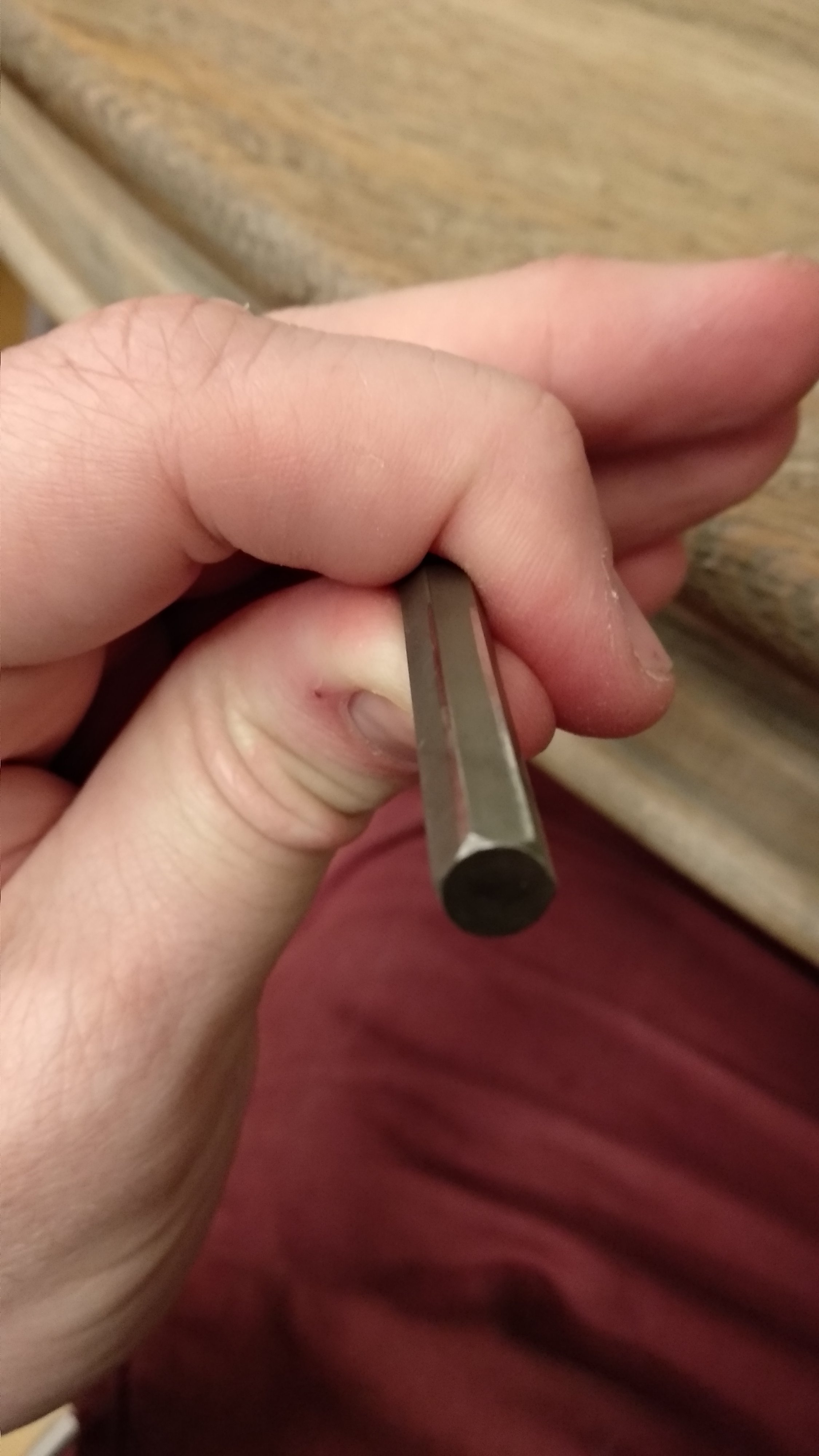

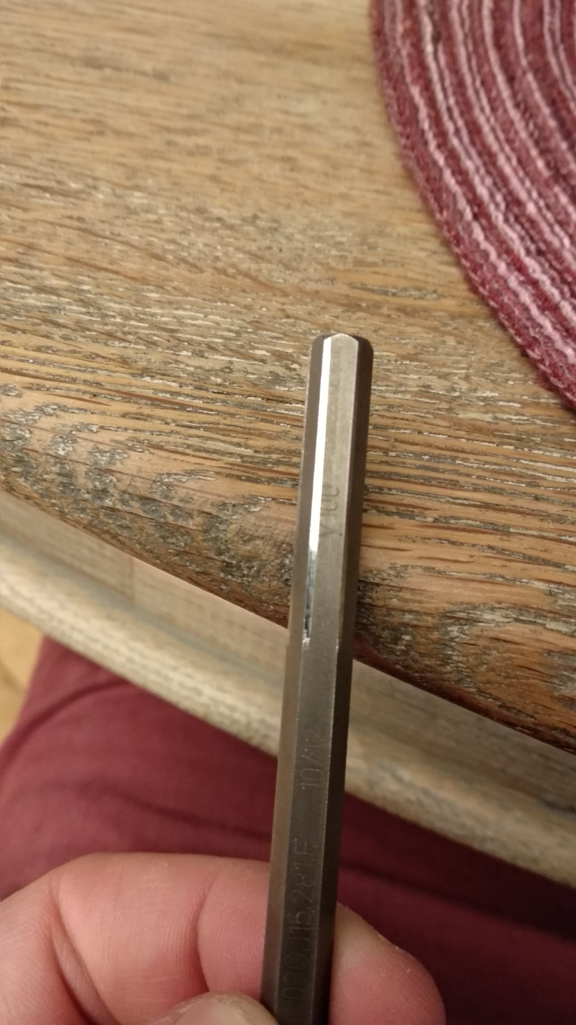

So I was cleaning out my toolbox and look what I found. The worn hex key. Small amount of play and you can see the Burr on one side of the key. I know this was ages ago but when. I found it I knew people needed to see it
