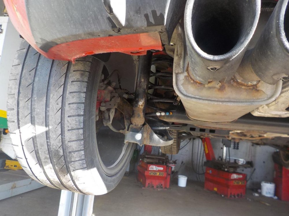

Hi. I wonder if you guys can help, my sons CTHE fabia vrs 2013 has been for its MOT today, passed with one advisory, corroded rear scilencer. Is this a case of replacing the back box or can this be fixed? Ie welded up? If it's a replacement job, what's his options? Many thanks.

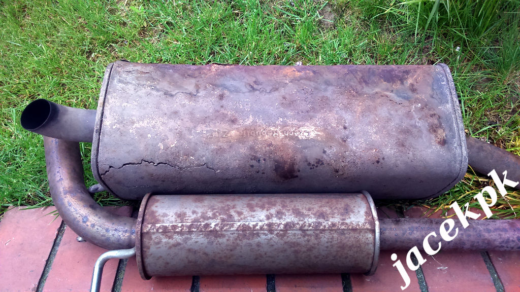

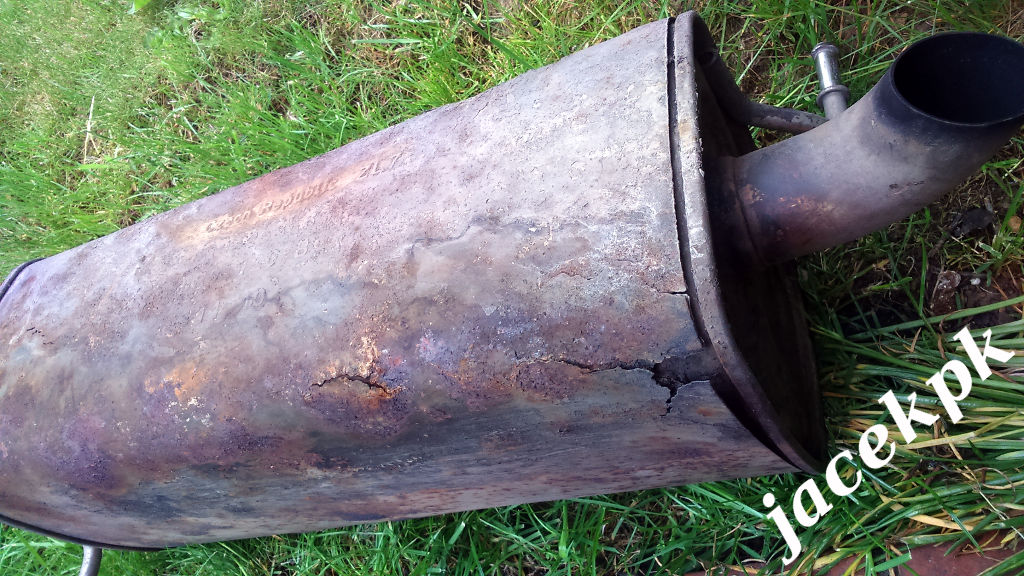

Quality of silencers in Fabia mk2 are just tragical. A year ago I replaced both silencers in my Fabia mk2 from 02.2011. My car had in those time about 68k km mileage. Availability of original exhaust isn't good. I checked availability direct in czech internet shops. Finally I bought whole exhaust from VW Polo 6R 1.2 TSI. My old silencers wad made in Czech Republic, but new exhaust which I bought was made in Spain. I'm curious if the new exhaust will be better than factory czech silencers.
Below photos that show corrosion level of my factory exhaust after 68k km mileage. Drama.
