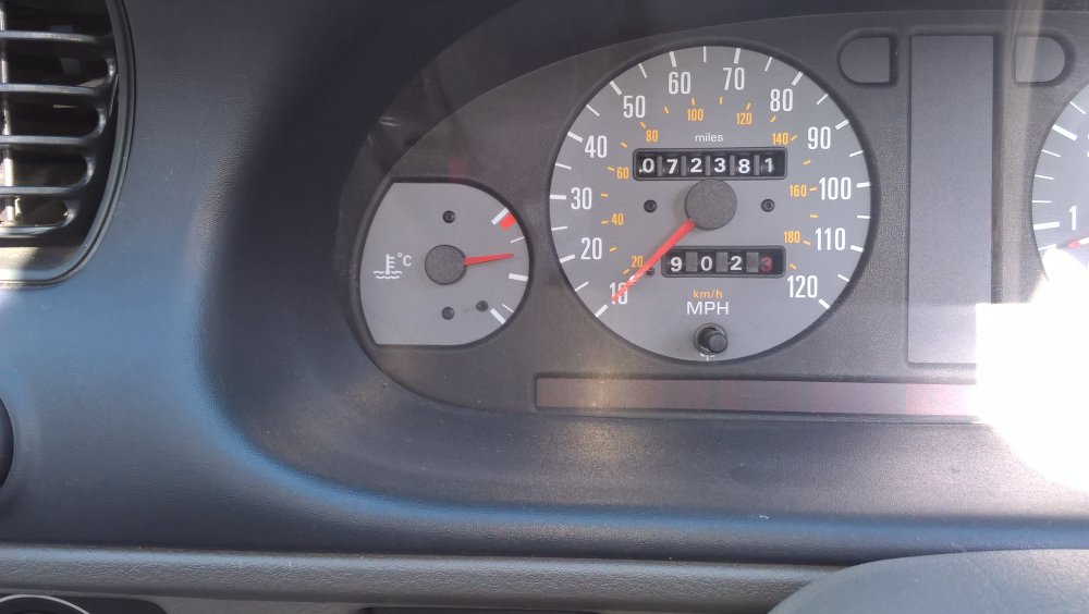

Here is a picture to illustrate my description. Where the temp needle is on this picture, this is when the fan kicks in. I took this today after a drive, the temperature rose at the end of my journey when I hit some rush hour traffic, also its boiling today, about 28 degrees Celsius B). Im asking because I'm not sure if it should get this hot or if this is normal :blush I've recently had a coolant flush and change, and the levels are spot on, no leaks.

Hi, I don't know if its normal but I have the same when its hot outside and during rush hour ( stop and go driving ) but anyway I never had some problems
Thanks nimbus, I'm just curious because I've not noticed it on other cars I've driven (3 cars), cheers.
Fio
Your description matches the normal operation for Felicia on a hot day. The radiator fan kicks in at about 100° C. I find annoying that the fan stops too early (95° C) with a new fan thermo-contact (FACET 7.5017 rated 87-82° C liie the book says). By the way, the rating of the thermo-contact is referring to the coolant temperature in the area where it is mounted (bottom of the radiator in Felicia's case) not the gauge temperature. I will change my thermo-contact with one with a lower rating (82--77° C) so that the fan will kick in at 95° C and will stop at 90° C.
