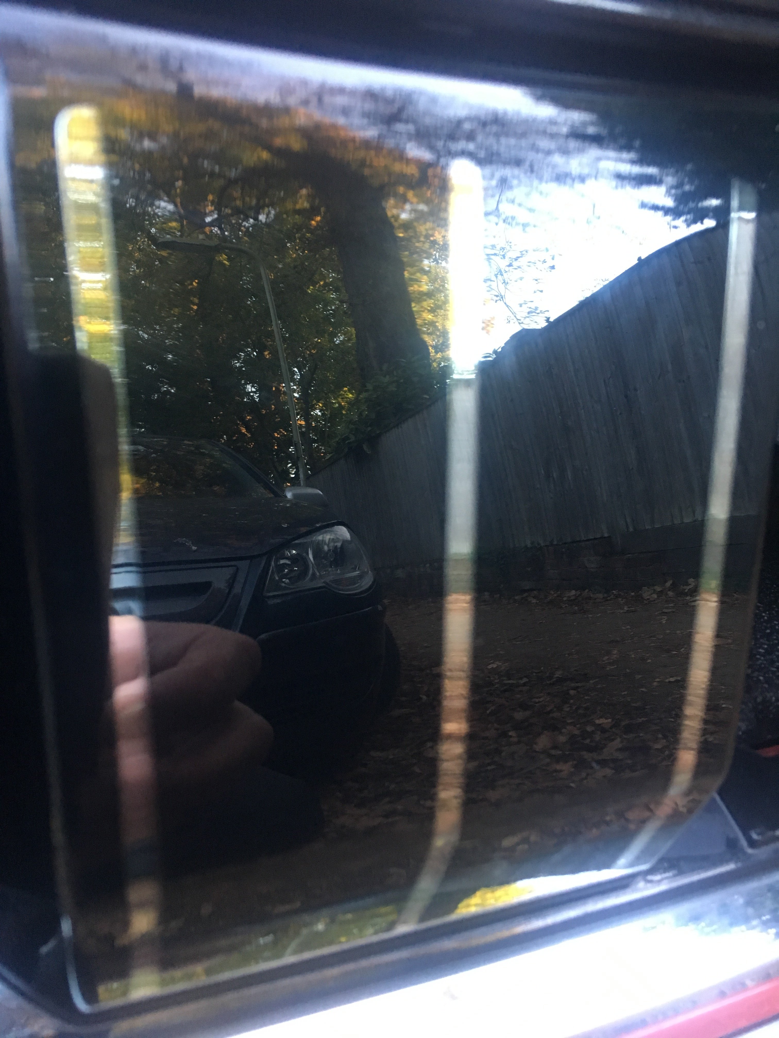

Thanks hwr- I tried that but unfortunately their reply is that the codes thrown up in their diagnostics say otherwise and that Skoda won’t accept it as a warranty i.e. manufacturing defect as soon as they see the codes. They pointed out tiny scratches on the radar cover (see photo - yes, quite, you’d need a microscope!) which a stone might have caused.... So obviously I need the car and coughed up. Hmmmm. Next step Customer Services. Will tell you if I get any joy..
This is a radar cover, I removed mine and found it to be a standard piece of trim with 4 clips holding it in place.  I’m not sure how a a few tiny  scratches could throw the radar off which is behind this plastic cover?
we’re booked into Skoda at the start of May, so will feed back once we have an answer
The cover is made of a specific material with a specific uniform density throughout and the radar is calibrated to pass through the cover and take that into consideration.
if the cover is damaged or marked this can cause the radar waves to be deflected at a different angle and cause problems with picking up objects or calibration.
all depends on the size of any damage.
remove the cover and test if it works just fine without it
