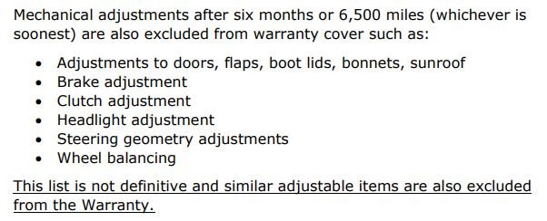

All useful and interesting information, but Skoda UK's targets don't detract from the terms and conditions of their new car warranty.
If they spell out in black and white that the front assist radar and/or it's calibration isn't covered then fair enough. If not, and there is no obvious damage to the equipment then it's a genuine warranty claim.
Generally speaking in the warranty guidelines. Calibrations arent covered under warranty due to it being an adjustment. (6 months 6000 miles) Only times it can be is if there is a manufacturers issue. Eg tpi, technical bullitin etc.  The way they see it is, something has caused it to go out of callibration. Some dealers may do it as a goodwill gesture.  When putting claims down anything over age and mileage gets rejected instantly, when putting the code for calibration (adjustment)
