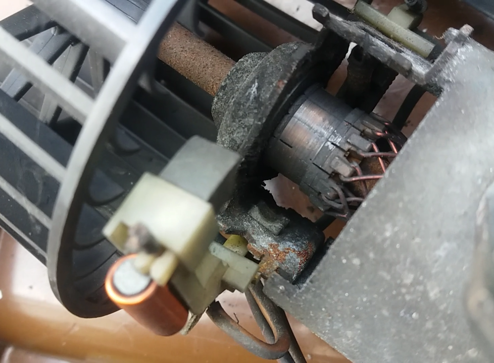

I've had two air blowers stop working solely due to a motor brush spring breaking because of corrosion. I found locking forceps to be a great help to grip the new spring and hook it into place. The spring from a retractable ballpoint pen might work as a replacement, although I haven't tried it.
Cleaning the commutator & recutting the gaps would help immensley!
